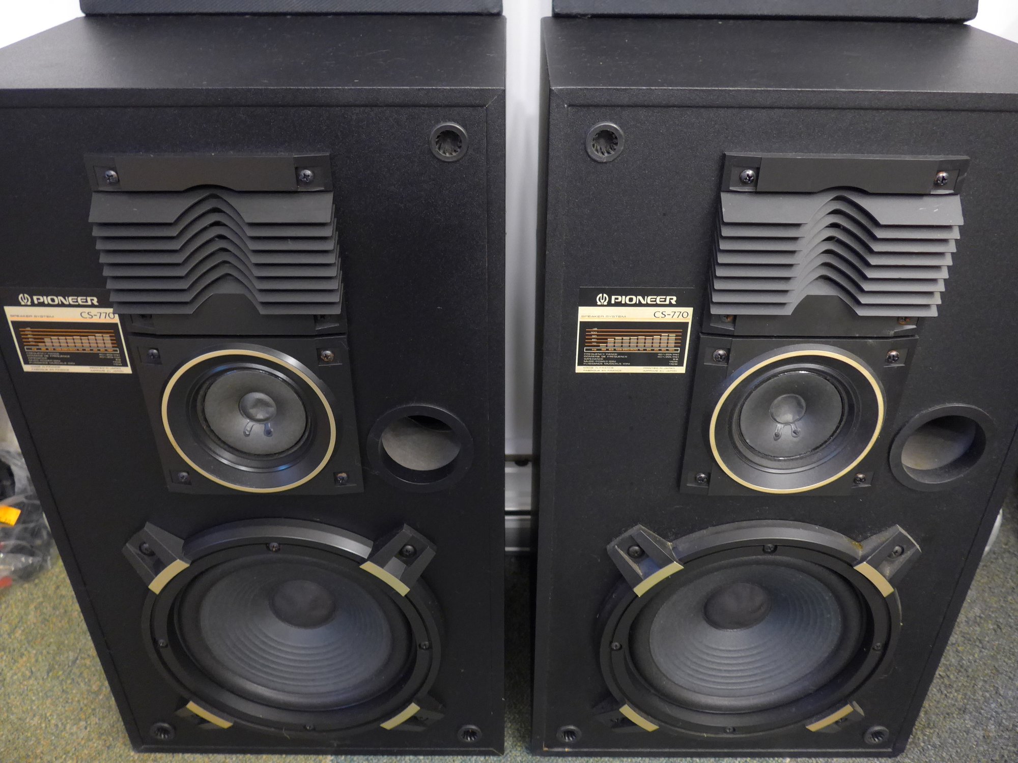

Hy I would like to replace capacitors in my Pioneer CS-770 speakers.
There is a pair of 2,7uf 63v in each box...
Should I use electrolityc or film?
Any brand recommendations?
Speakers are 3 way, 6ohm 110w...

film is always the better choice soundwiseHy I would like to replace capacitors in my Pioneer CS-770 speakers.
the only exception would be when you need big values and it quickly becomes very expensive and bulky with film. then back to back electros are the smart choice plus they double in voltage rating that way
in your case 2.2uF paralleled with 0.47uF will be just fine.
voltage rating wise anything above 50V is fine in my book, does not hurt to go higher, only costs more but what is money for audiophiles...

IF it works, leave as is; or best case replace with fresh ones, same type, there is not much to "improve" there.
If really interested, proper would be to get and mount there a 4 way crossover board sourced from, say, Parts Express or similar.
Pioneer literature mentions
Crossover frequency |
which of course is bollocks, you can´t do that with just 2 capacitors, to boot same value
In my view, waste of time and money, but hey, you decide.

Thank you all. I'm just looking to refresh it a bit. I'm not looking into modifying really.
I like the overall sound, it's just that sometimes I get kind of... I don't know how to describe the sound... like one would shake the aluminum foil... the sound is not really loud and it's just audible for a split second, just on some songs that sound a bit brighter...
I can't tell if it's coming from the tweeter or mid range...
I'm not looking to put any work in these, except of replacing capacitors... I can live with that until I buy something new...

I would not worry about the brand, but do make sure you order bipolar (non polar) electrolytic capacitors and not ordinary polarised ones.
RS do a 3.3 uF Nichicon bipolar capacitor, which is probably good enough for your purposes when its tolerance range of +/- 20% is taken into account.

It may be that you have a high frequency resonance problem rather than a capacitor problem.
It just may be mechanical in origin.
I would ensure that all the drivers are screwed up tight and there is nothing loose inside the enclosure. Even the internal wiring can cause vibration induced noise if touching the walls of the enclosure. For good measure, I would examine the integrity of the leaves of the acoustic lenses on the tweeters.
This might be classed as clutching at straws, but it can do no harm checking.
