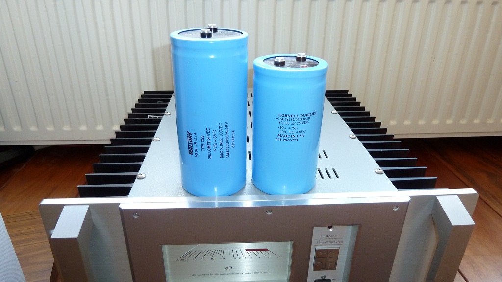

With todays capacitortechniques (better dielectrum I suppose) one can buy in the same size (length and diameter) and Voltage a much higher capacitance rating.
I now operate a pair of Threshold SA/1 from 1984 that had a capacitorbank with 4 Mallory's 80 Volt with 29,000 uF capacitance each.
They measure 6 3/4 Inch and have a diameter of 3 Inch.
The substitude I opted for was a CDE 75 Volts (Railvoltage is 60 Volt) 82,000 uF same diameter (so it fits in the clamps) and even a lower height of 5 5/6 Inch.
At the picture you can see that the Mallory is bigger and produced in last week of 1983. The CDE was produced in week 22 in 1998. So I gained less the nine years her ;-). With a variac I reformed the capacitors before I really start to use them in the amps.
I know that the bridges in the amp will be taxed more but are there any other disadvantages or advantages you can come up with.

You have a capacity of 58,000uF per rail voltage (or is it 2 different capacitor banks, one for each channel?) which should be OK.
Replacing the 29,000 with 82,000 will incur a very large inrush current which can blow your fuses unless your amps have a soft start circuit built in. In addition at this level of capacitance there probably is some resistor for discharging the caps when you switch off the amp. The wattage of this resistor must be increased otherwise it would not last much. Naturally, you must also change the bridge to a high current FAST bridge.
Moreover your choice of reducing the voltage is wrong. Electrolytic capacitors exhibit leakage, and the smaller the voltage rating - the higher the leakage. This effectively will reduce clarity in the bass performance.
My choice would be to replace the caps with slightly bigger ones i.e 40,000 max. (at 100V or more if space allows) and bypass them (i.e connected parallel to them) with 470uf film capacitors to reduce higher frequency interference. Low ESR is mandatory. To the best of my knowledge best smoothing capacitors for audio are ELNA SILMIC II. I would also change the bridge to a fast one of higher amperage.
If you are not sure how to select your bridge, stick at 30,000uF and simply increase capacitor's voltage and bypass them with film capacitors as stated above

The leakage difference is trivial compared to the 100-120Hz charge wave from the transformer and that it is swamped by the parallel drain resistor loss, and by the effects of circuit impedance.
The recommendation for 470uF film capacitor seems strange, it would be extremely large and expensive. Perhaps you meant 4.7uF or 0.47uF, if not both?

Be aware that using modern caps, with lower ESR, your inrush current goes up. In an "ideal", "good" design, it wouldn't matter, but historically equipment has been built based on the specs of the components available at the time... and still is, today we don't design based on the idea that capacitors are always a dead short, but the ideal one would be... based upon what your ideal is.
