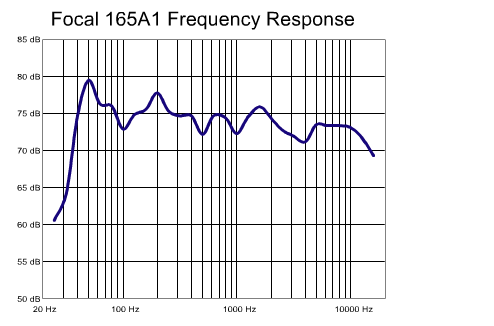

I had a tweeter from my Focal Access set go partially out about a week ago. Its now not as loud as the other and at certain frequencies it has a slight buzz to it. I've always been happy with the setup I had, and how everything balanced out. BUT today, I just replaced my ancient kenwood deck for an Alpine CDA-9887 because I got a heck of a price for it. And now that I have a deck that brings out all the sound, I can definately tell why people say that the aluminum tweeters are harsh 😛. Now im debating on either buying a different set of tweeters, or ditching my current speakers entirely and going with a new type.
So first question, is there any set of decently priced tweeters that would work well with the Focals? Without having to mess with a lot of tuning?
Or if I went with a different set of speakers, which would you recommend for $250-$300 and under?

You can change only the focal tweeter. Look to alpine silk dome tweeter 😉 SPS1005 ???
I have the alu focal tweeter in my car and I am very happy with it, sound clean and good. When I saw the crossover I redesigned it 2nd order at 4kHz (4" woofer with 6dB crossover and an impedance compensation). The problem is, if you look in the manual of the focal set of speaker, a huge hump between 2kHz and 8kHz.
Hope this Helps.
Hope this Helps.
Try to find if you have the TN-45 or TN-47 tweeter (model?). The response in frequency of the last one seems much better, as an example. Originals xovers also have +/-3dBs settings what is good.
You can also test new x-overs (...lot of work for you).😉
