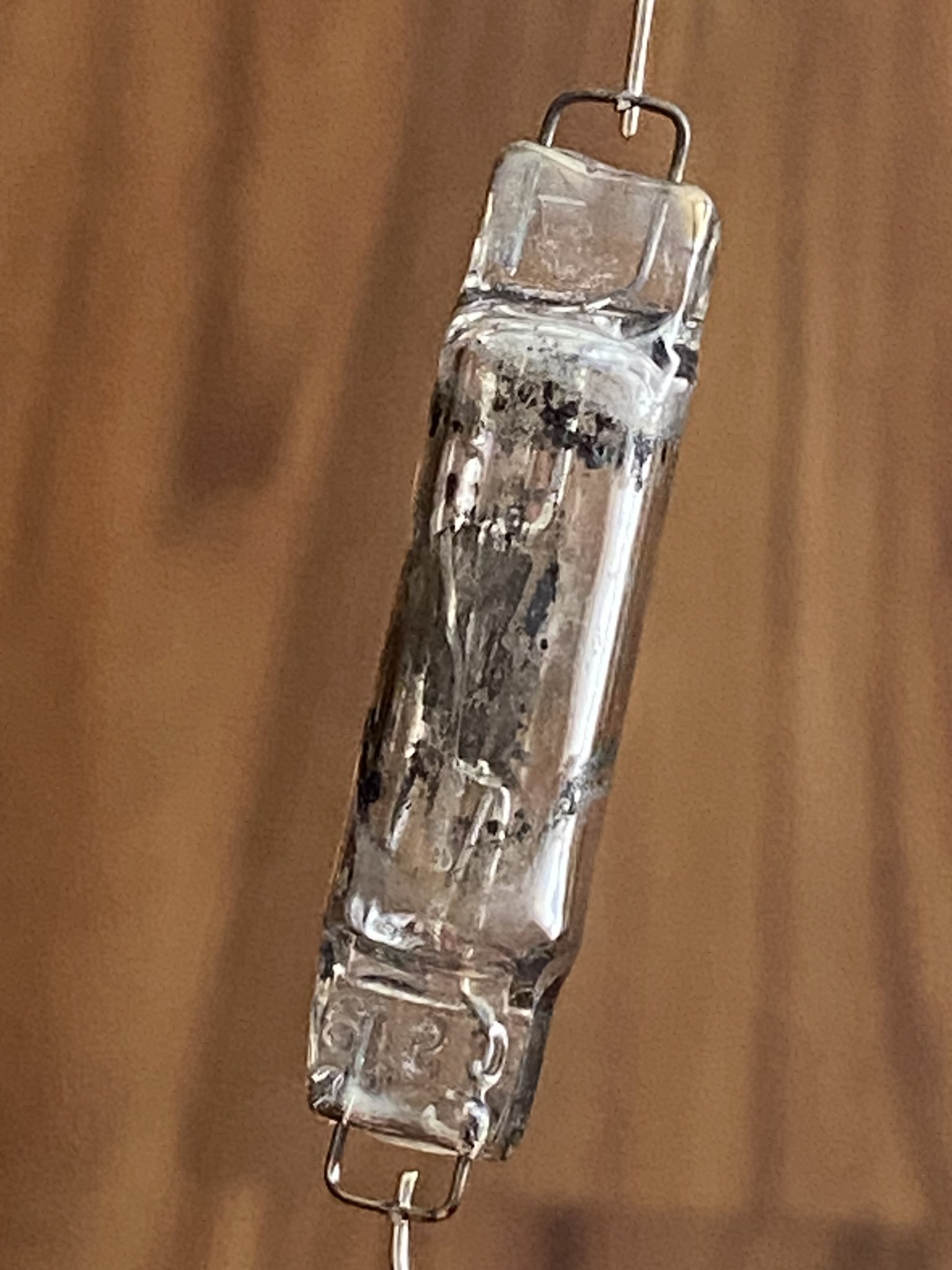

I've got a pair of Ohm Acoustics speakers from the 80's that have two fuse bulbs in the crossovers. One bulb is blown in each crossover. Ohm is notoriously tight lipped about giving out info on diy repairs of their speakers. They want you to send them to them for big repair bills. Not interested. Anyway, I need to find a replacement or simply a modern alternative to the blown bulbs. I've only taken one crossover apart. The impedance of the good bulb is 2 ohms. I've found several other fuse protection blubs online that look identical to mine, but with varying ratings, and none list impedance. The only markings on mine are "C 9" stamped in the glass end, and an "S" stamped into the other side of the same end. I would assume that a speaker engineer would factor in the impedance of the bulb when designing the crossover, yes? Although it is my understanding that the impedance of these bulbs does increase as the wattage they receives increases. The bulbs are in the fabric insulation.
Maybe get a picture of the bulb. As a guess I would go for a 12V halogen bulb of the same size roughly.

It looks like one of these...Picture of the actual bulb?
https://www.simplyspeakers.com/ev-speaker-protection-bulb-f01u109322.html
Mine...

It "looks" like one of these...https://www.simplyspeakers.com/ev-speaker-protection-bulb-f01u109322.html..., but they come in different ratings.
And, there is a polyswitch in parallel with one of them (looks like a small ceramic capacitor).
I would expect the linked EV bulb is right. Was likely a common automotive interior light for years.
Test the polyswitch about the same as the bulbs. Should be less than an ohm cold. Funny thing is sort of behaves nearly the same as the bulbs.
Both the bulbs and the polyswitch and the bulbs will have low resistance when cold and transition to higher resistance with enough constant current flow.
I would put 12 volts into a good one and measure the current draw. That way you can get the exact replacement. Assuming the good bulb is the same type as the bad one.

Thx. The poly switches must be bad too. One measures 6 ohms and the other measures 21 ohms. That's out of circuit.

Any chance there are part numbers on the poly fuses? The resistance numbers you measured could be right. Might be able to look up the expected resistances.Thx. The poly switches must be bad too. One measures 6 ohms and the other measures 21 ohms. That's out of circuit.
Considering they appear to be in parallel with one of the bulbs, they may be some finer tuning of the resistance values for the bulbs.

One measures 6 ohms. The other measures 20 ohms. Everything I read about them is they should be totally open... no real resistance, unless triggered.
The writing is "mexico" on one side and something that looks like a "xD" over "-050" over "843G" on the other side. The writing is old and tiny.

As far as I understand polyswitch, it should have some low resistance and will have higher resistance in a fault condition. Any chance you can draw a schematic from what is there? There is a good chance the polyswitches are good.
You may just need to get a replacement bulb.
Removing the bulb and polyswitch protection may alter to overall balance of the crossover. You may be able to do it, just may require some additional crossover tweaking in that case.
Also there is a good chance you can secure a close enough replacement bulb at your local auto parts store. Mostly look for 12V 2A.
