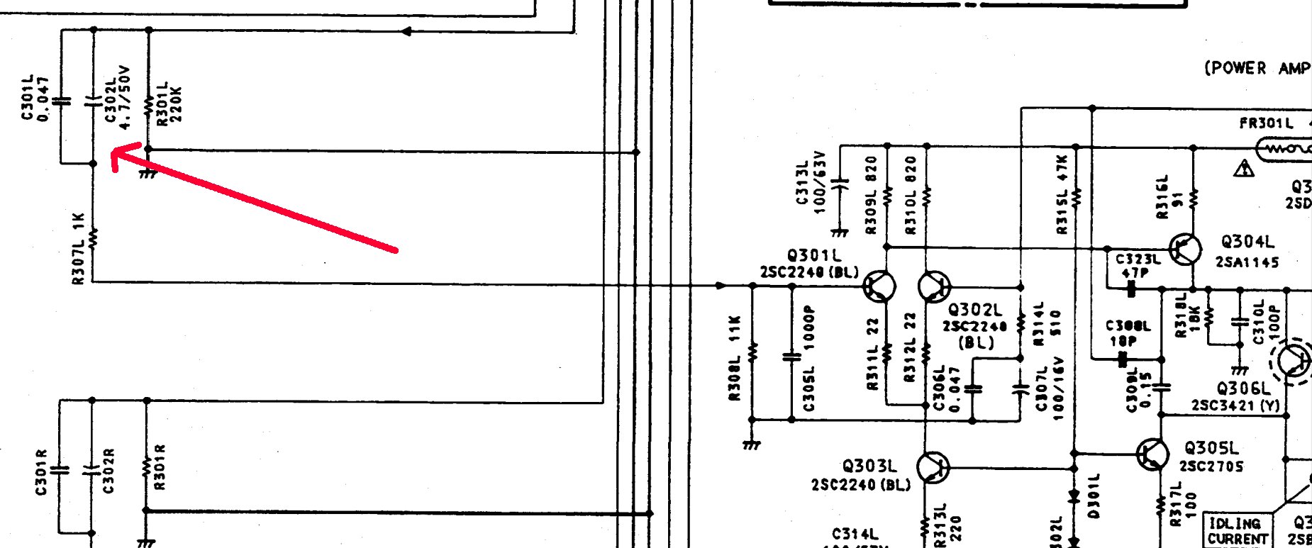

Specific question.
Circuit I'm looking at is for a receiver.
The preamp section is fed into the amp section via a series 4.7uf electro that is bypassed with a 0.047uf (noted as being a "mylar cap").
Would I be correct in thinking that replacing that combo with a 4.7uf foil/film could be a reasonable spot for upgrade ?
(Assuming that I can get said replacement to fit without excessive leads).

Calculation tells me that 4.7uF feeding 11k has an LF rolloff at 3Hz. However, the transistor input is in parallel with the 11k, so 4.7uF might not be big enough. If it is big enough then changing it for a 4.7uF film cap will make no difference. If it is not big enough then a film cap may be an improvement, but so would a bigger value electrolytic. The bigger electrolytic would probably be physically smaller than the film cap.
I mostly agree with DF96. I just want to add what I learn from AndrewT that in the whole signal chain, you want ONE signal coupling cap to do the band limit to say 10Hz, that's the one that you absolutely use film cap.......to be more specific.....metalized polypropylene cap to achieve the lowest distortion at the lowest break frequency( 10Hz in this case). Then the rest of the coupling, use as big a cap to make it as low a frequency as possible, use electrolytic cap.
In this case, 4.7uF give 3Hz as DF96 said, if this is the band limiting stage, you don't want to use electrolytic cap, you get distortion at 3 to 10Hz. BUT if this is not the band limit stage, you want to make it to break below 1Hz, more like 0.5Hz or so. In another words, I'll try to find a 22uF that can fit into the pcb holes.
As you can see, they use 0.047uF film with low esr in parallel. That's the exact reason I talked about paralleling caps. Inside the caps, the higher the value, the more layers your have, more parasitic inductance you have. Particular electrolytic, they literally roll two layers in a roll. part of the roll is long way from the leg that comes out. Inductance is proportion to the length/width. If you have a roll, length >>width and create high series inductance. this will create a resonance peak at higher frequency. That's when the parallel cap with smaller value comes in.
The smaller cap has less inductance, it takes over right before the resonance frequency of the big cap. and keep the impedance low. Then when reaching the resonance of the smaller cap(say 0.1uF), you want to have another smaller(330p surface mount) to cover that.....and so on and so on.
Here, the designer must be thinking about keeping the impedance low at higher frequency. I would have done the same thing.
Now!!! This parallel cap business is assuming that you have good layout with ground plane to provide low inductance ground. People in audio seems to be against ground plane. If you start adding ground trace as return side of the filter cap. That CAN act as inductance and you open a new can of worm and see resonance/distortion and oscillation. Then in turn you blame the cap!!! I can even see the low impedance of the small parallel cap can create sharper resonance peak. BUT this is the designer's fault, don't blame on the poor cap!!!

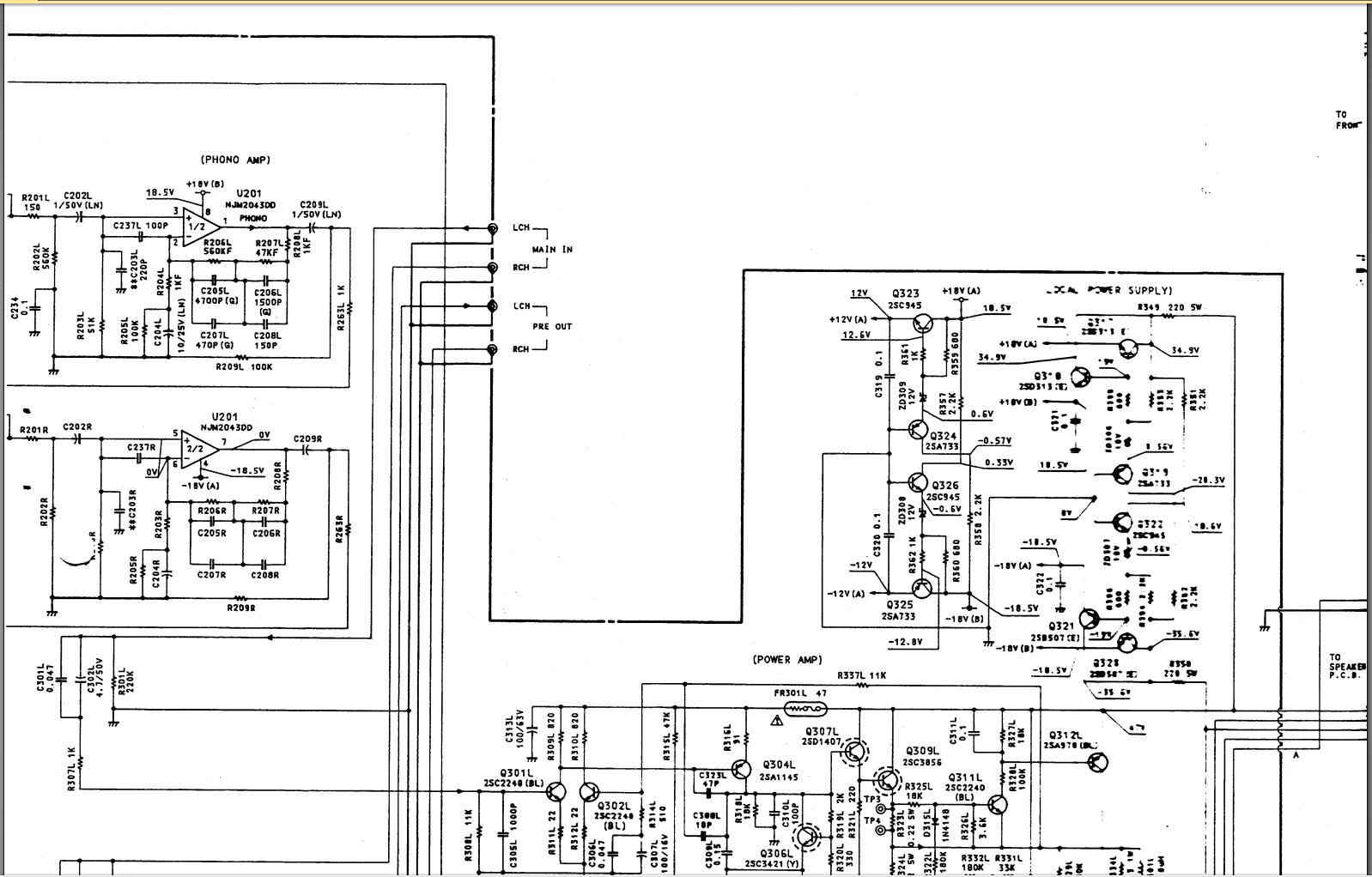

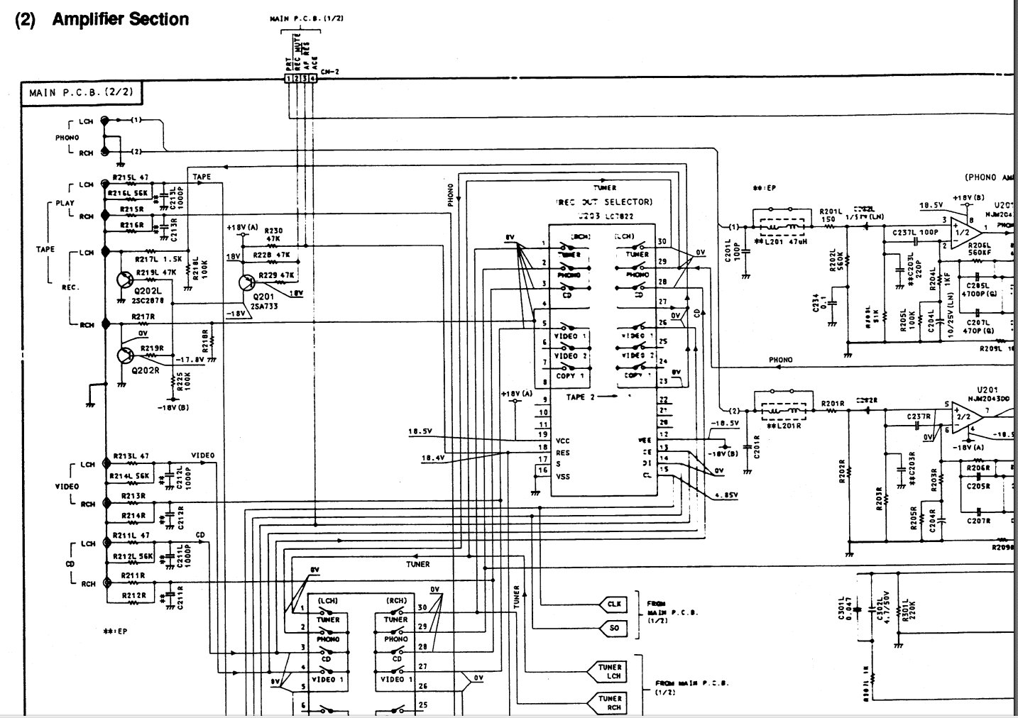

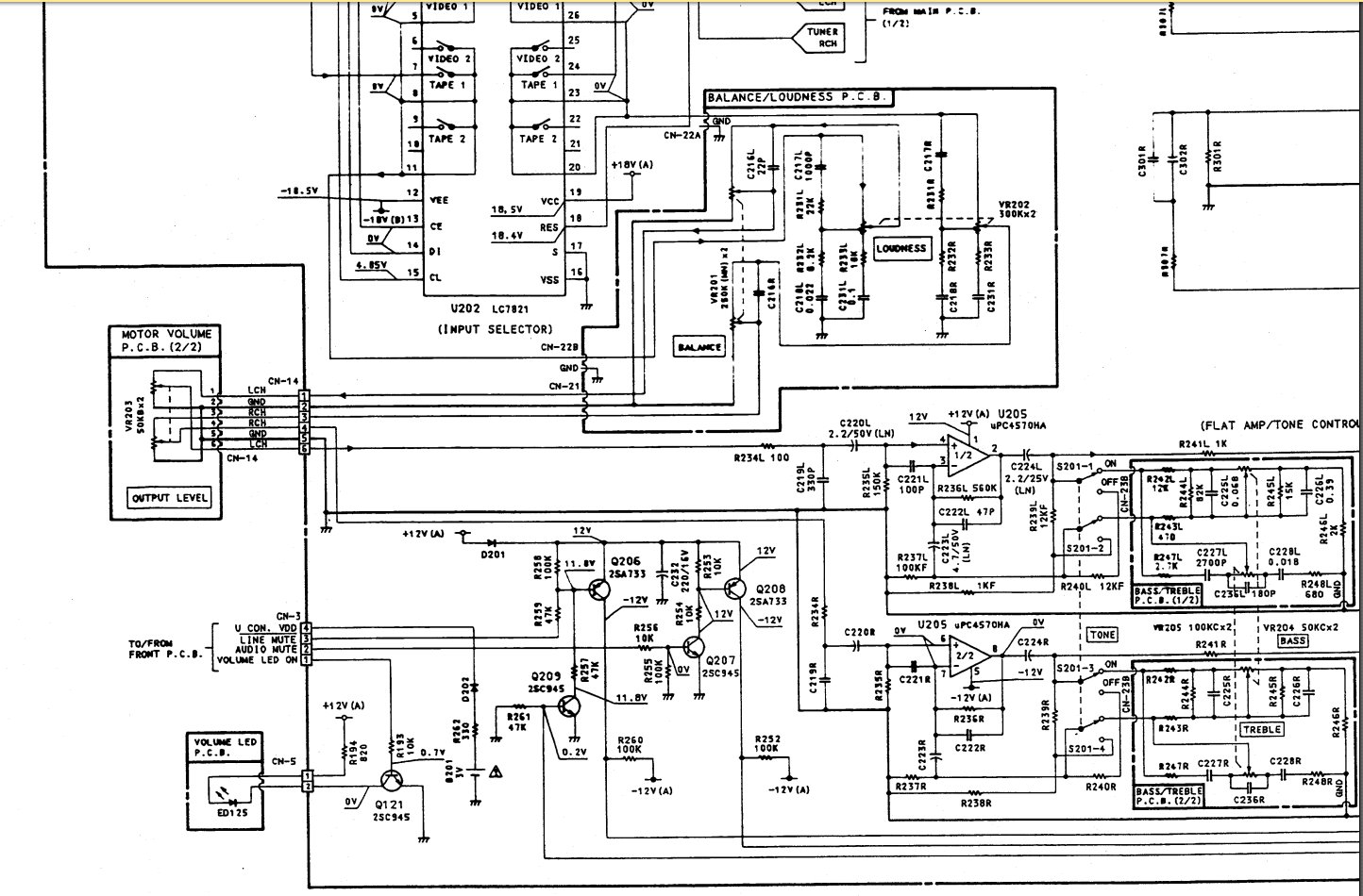

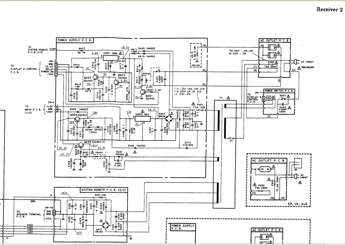

This is a nakamichi re-2 which I believe is based of a nakamichi receiver 2.
Ian is right in that mine is indeed (vomit) bakelite boards.
As is pretty much 99% of what I work on.
But that was the norm for 80's japanese consumer items .

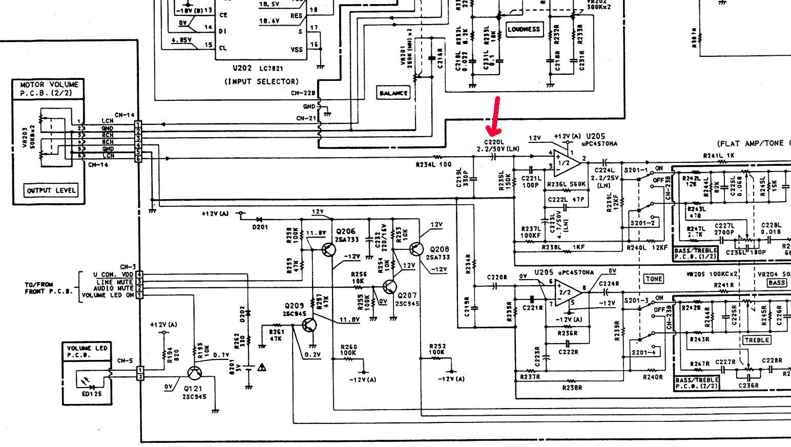

Having a quick look at the schematic, I've found another series cap.
2.2uf from volume control......
I'll try to edit the relevant parts of the schematic and post those.
System here won't like the 8mg pdf's 🙂
EDIT - Added pics of main audio section of RE-2 and power supply of Receiver 2 (Supposed to be the same ?)
Sorry for the bad images, there the best I have..
