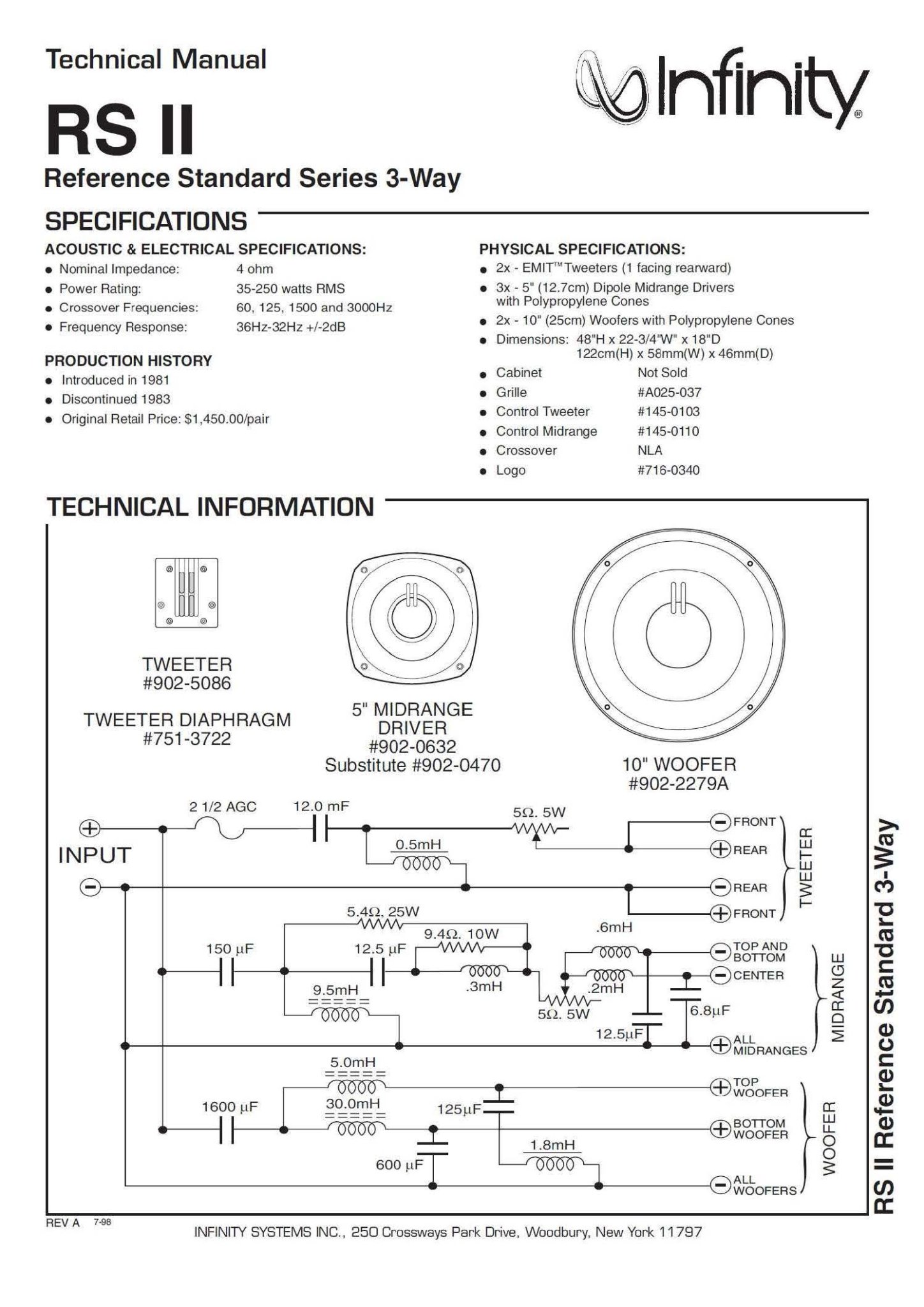

Hi all, quick question. My crossovers have 2 pots each to adjust highs and mids. One of the mids pot is completely shot and the other one reads funky. Tweeter pots seem OK but they're 42 years old.
According to schematics, all pots are 5 ohm 5 watt:
But in real life, they're clearly different. Folks say the mids pots are 15 watt and the tweeters 5 watt, and that looks plausible:

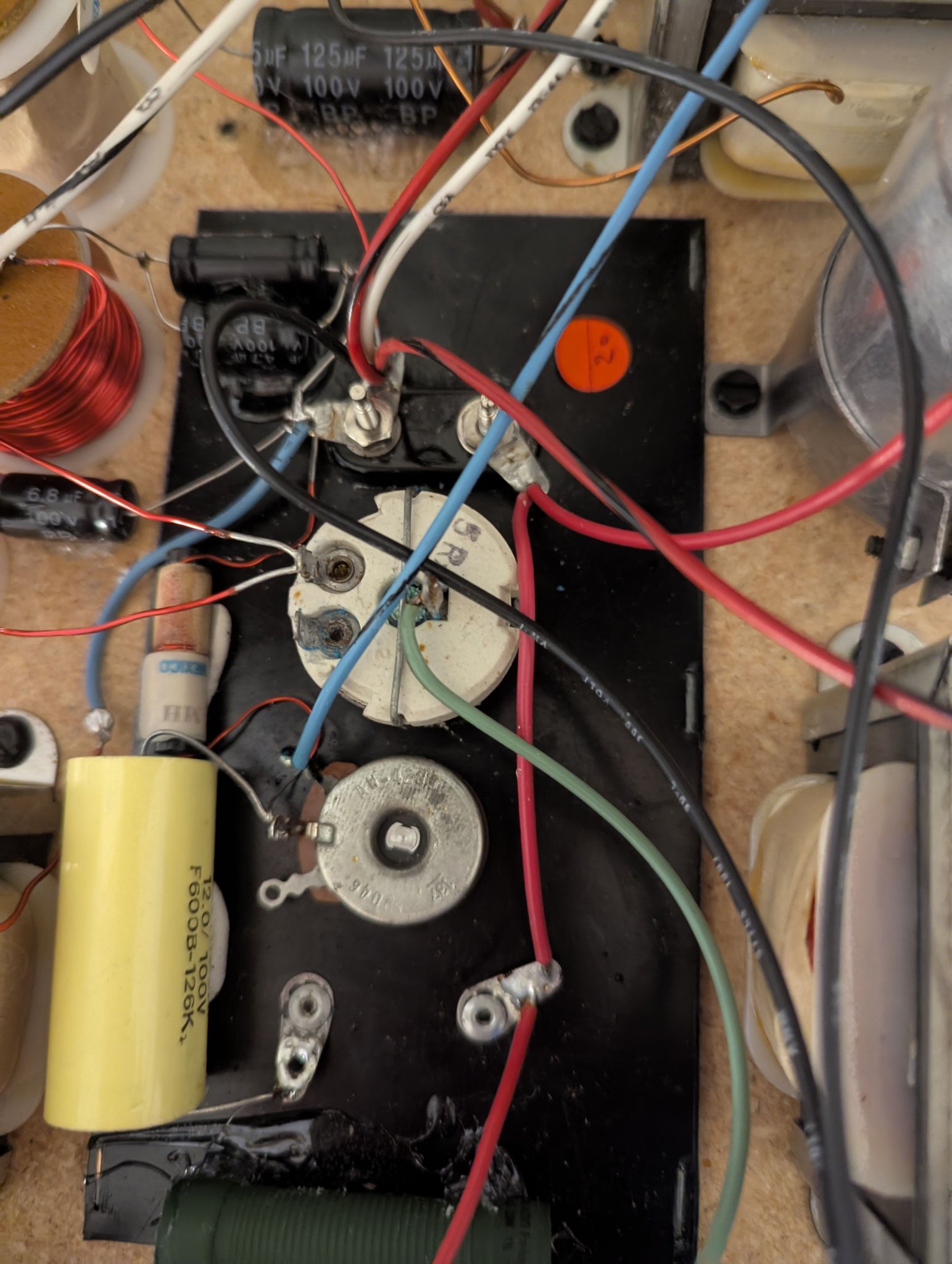

My first thought was to just replace the old pots... but audio grade 5 ohm 15 watt pots only appear to exist in Australia
So now I'm considering replacing them with fixed resistors, since their utility is debatable to begin with.
I tested them (out of circuit):
- Tweeter pots measure 2.5 ohm at midpoint and 5 ohm all the way down, so that's all good per specs
- The one mid pot that sort of still works measures 3.4 ohm halfway, and 5.7 ohms all the way down. The other mid pot is too far gone to measure anything.

I'm not sure your technical level, but personally I dislike using power pots for the same reason you are replacing them. Whenever possible sub a single value resistor.
Also, some infinity crossover designs suffered from less than optimal impedance curves brought on by last minute changes. I wouldn't do much to an Infinity crossover without first checking to see if there were upgrades which improve the impedance and or measuring the speakers electrically (using DATS or Room EQ Wizard) first. If you could find an online impedance curve that shows it to be a reasonable load then you'd be all set. If the curve is bad (i.e. has very low points) then consider a crossover rethink before replacing any parts. Not to mention that any electrolytic cap left in that could well be out of spec by now.

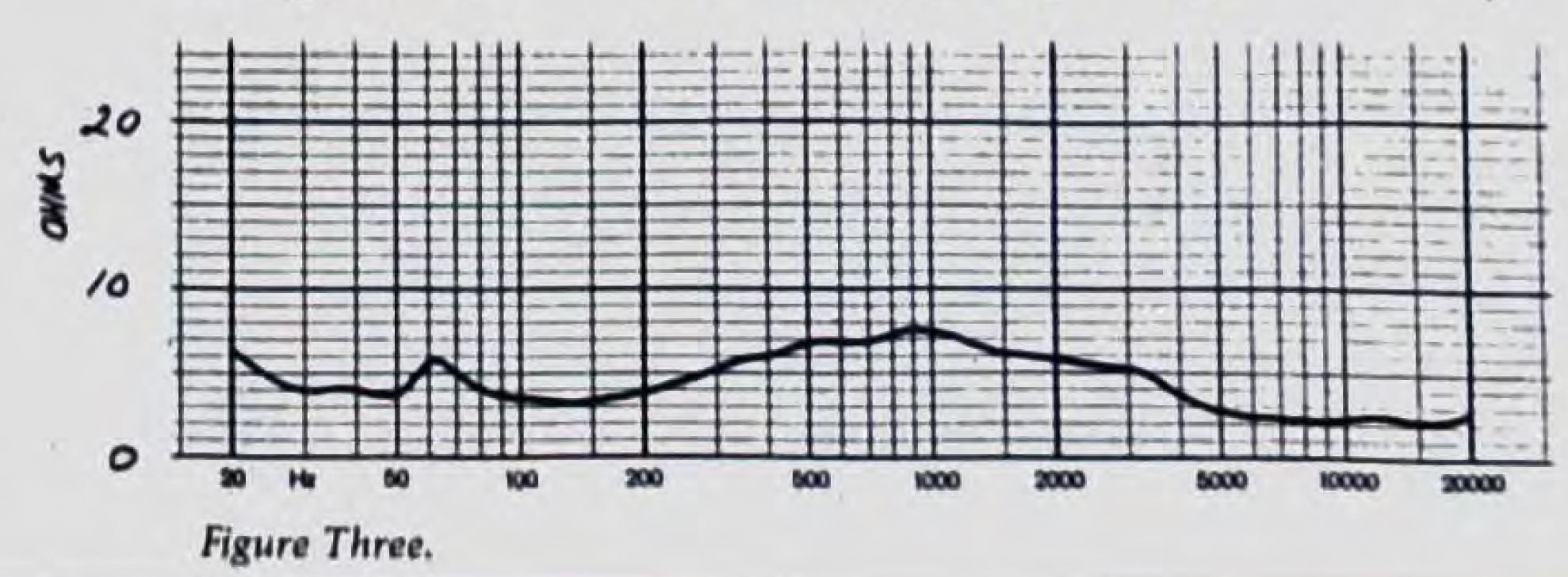

Here is RS-II's impedance curve:
As you can see there's a 3 ohm dip above 100 Hz, while the EMITs are basically a 2 ohm load. Nothing terrible, though amplification needs to be planned accordingly if they are to sound their best.

Not too bad, but a generally punishing load in the treble for the amps of the day.
Given the wiring they do look like simple pots. If one or the other speaker has one set correctly you can use it to gauge the resistance you need, or just buy a bunch of 2 ohm + 0.5 Ohm resistors. 🙂 Personally I like Mills for quality as well as size. They are remarkably small for the power rating, so long as they stay well ventilated.

Anyone that looks at the posted schematic or the picture will see that there are only two connections made to each of those those potentiometers. So even if they were L-Pads, without three connections they would behave exactly like a single potentiometer. I'm not sure why Boydic was so confident with this wording. He's absolutely right in that most well designed crossover typically use L-pads so the crossover point would not change with attenuation. If these were my speakers I would put a 4 ohm L-pad in place of those pots and connect all three terminals of the L-Pad.Just to be clear........ These are not "POTS"........

Did it ever occur to you, that maybe the schematic was drawn wrongly?? Wouldn´t be the first time, someone confused
the "open end" way of drwing the symbol for L-Pads
Only way to check is physically look at the actual crossover in person, to see how it´s connected.
I won´t believe for a second, that a speaker brand like Infinity would put a "POT" in series with a speaker-voice-coil,
thus f-ing up the frequency response/crossover freq. by adjusting the level of mid´s and high´s.
EDIT: See the picture now..... only saw the schematic yesterday.
What a terrible way of doing things....... I´m baffeled by the poor standard.
If it was me, I would by 2 L-Pads and do it the "right" way, when already planning to change parts.
It would be nothing other, than a great improvement.

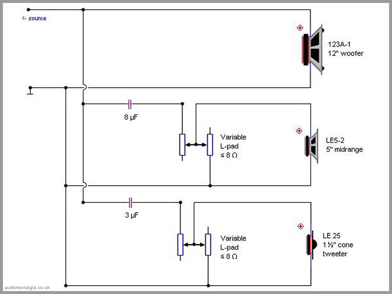

Should note that as drawn, the L-Pads have a very wide range. If we imagine the wiper reaching the bottom of the drawing, the two terminals of the driver are then connected to the same conductor, which by definition has 0 volts across it and the driver is then effectively shut off. 😉

Here's a guy selling 4 Ohm L-pads. It could be wired as the original simple variable resistor, using IN & OUT, or you could attach the ground to have it work as an L-pad with constant source resistance. If you have a measurement microphone you could see what effect it had on the crossover.

An 8 ohm 15W L-Pad attenuator should work, just connect it as a rheostat, it won't change the crossover design and give you more adjustment range. My 2¢.The one mid pot that sort of still works measures 3.4 ohm halfway, and 5.7 ohms all the way down.
It may come down to what part best fits in the space. L-Pad or rheostat, either will work. I would set what ever you get to 3.4 ohms and note the position and install it.
