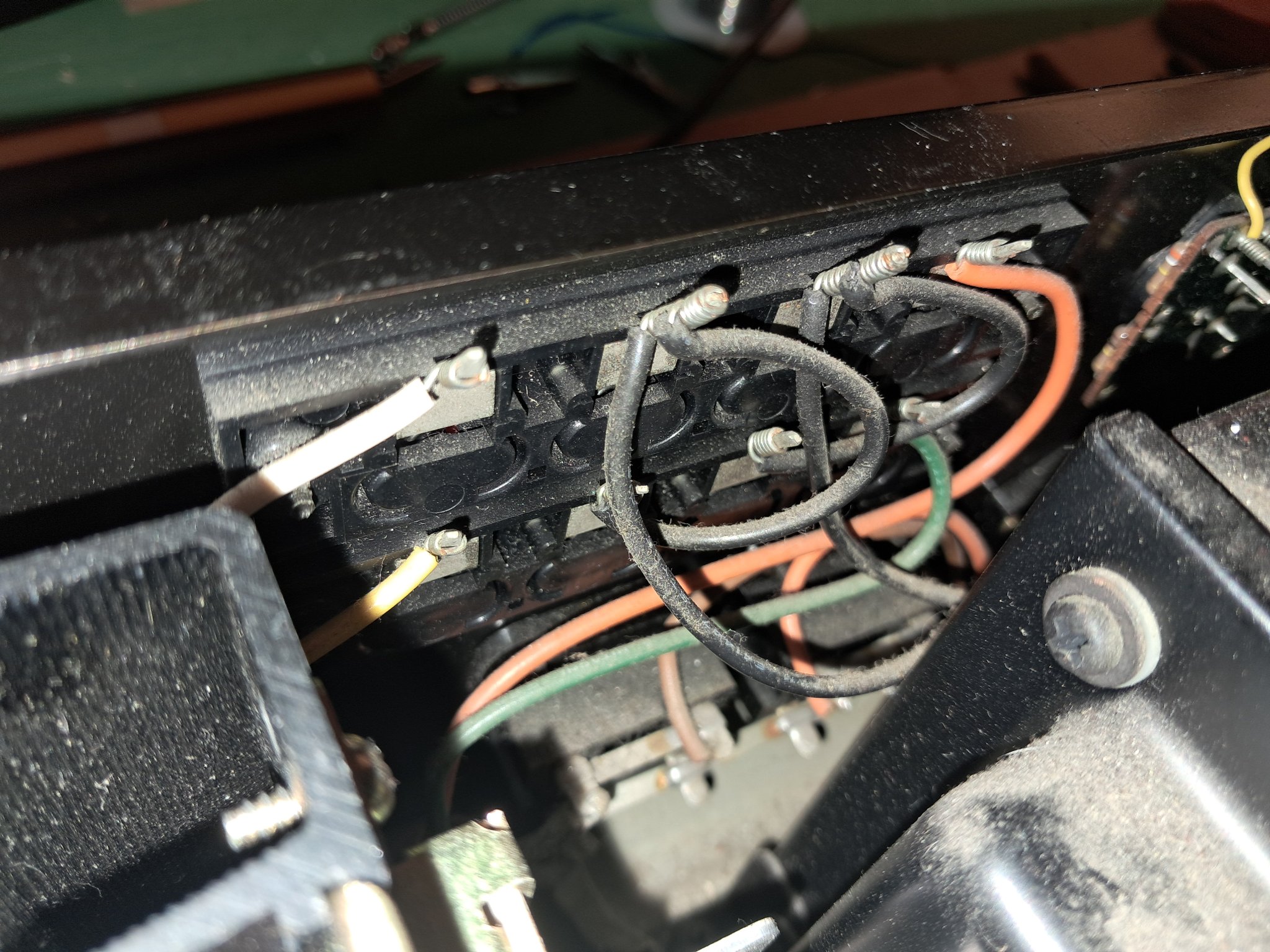

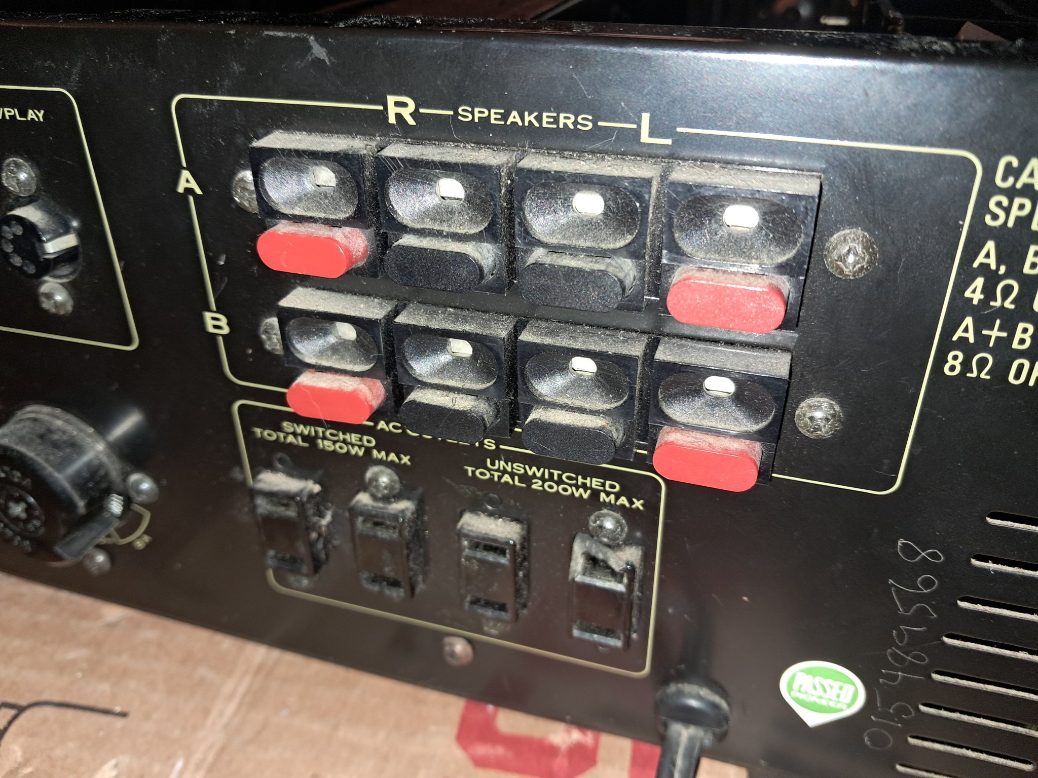

I have a Pioneer SA-9500 mkII whose speaker terminals are rectangular blocks, 74mm by 18mm, each holding 4 terminals. Photos below show the Pioneer.
I also have a Sanyo JCX-2600K whose speaker terminals are ALSO rectangular blocks, 74mm by 18mm. Is this a standard form factor? Are speaker terminals with this form factor still available?
It would be nice to upgrade the ones on the Pioneer since they are steel, and steel contributes some distortion.
It would probably work to buy some Pomona dual binding posts, cut a rectangular piece of hardboard, drill it, clamp the posts to it, and affix it over (EDIT or behind?) the rear panel using the same screw holes that held the original terminal blocks. But it would be nice to avoid all that by staying with the original form factor so it looks OEM.

These are direct replacements for the original plastic clamps: https://speaker-terminal.com/en/produkt/pioneer-sa-9500-ii-speaker-terminal/
They're likely to be brass, but you would have to contact the supplier to make sure.
