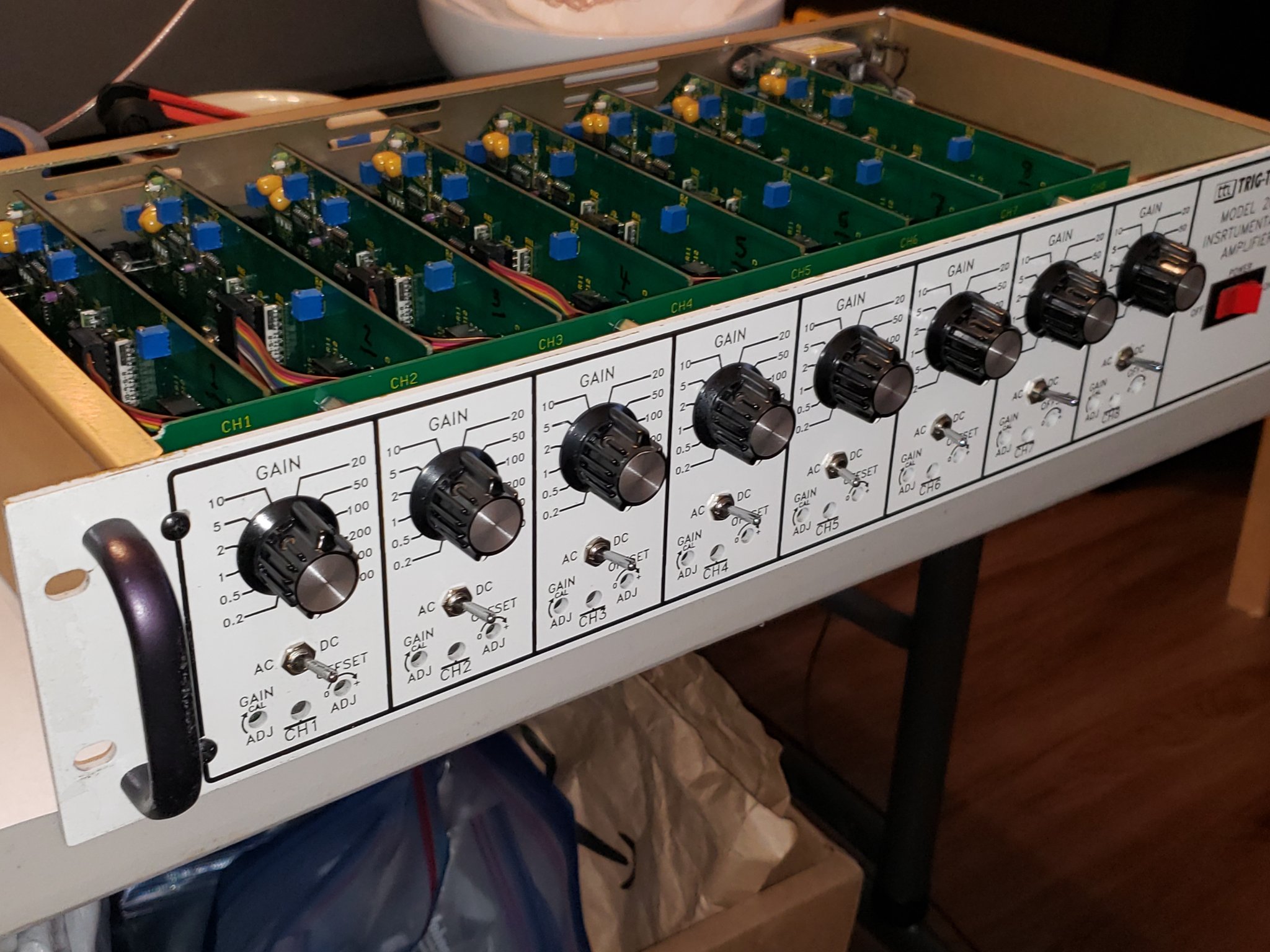

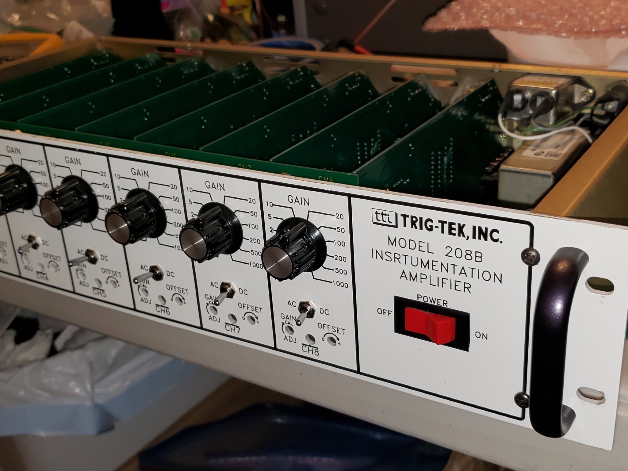

Got this for cheap....up to x1000 gain, 8 independent, single-ended channels. BNC in/outs.
See below for my ideas... what to use this for...audio-wise.....
Trig Tek Incorporated.
Model 208b

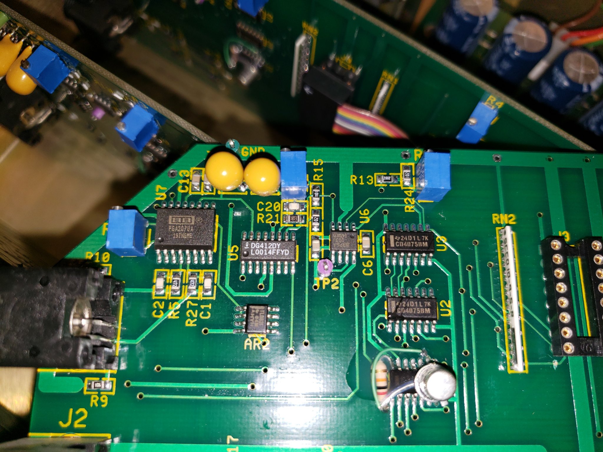

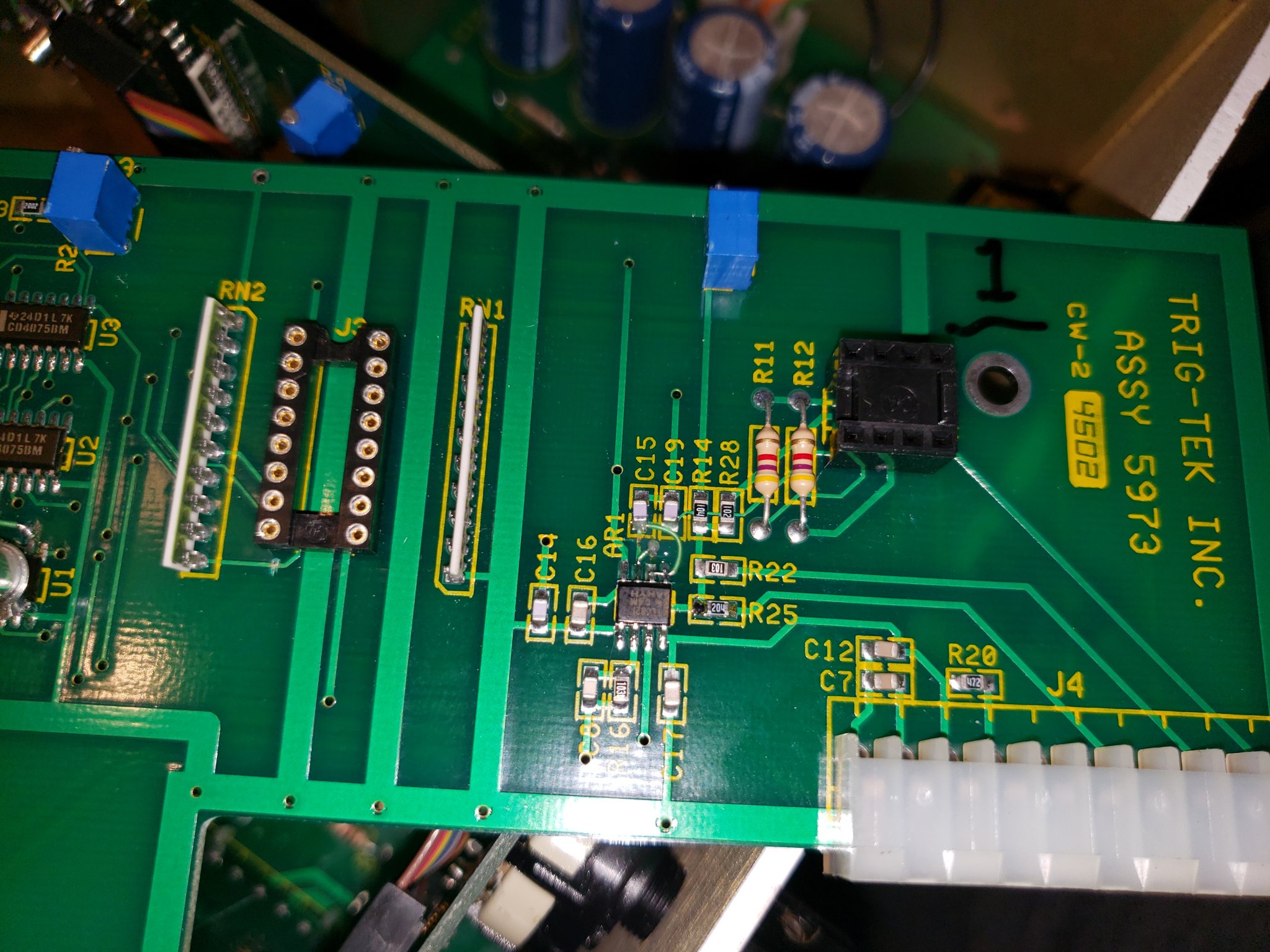

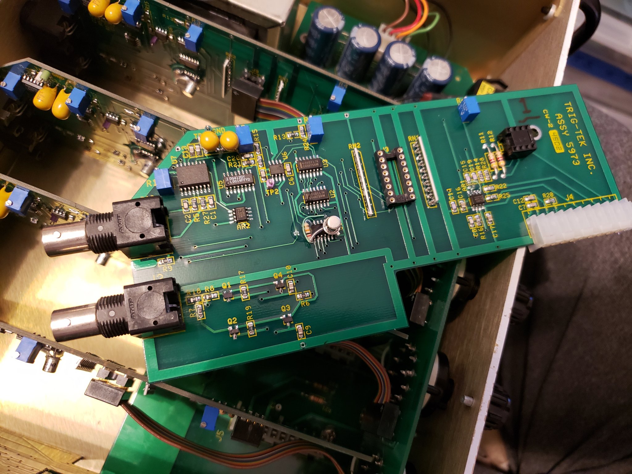

The unit is pretty straight-forward, though I'd like to know the calibration process. Each board has 4 trimmers.
Also, each board has an empty 8-pin DIP socket, which I believe is for optional filters (Hi, Low, Bandpass, whatever.....I'm not positive.)

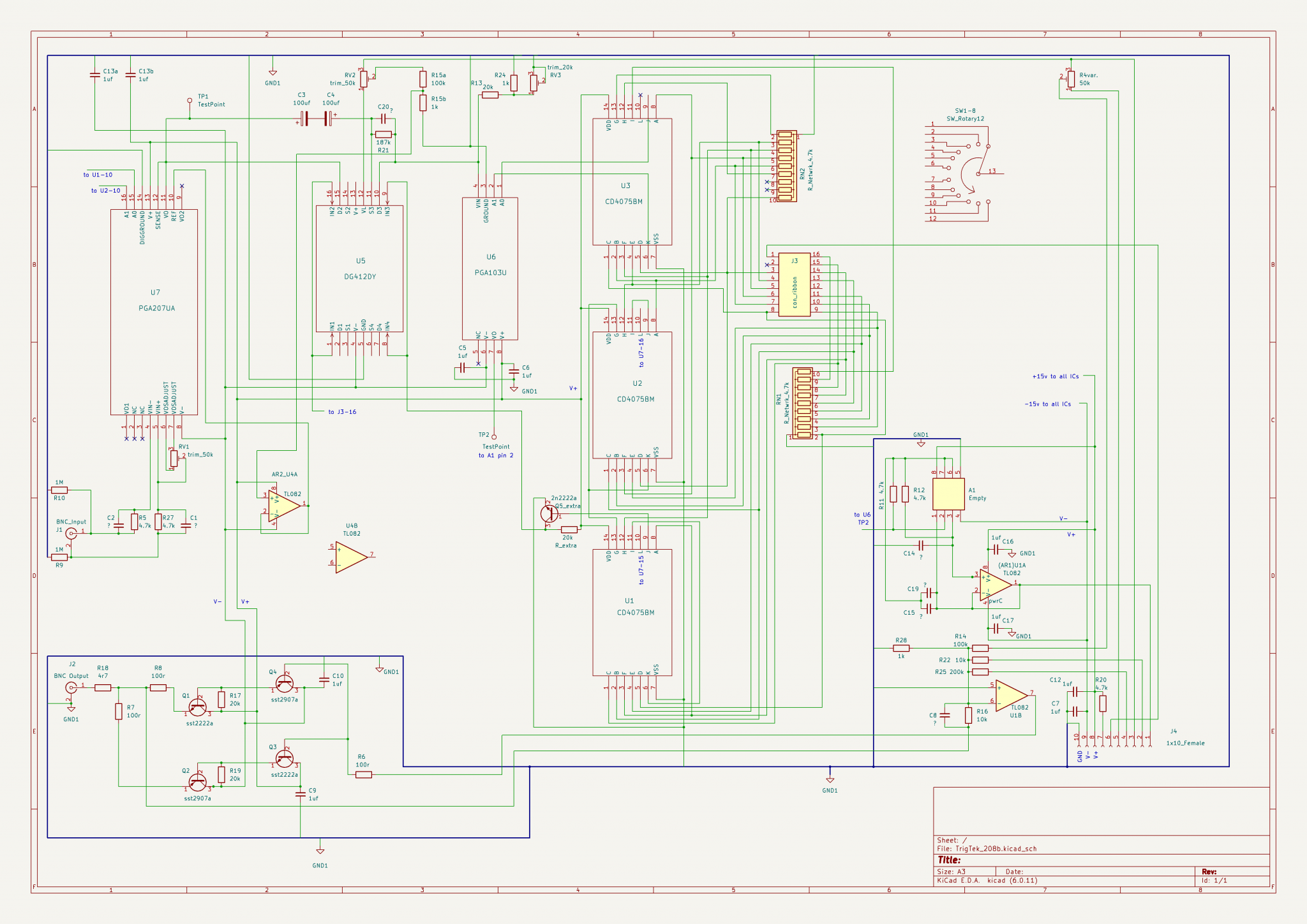

I may have to re-engineer the circuit.
The 16 pin socket connects a ribbon cable to each switch. The 8 pin socket might be for optional filters (??)
All the Lorlin 12 pos. switches were hardly working (no signal).
I opened one up, and found the contacts had a covering of hardened goo. I tested all my solvents, and the only one that worked was Naptha.
There are vent holes in the switch body, so I flushed each switch with Naptha, then blew them out with compressed air. I repeated with Isopropyl Alcohol, and finally a couple drops of DeOxit Gold.....spinning the contacts a lot.
Switches fixed.
Passes clean signals.
Main chip....
PGA207ua ..............5-MHz, 100-pA bias current, FET input programmable gain (g=1,2,5,10) instrumentation amplifier (link)
I assume this was used to amplify load-cells, strain gauges, vibration monitors, or accelerometers.....??
