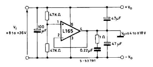

I'm building a regulated supply for an active crossover circuit. The crossover uses 12 op2134 chips and will want +/- 15V at less than 100ma.
In the spirit of reusing, reducing, and pure cheapness I was wondering if I could employ one of the several wall wart ac/dc adaptors I have laying around. I have one of those Mac computer supplies that gives 24V, could this be used to get +/- 12V for a regulator circuit? If this is advised, how would I get the +/- 12V from the 24V and keep ground at 0.

If you want to use the laptop adaptor and the supply ground to connect to your split 0V then that requires a transformer.
The lazy way is just to divide the 24v in two with two identical resistors, and put a fat capacitor (1000uF or bigger) across each resistor to minimise the ground impedance. The centre point of the resistors becomes the new ground.
A better way is to buffer the new ground point with a power op-amp, like in the diagram. For 100mA you dont need anything as beefy as an L165, an L272 will do.

so maybe Steerpike's first suggestion would work? This is a voltage divider, right? Wouldn't the C R pair work for this with the 0V rail going to ground?

Rereading the replies above I realize my misunderstanding; creating a voltage divider would put ground at 12V, - rail at 0V and + rail at 24V. Is this correct?

Laptop power supplies, and other such "wall wart" devices, are designed to be safe without requiring grounding of the output. Use the op-amp voltage divider circuit given above. You'll end up with the 2 wires from the power supply at +12 and -12 volts, and the centre tap of the voltage divider at 0V.
