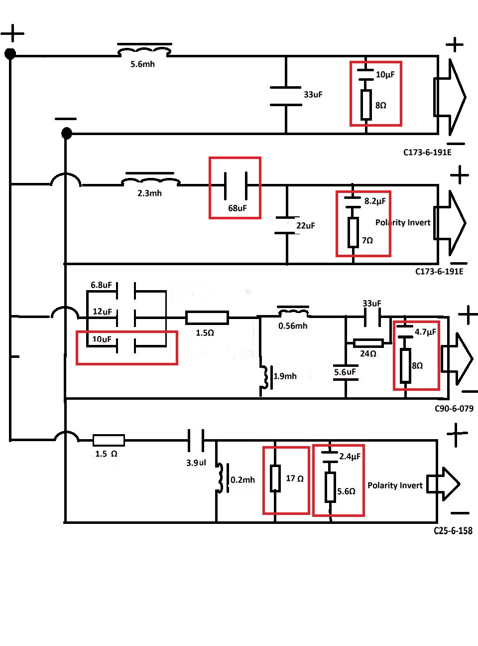

저는 4방향 패시브 크로스오버 네트워크를 설계했으며, 제 디자인에 대한 전문가의 피드백과 제안을 부탁드리고 싶습니다.
다음은 시스템에 대한 간략한 개요입니다:

I see no Zobel network for amplifier load consideration, despite saying there is. Can we assume you had AI write your post?
I’d like to help but there is minimal indication of your acoustic conditions and no measurements of them. Advice from this point may either have to be general in nature or guessed.

To clarify: Zobel networks are included for each driver, but they might not have been clearly visible in the schematic. They are placed across the driver terminals (woofer, midwoofer, midrange, and tweeter) to flatten the impedance at higher frequencies.
Regarding the post, I used AI (ChatGPT) as a tool to assist in organizing my design notes and theory, but all component selections and final design decisions were made manually by myself.

First off, use of ChatGPT to design a crossover is a recipe for failure. It is an search script with language based answers, and it's easy to get taken in by the language, but the actual answer lacks any real understanding of crossover design (or of most technical subjects).
Crossovers are specific to the combination of individual drivers, baffle layout and enclosure. This means that any crossover designed by AI will be useless, since it does not implement those inputs in such design. It is most likely that any changes you make in your speaker will have a worse result than what is already there, unless that crossover was also similarly designed.
Driver impedance isn't a number, it's a reactive component and changes with frequency. AI does not know this. Drivers react differently depending on where the driver is positioned on the baffle. AI does not know this either. Boxes have their own radiation pattern, and ports have gain and resonances. AI does not have this information either. Would I like an AI tool to be able to design a crossover properly? Yes. Does it exist? No.

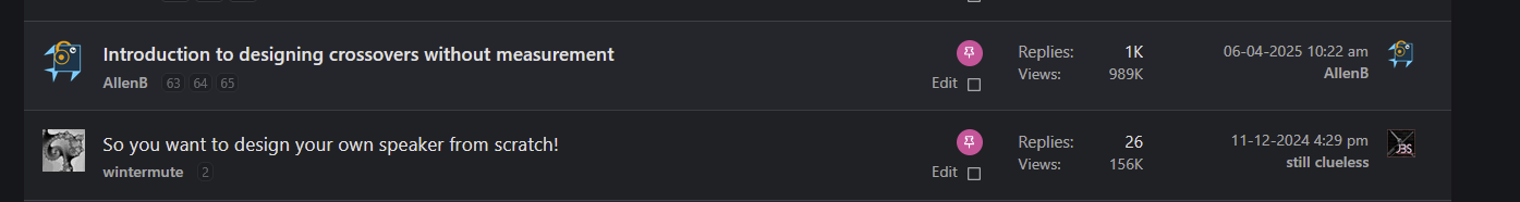

There are a number of stickies at the top of this forum you should read before starting on this journey. I'm pointing out the specific ones that are designed to help newbies get started, please do read them thoroughly before asking more specific questions.

The parts marked in red boxes are circuits that were suggested by AI (ChatGPT) during the design discussion.
These elements (mostly additional capacitors and Zobel networks) were not present in the original crossover design, but were proposed by AI to improve impedance stability, frequency response, and phase alignment.
I am still learning and carefully considering each suggestion before final implementation.
Your expert feedback would be greatly appreciated to verify whether these additions make sense in a real-world application.

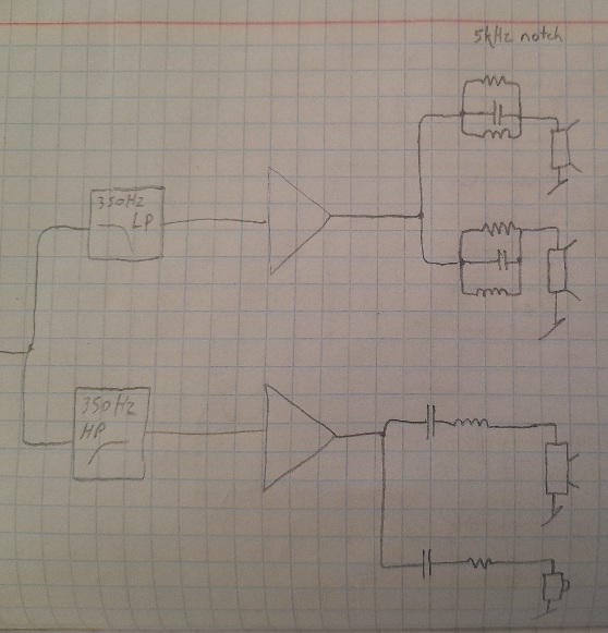

A simple active-passive hybrid. The active part might not even have to be truly active (with op-amp gyrators), but could use a passive RC network that is buffered and driven by a pre-amp.
I would avoid adding a zobel network unless you are certain that it is necessary. Even then, try to make it global, away from each individual speaker, as its purpose is to flatten the total impedance seen by the amplifier.
Isn't zobel network supposed to linearise driver impedance so that the preceding filter section sees a flat impedance and hence, can do its work according to the textbook?
Probably, but it's a moot point, as the impedance is dynamic, changing with things like voice coil temperature, and programme material, so I wouldn't overthink it. What I had in mind was keeping the impedance flat for the amplifier.
