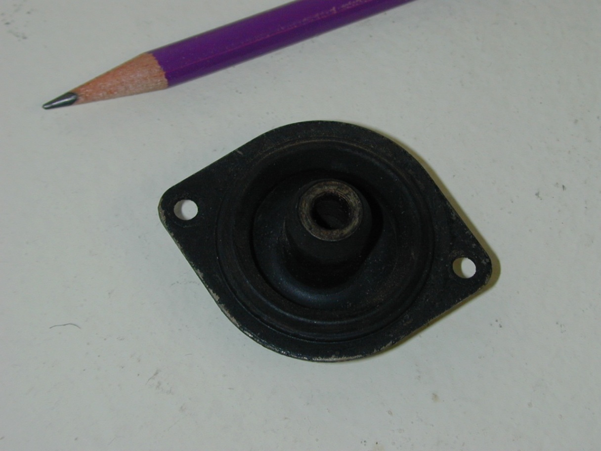

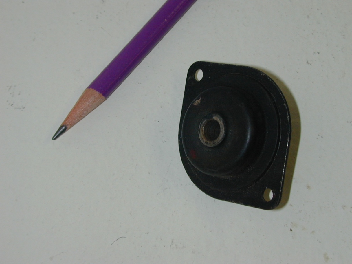

Several practical considerations when sizing isolators:
You typically want the most compliant mount that will support the load (fe/fn > root 2 ), but super-soft mounts won't support much weight without excessive sagging. They are also prone to failure when bumped hard or dropped. You can use travel-limiting washers to prevent this failure mode with the mount style shown below. (The travel limiting washers are bottom mounted.)
Grommet style mounts are easy to use, but are in general stiffer than the motor-mount style or the elastomeric block (sandwich) style.
Grommet style: McMaster-Carr
bolt down style: McMaster-Carr
sandwich mount style: McMaster-Carr
I have bunch of Lord isolator mounts as shown below. If you want a handful to experiment with, PM me your address and I'll send some over.
