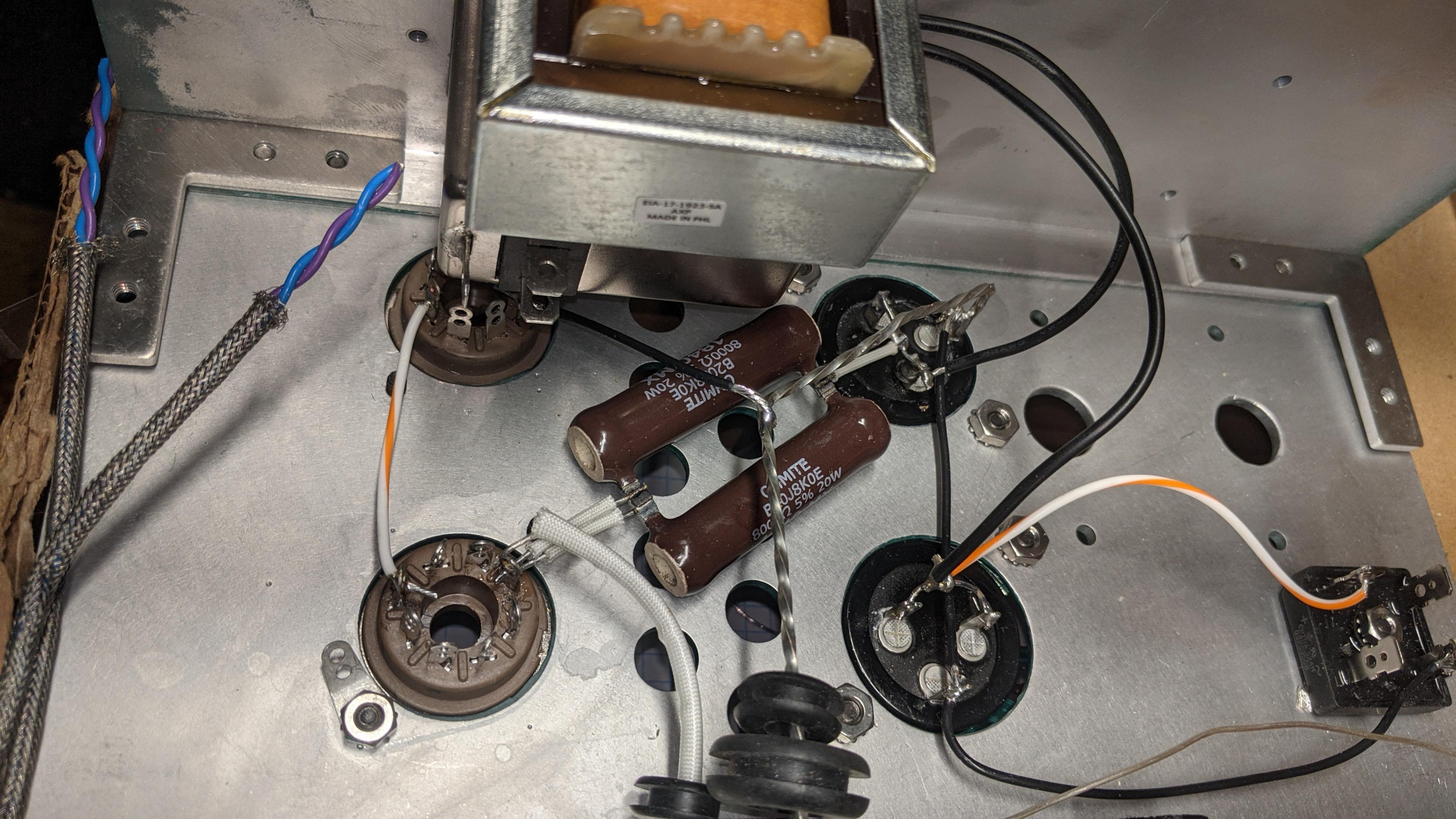

I've changed the resistor mounting location to a top corner inside the chassis, set a piece of heat sink on top of it, and secured it all with a bracket of sturdy spring steel that I bent into a shape that provides constant pressure to the whole works - pushes it into the corner of the (all metal) chassis and forces the heat sink down onto on surface of the ceramic.
I popped the bottom cover on it and have been running the amp for several hours. The exterior corner of the chassis (opposite where the resistor is located) is obviously radiating some heat, but it isn't painfully hot or anything.
I am going to continue to run it all day and evening, and then shut it down for the night and open it up tomorrow morning to inspect it. If all is well, I'll consider it good enough.

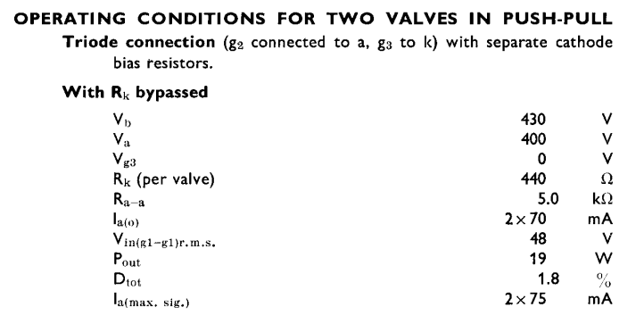

The amp sounds better than it ever has. I also modified it from a shared cathode resistor / bypass cap topology to dedicated cathode resistors and bypass caps. At this point the EL34s are operating very close to the Mullard spec for this topology, except plate voltage is running at 390v instead of 400v and I installed 470ohm cathode resistors vs. 440ohm.

This thought occurred to me as well, but I don't have 2 200ohm resistors.
However, I do have a couple of 20W 250ohm resistors that I just removed from the amp (they were shared cathode resistors before).
If I parallel the 100ohm with one of the 250ohm, I'll have about 71 ohms. PSUD2 shows my ripple increase by about 100mV but my B+ and plate voltage will be pretty-much bang on Mullard spec (as shown earlier). The two resistors will share the job, and there will be less overall dissipation to share.
I'll do it.
I'll do it.
Done. Plate voltage is right at 404V now and the two resistors are warm after a few minutes. I am sure they are still going to get hot, but nothing like before. This is all around a better solution. I very much doubt I will be able to hear any difference.
