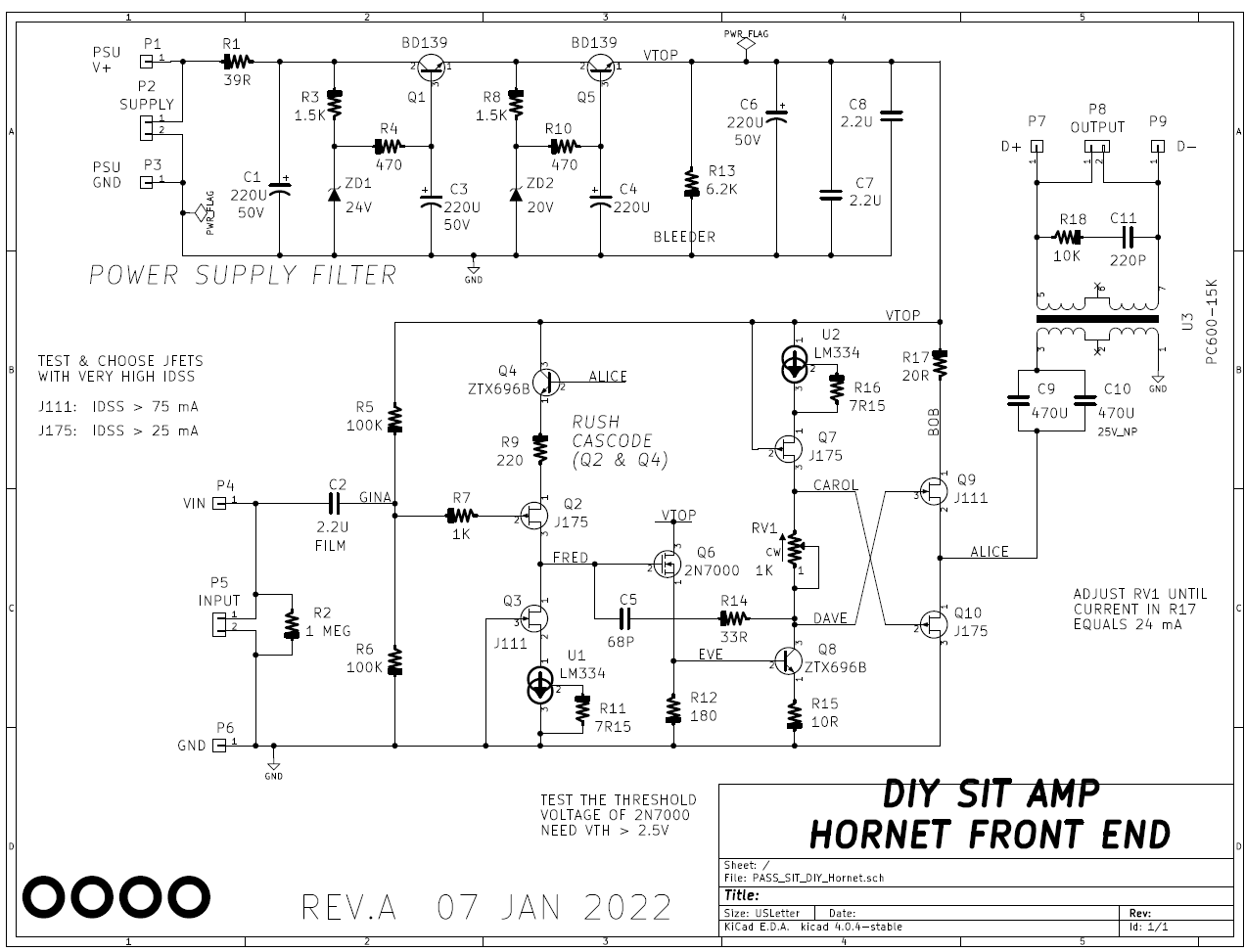

I personally use vertical resistors all the time. I even give them a special "symbol" on the schematic, showing which terminal is the abutted straight-thru lead and which is the flying wireloop. Why? So I can arrange to have the really important circuit nodes easily accessible to scope probes and/or alligator clips. For example in the attached schematic, node GINA is accessible via the flying wireloop of resistor R6. Node EVE is accessible via the flying wireloop of resistor R12. Node DAVE can be probed on the flywire of R14, etc. The abutted ends of resistors are much more difficult to probe.
_
_
