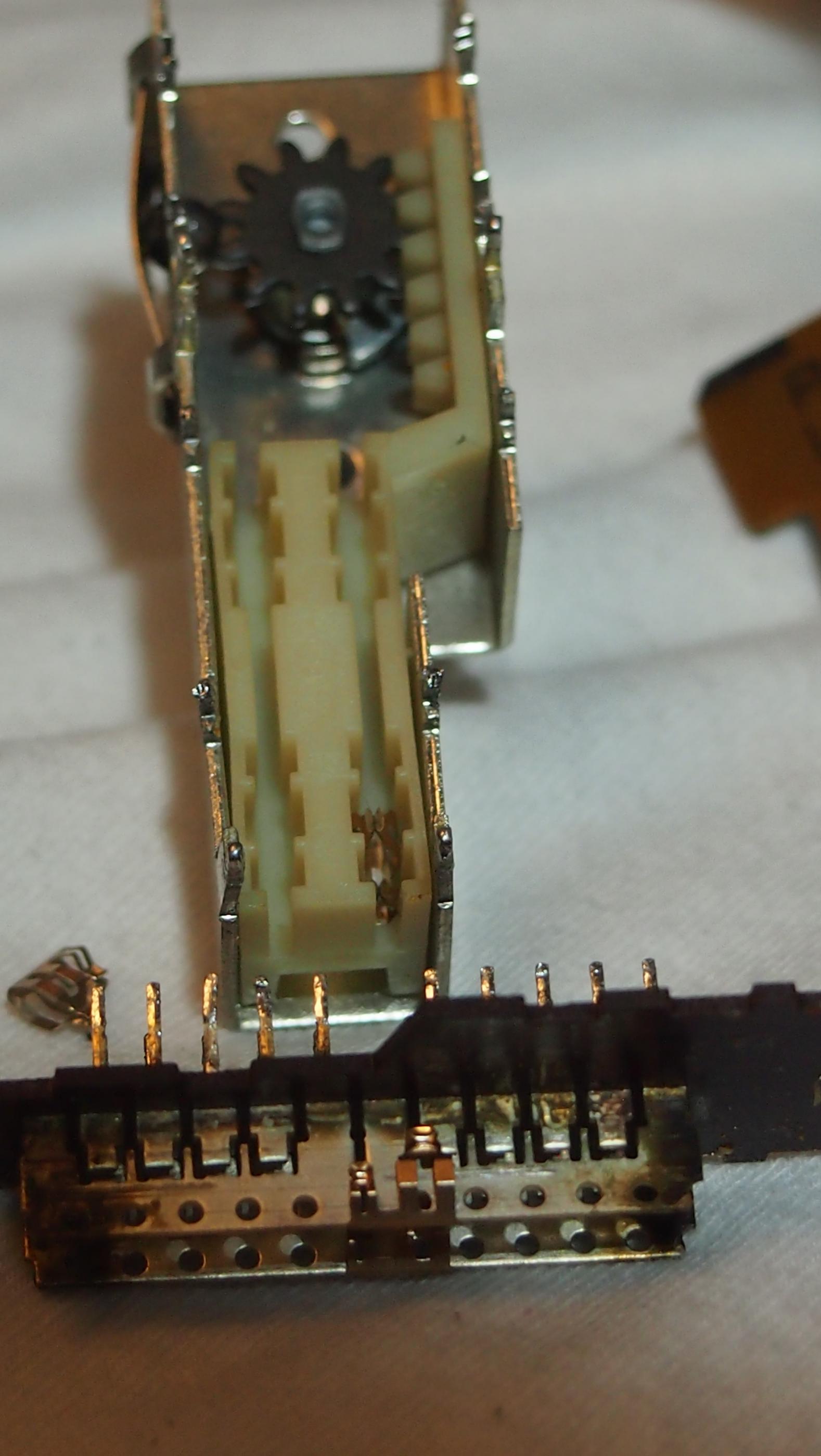

Alps rotary/sliding selector switch, Alps 1-822-11 923L
Application: Sony TA-F xxx ES, speaker selector.
Function (CW): 1+2, OFF, 1, 2
Total impression of amp before restoration, a bit weak on power, thin bass and flat sounding. Low on dynamic/freq.band.
Fault: Speaker selector switch made cracking noise when engaged.
Fix: Unmounted and disassemble the switch. Parts where very dirty due to somebody prior to this tried to fix it with some elektro- cleaner- spray (this is a hazel, PLS don't spray things it only works for a short time and then make things worse). For metal parts I clean it out, and use a metal polish to get rid of any oxidation. Then clean of any chem. rests with ISO propanol to void bad contact.
For the plastic part's I just cleaned them.
- But how can we lube or preserve them better?
- Is it possible to treat metal (cu, al) parts for better contact and longer life?
Picture of disassemble switch,

Yes, use a good quality contact grease. I use Electrolube SGB. Wonderful stuff for contacts and pots.

Thanks Jon!
Will order and try that one. Do you treat variable carbon resistors with it too?
Don't know what kind of aerosol been used on this amp but it has done more harm then good!

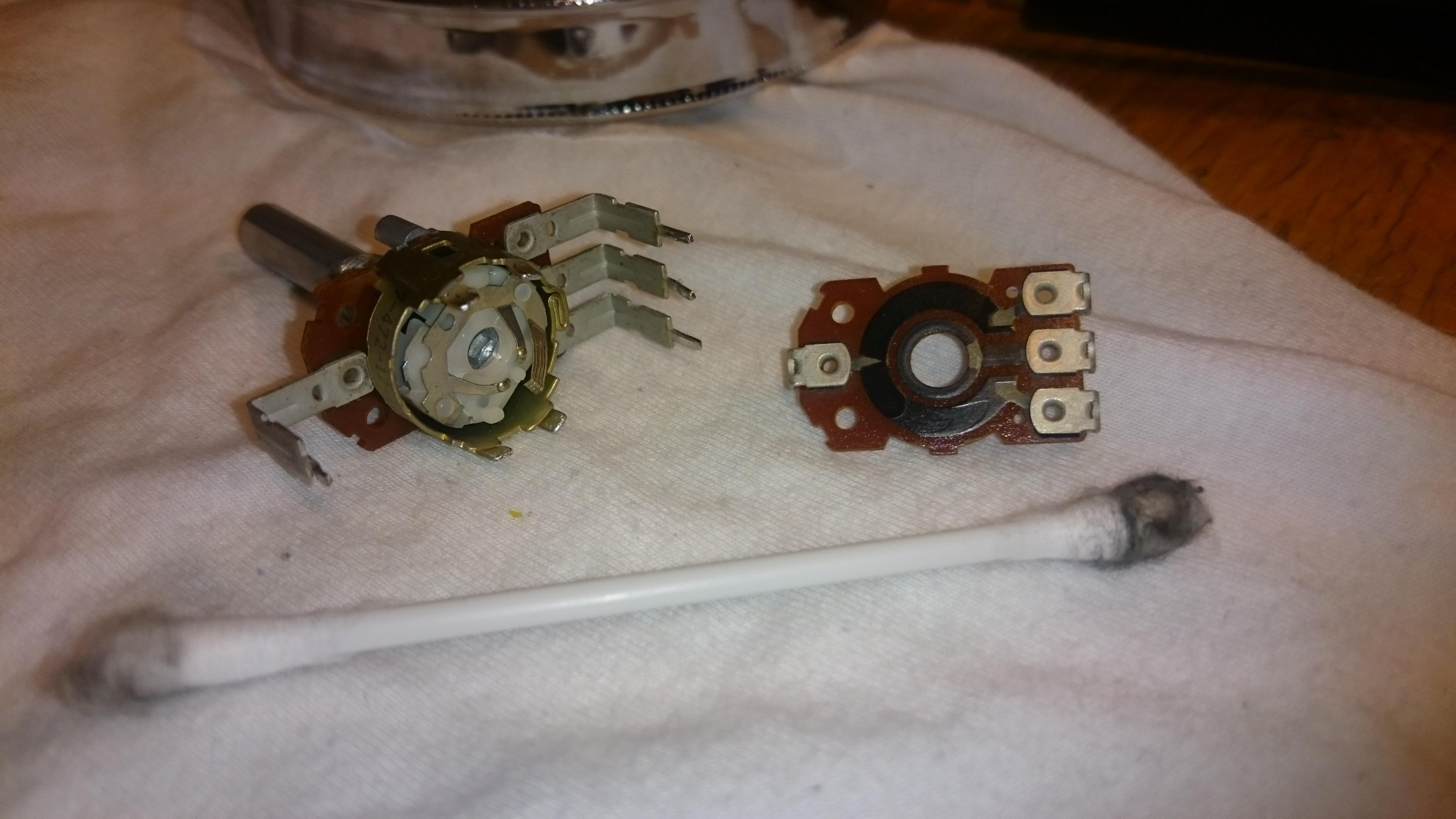

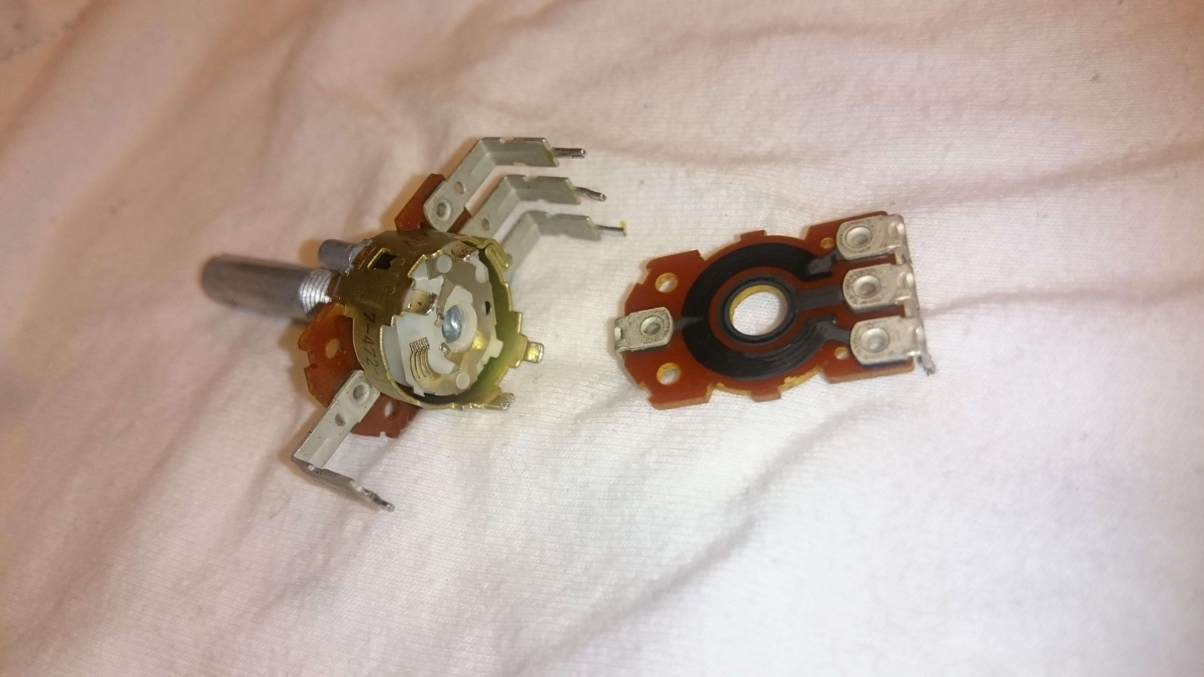

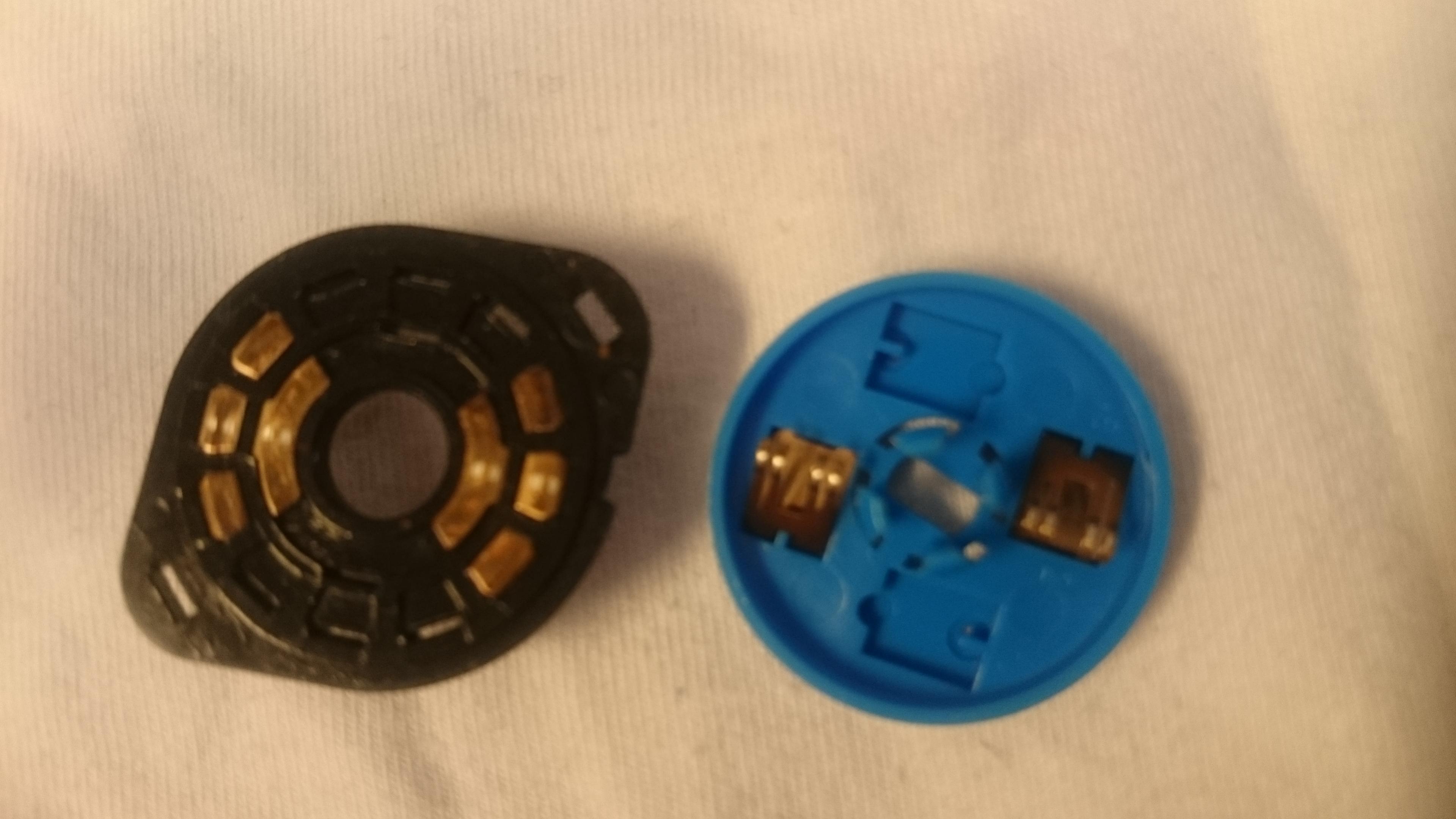

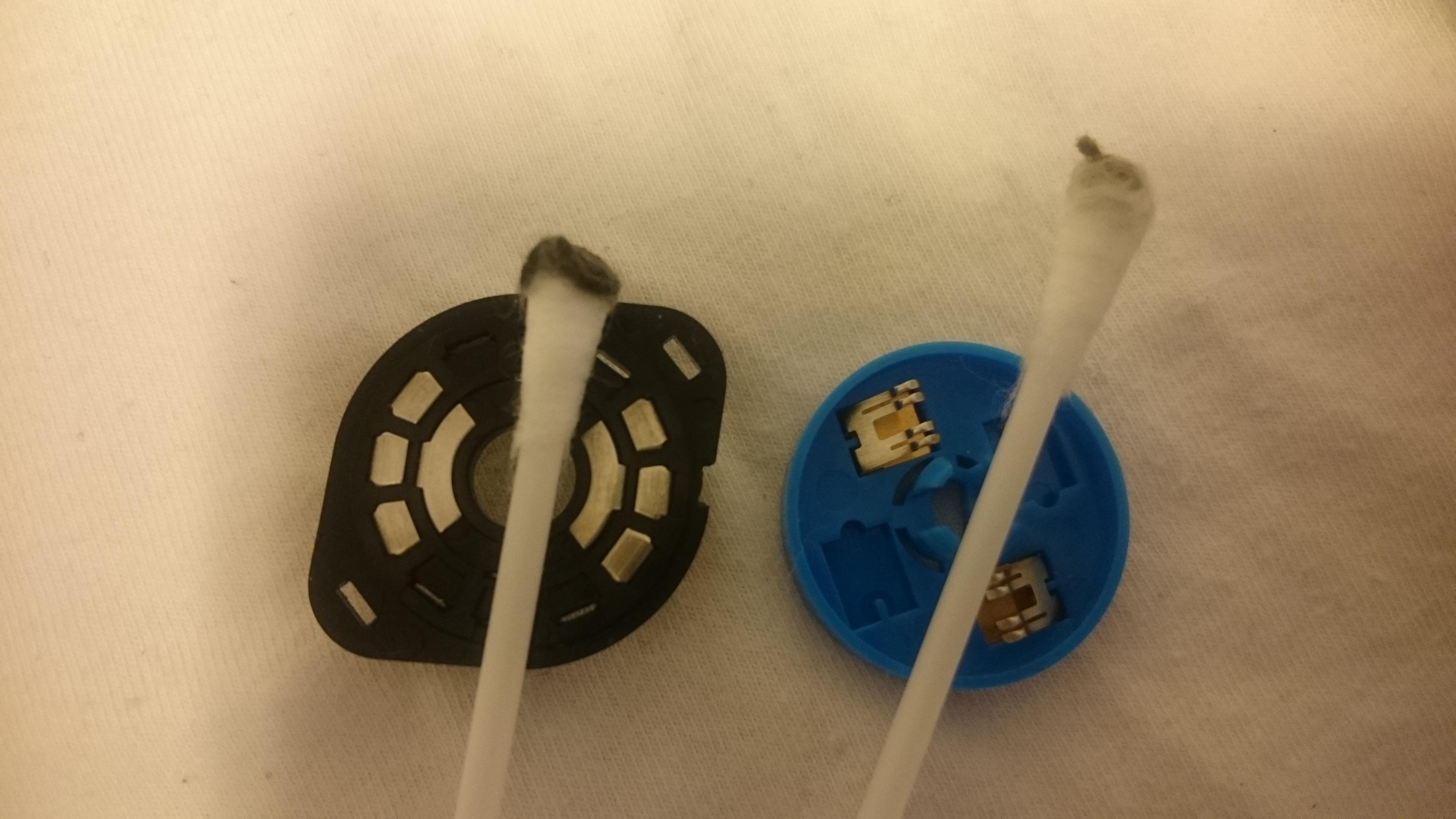

Here is one more Alps rotary selector for function's, making noise of course, was a bit oily on outside when I took it apart. Works perfect after a real cleaning.
Next is a carbon pot. that to sprayed to a greasy bad sounding control. Quiet narrow signal path on some, any risk for crosstalk here?
I spend lot of time restoring 70s and 80s gear and I find the Deoxit line of products to be good. I am sure that there ar emany other alternative solutions, but that is what I have been using.
some of these old components can be really dirty, but one must be really careful with the method of cleaning. Most of the alps selector switches are silver or sometimes gold plated. Using any abrasive measures of cleaning could affect that thin layer of silver and actually make things worse. If cleaned correctly, the resistance should be almost non existent. For the silver plated contacts, they are bound to tarnish again, so an anti oxidant dielectric is recomended. I use Deoxit Feather lube. This is not an anti-oxidant, but it is very good at creating a long lasting protective layer that keeps moisture out and inherintely protects agains tarnish.
as far as crosstalk, grease based lubes do sometimes result in crosstalk. I have never had the issue after cleaning and applying Deoxit.
