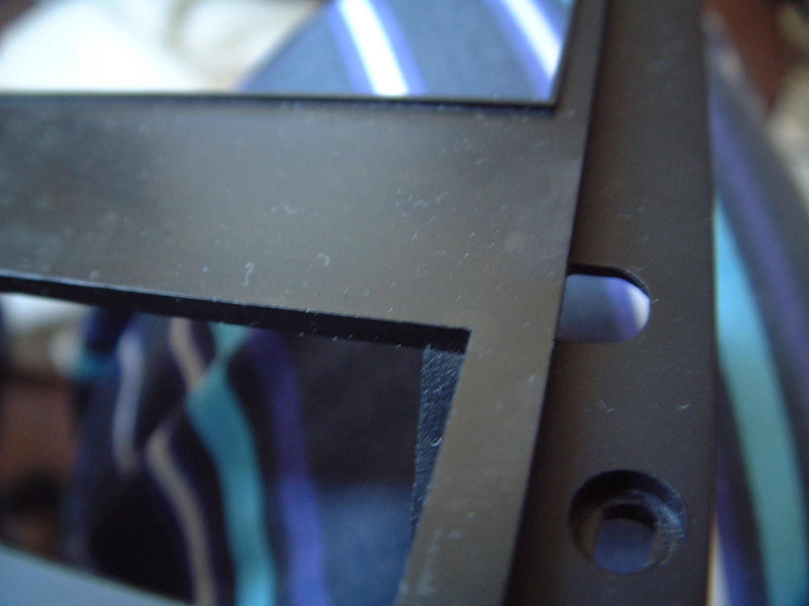

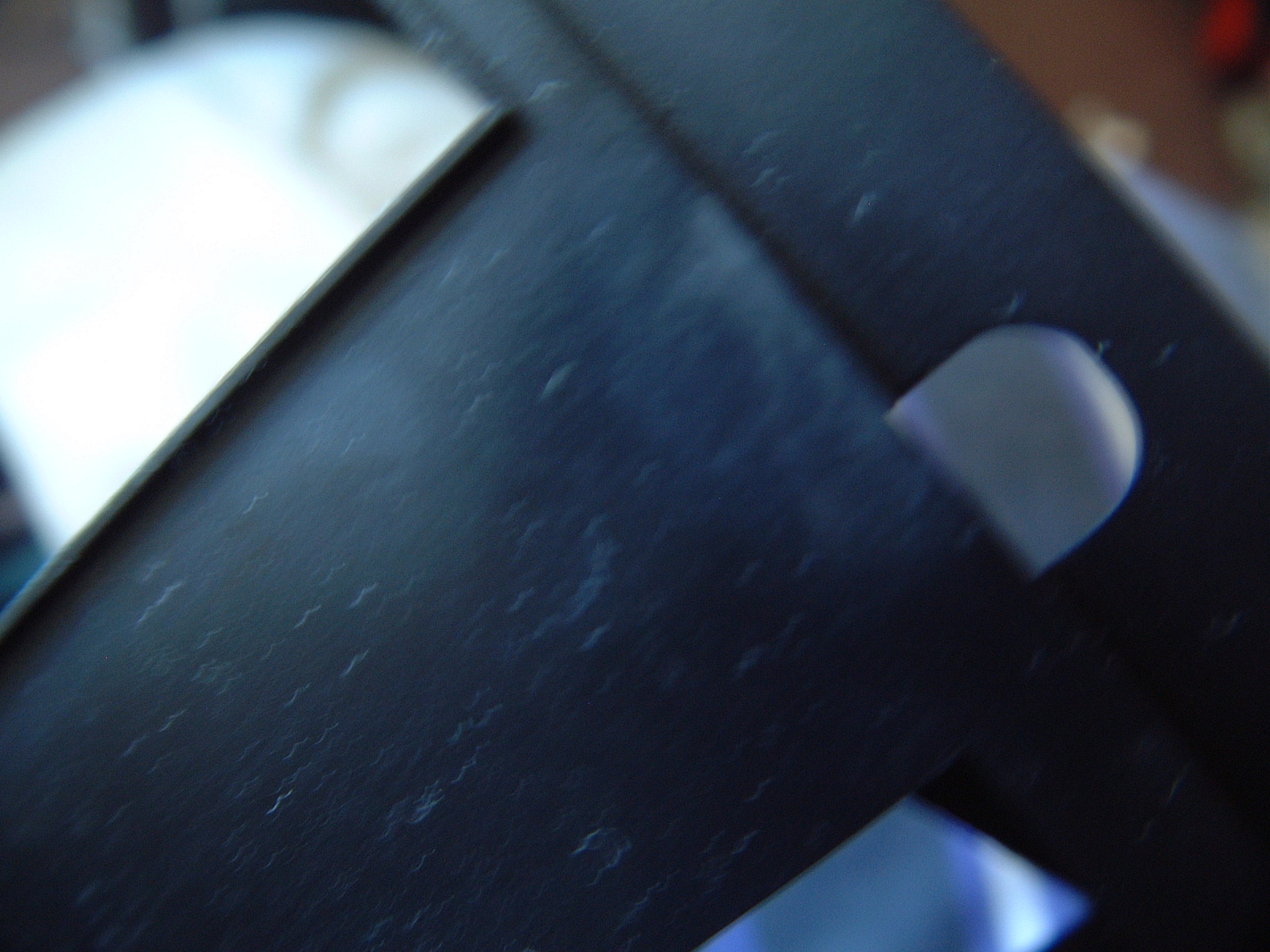

hi- i have nak 550- some of the black plastic is cloudy- i know there are many products out there- but i dont know which is best- any info appreciated
Some foam cleaners and such like can often leave a cloudy milky appearance on black surfaces.
Without knowing what has happened to yours it is difficult to say whether it can be recovered but you might surprised that the disposable make up wipes and similar actually clean such surfaces fantastically well. You can try all the usual stuff and it looks awful, try a wipe and it comes genuinely as good as new... if that is what yours is suffering from.
The usual culprit is sunlight or just old age. Almost all plastics oxidise and the long chain molecules that make them up cross link and the plastic gets brittle or, the chains break down into other compounds and 'dust' or become sticky to the touch.
A cloudy surface is a sign that the polymers have started this process. You could try sanding or polishing to take that cloudy layer off and exposing fresh plastic, but it's a lot of work with no guarantee of success. Not all plastic surfaces are purely one plastic, sometimes they are layers of different materials to combine flexibility with a harder finish that'll take a polish and be durable. You might only need to remove that outer coat. But unless you can find someone who did it successfully, you may just make a bad situation worse.
I don't know of any compounds that'll stop the decay or repair the surface, whatever they do it'll be cosmetic and you always run the risk of more problems later on as they interact with the plastic.
If I were you, I'd leave it alone as long as it's purely cosmetic...

For plastic like on the 550, I’ve used paints like those sold by SEM. They have various finishes available.
Can we see a detail picture of the surface? If a phone camera will not do it, you may have to find a friend with a camera.

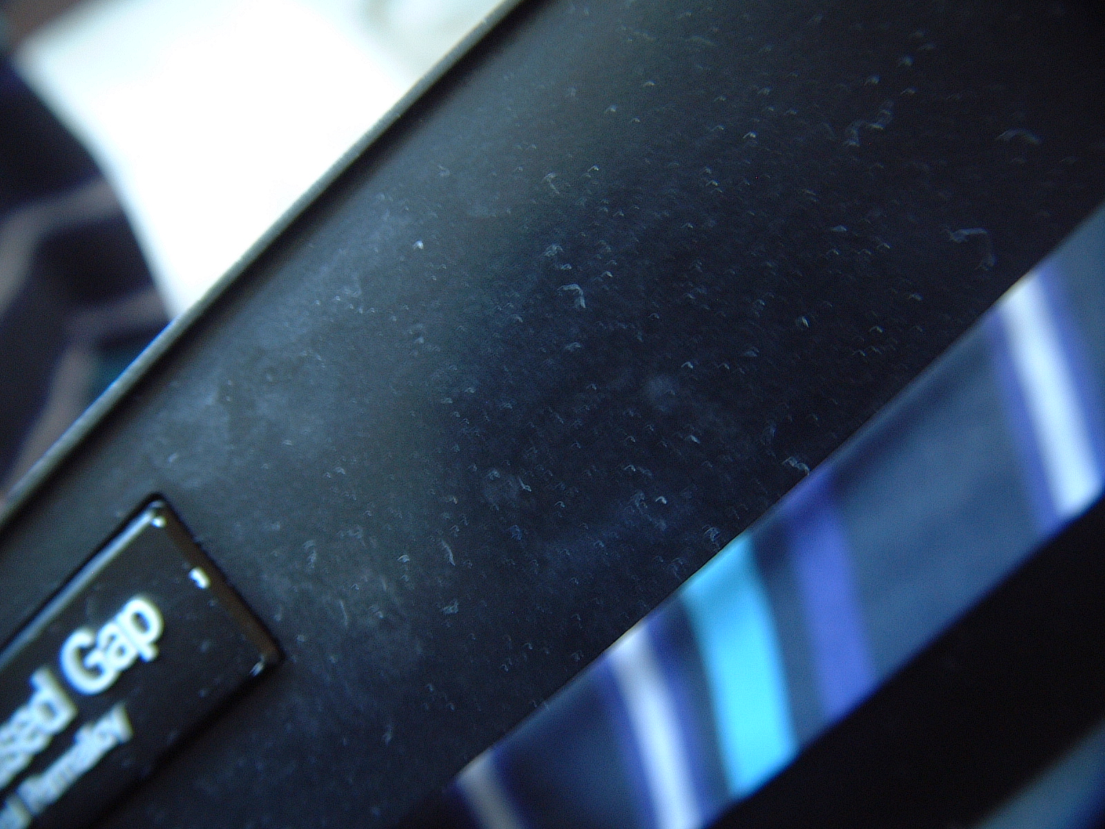

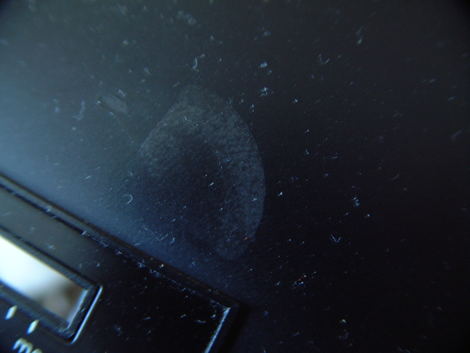

Give it good wash with liquid soap and a soft cloth.
It looks like dust that has stuck.
Then use a window cleaner with anti static properties, that will keep it from attracting dust.
Anyway before any work it needs to be cleaned.

Just wash it.
