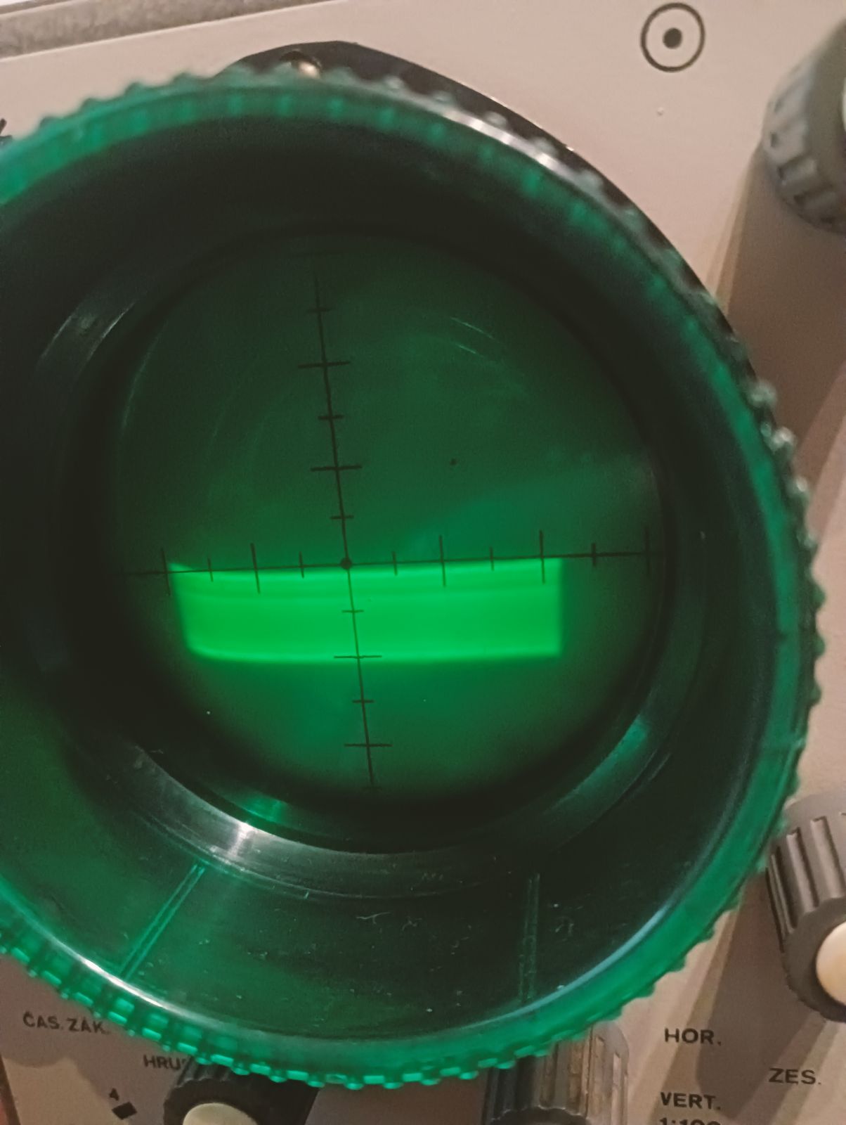

Take a scope and measure eye pattern at test point 65 (according to SM)?That how far I am now. Any Ideas?
According to internet any factory pressed cd should give you some basic understanding of the laser capabilities - i.e. do not use burnt cd-roms.
Regarding scope bandwidth - what does the SM say about us per division?
Yes, you should be able to measure it inside the player provided you can access the test point with scope probe.
This is max I can see with my "scope" on test point 65 (pin 25 of SAA7210P if I am correct).

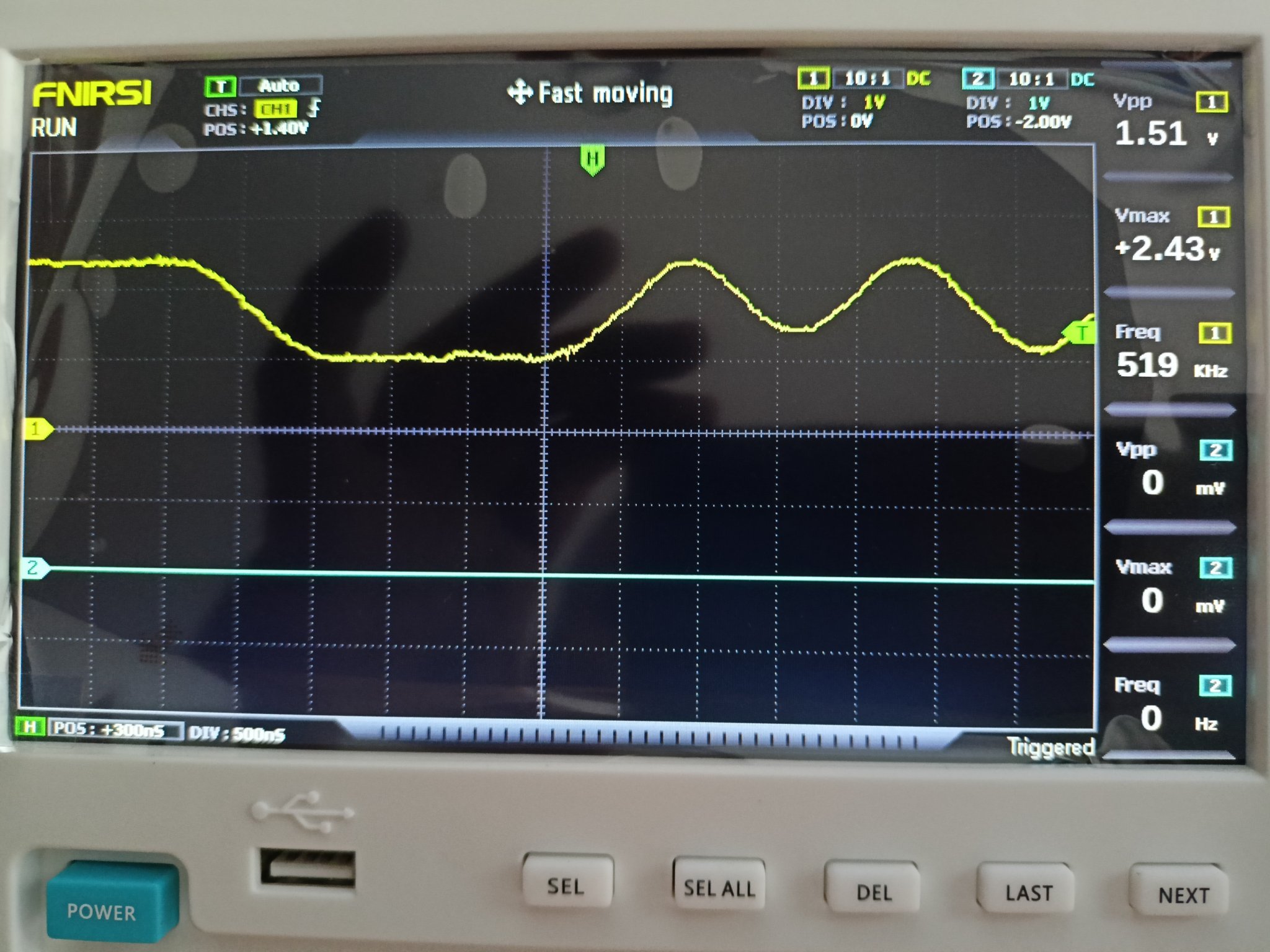

I am going to look out for a real dual channel scope as I can make no progress anymore.
What is the amplitude of the signal?
And how does it behave now when you insert a CD (and what do you see on the scope during these seconds when it starts to read TOC).?
I am currently testing an older player that reads some burnt cd-roms and does not read others. So far I have noticed that when signal amplitude is 1,2V and more (on scope) then the disk TOC gets read. If it is below 1,2V (e.g. 1,1V) then I get No Disk form the player. Signal image is similar in both cases so it seems to have to do with the later signal processing logic in the controller chip.
Factory CD gives 1,4V, service manual sets 1,7V as target.

I attached monitor to audio out (finally). Started CD in service mode and to my pleasure after switching to mode 3 I could IMMEDIATELY hear sound. Actually it started to play from cca 2m of the disc, well into first song. That corresponds with my observations of RF Eye pattern. It was always immediate.
Similar to this player:
https://www.bramjacobse.nl/wordpress/?p=12959
But I can not find any obvious reason. I lubricated the swing arm bearings and cleaned optics a bit when I was already inspecting insides. Made no change.
So good news is I know the CD player can play CDs from 2min onwards. Bad news is I can not make it read TOC.
