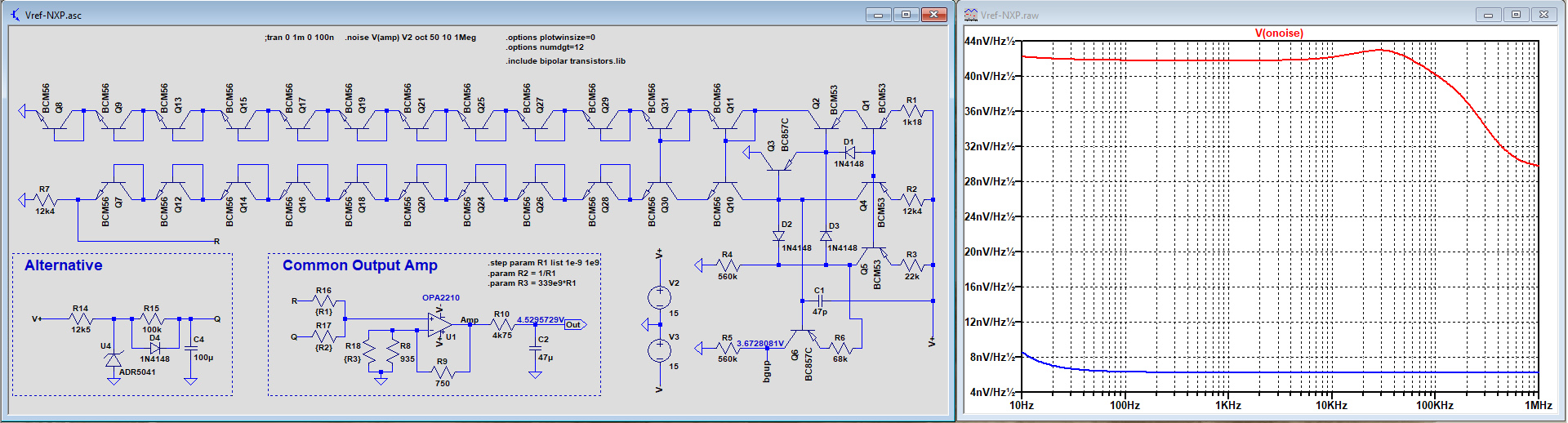

Marcel,
You don't have to add anything on your new PCB because of me.
I was just highly interested in this Vref circuit you proposed, never saw this before and to get some feeling how it performed, I just compared it to a simple alternative.
I have altered the Rbb to 120R and as you probably knew, this alters the wideband noise at behind the OPA2210 not that much compared to the ZTX transistors, from 32nV/rtHz to 42nV/rtHz up to 100Khz, quite remarkable.
The image below shows the noise directly after the OPA2210 still before the 4k76 and 47uF filter, giving a better view on things.
Red is for the bandgap solution and blue for the ADR6041.
Hans

OK Mark, the next version will be DAC3_4.pdf then.
I just looked up my calculations and I calculated 9.4224 nV/sqrt(Hz) at 27 degrees before amplification by four with the NST45011 base resistances. 42/4 = 10.5, so the calculation and simulation are close.
With no base resistance at all I calculate 6.2625 nV/sqrt(Hz), so that's not that close to 32/4 nV/sqrt(Hz). The differences between the squares of the simulated and calculated values are about the same in both cases, though: 21.468E-18 V^2/Hz or 24.781E-18 V^2/Hz, 9.358E-18 V^2/Hz of which is op-amp voltage noise and feedback network noise.

There were a couple of calculations I still needed to do, like calculating the correct value for the upper left resistor in the bandgap and calculating the dynamic current drawn by the digital parts when the input signal is a 27 Mbit/s bitstream. It turns out that those currents are a lot higher than I anticipated, so I have changed the circuit as attached. Meanwhile I'm also working on a PCB.
