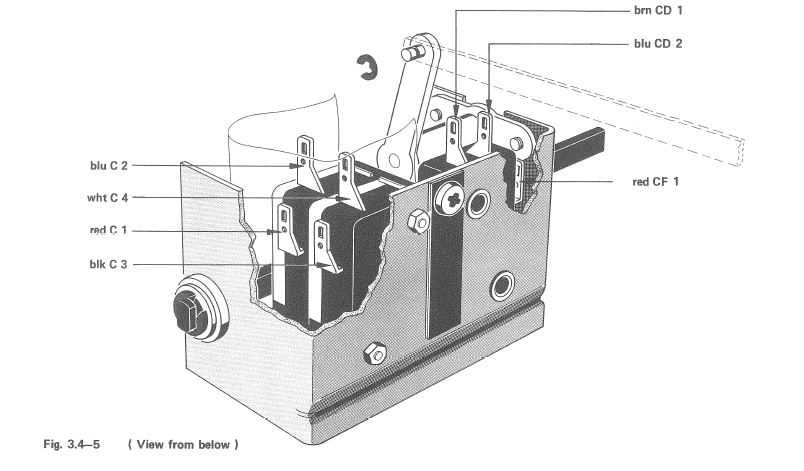

I'm no expert, but pointing it out can't hurt - I'm looking at thre different service manuals (edition 3/7/10) and they all show the following wiring of the power switch:

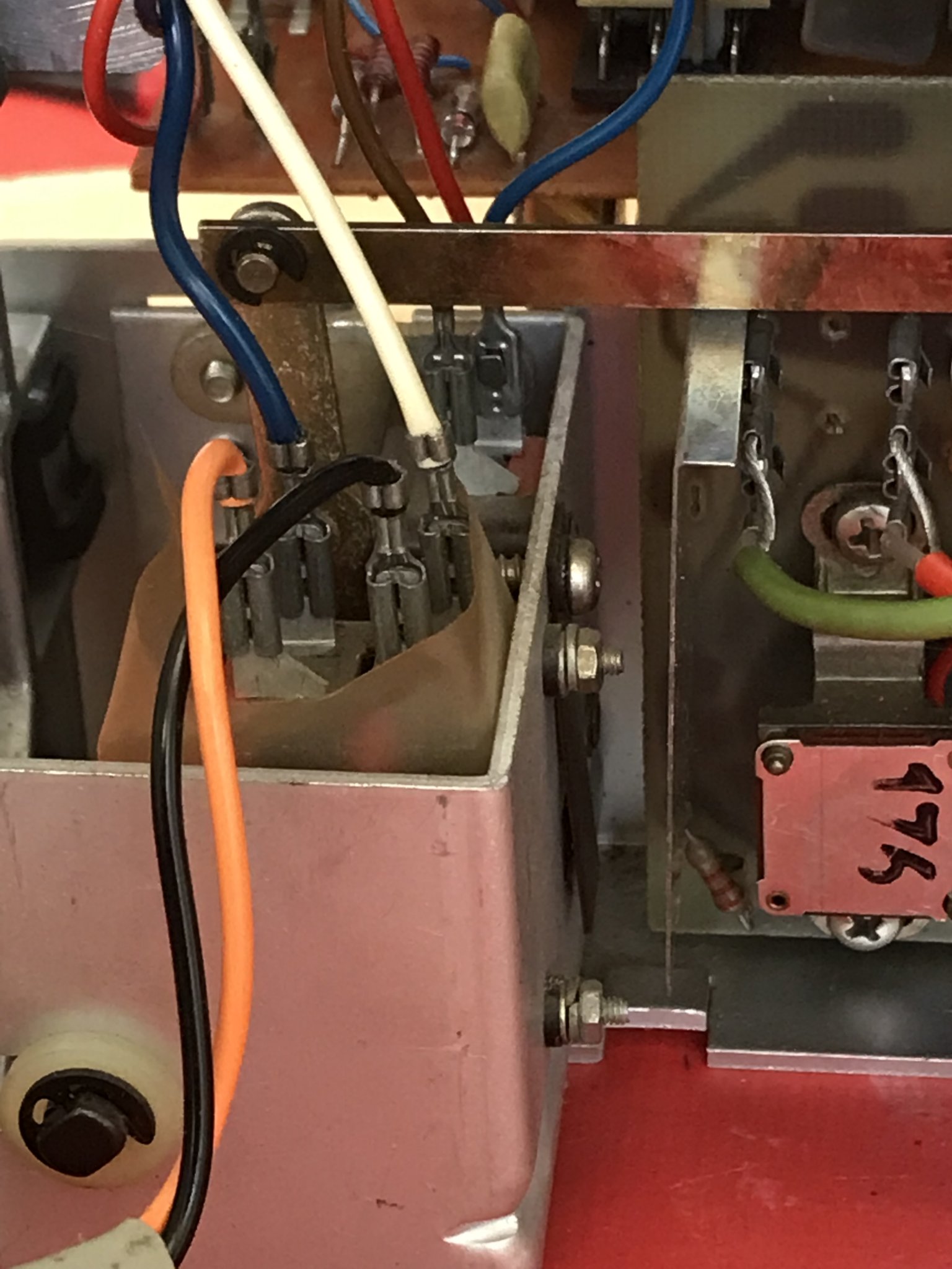

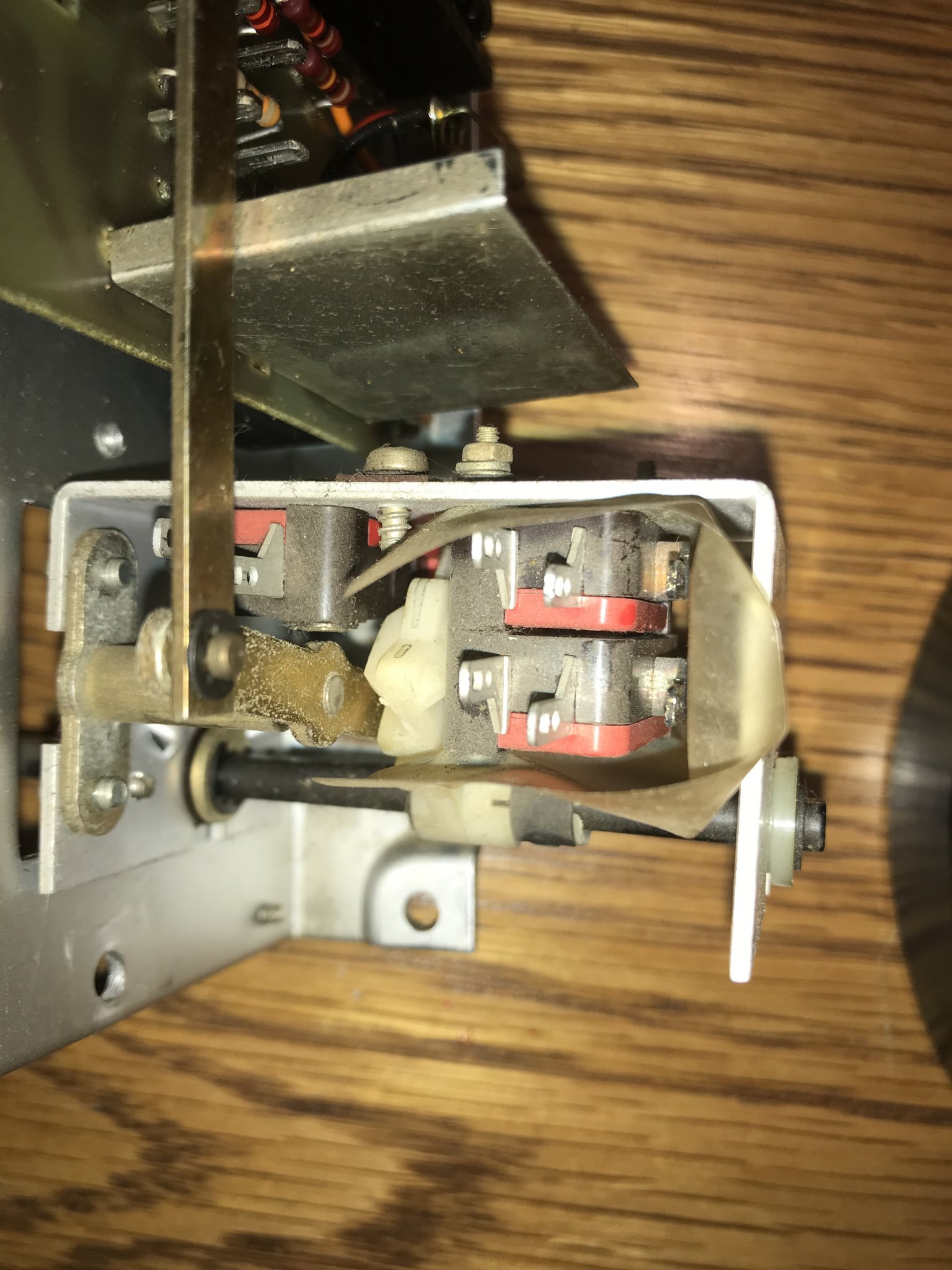

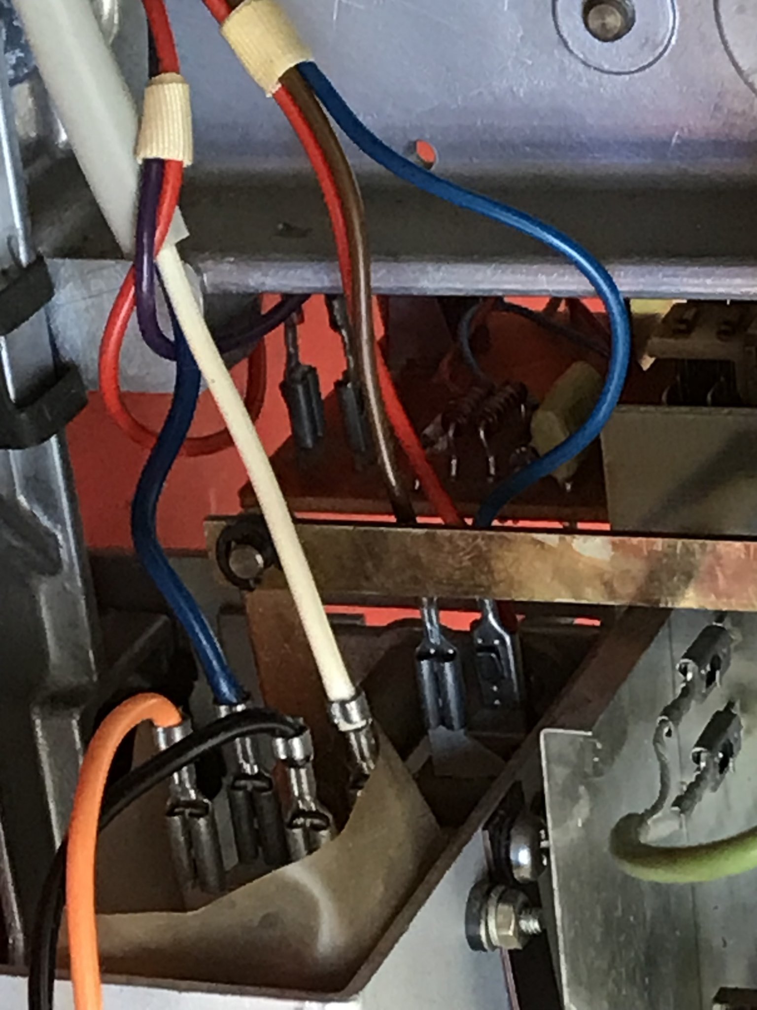

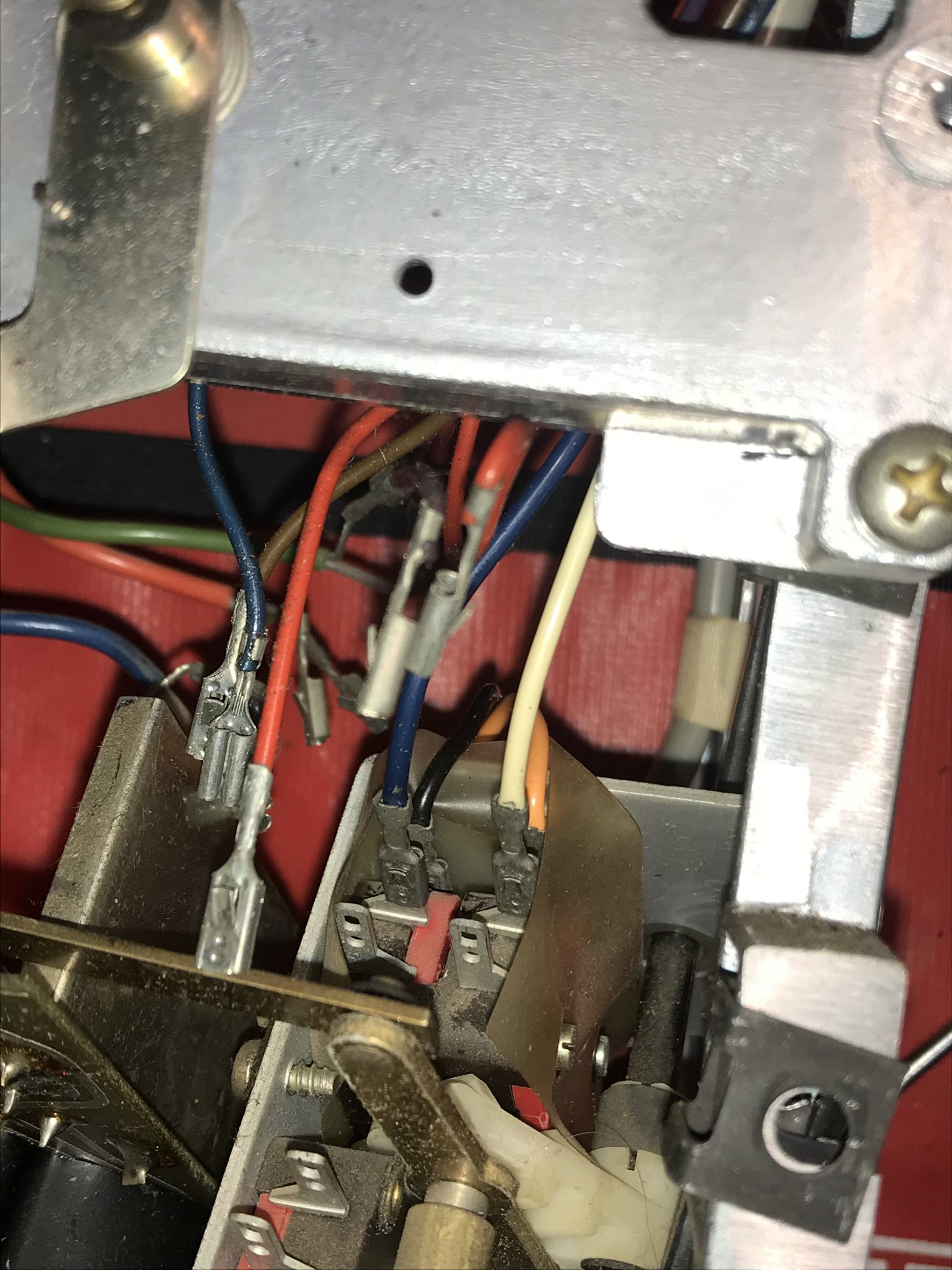

Yes, I am aware of the illustrations, but have found the manual can be deceiving. Some switches come with four pins (as per the manual, and others come with six pins I.e 3x 2 pairs.
Only when the switch is viewed vertically, can the rear lower pair be seen. Attached are pics of the switch in my a77 mklll.
Then there is the protective plastic like sheet surrounding the terminals….
I hope this will prevent any diyers from making the same mistake.

Hi all - just to update this thread.
Since correcting the switch wiring, the power problem is solved. Heads were meticulously cleaned, then cleaned ... and cleaned again!
