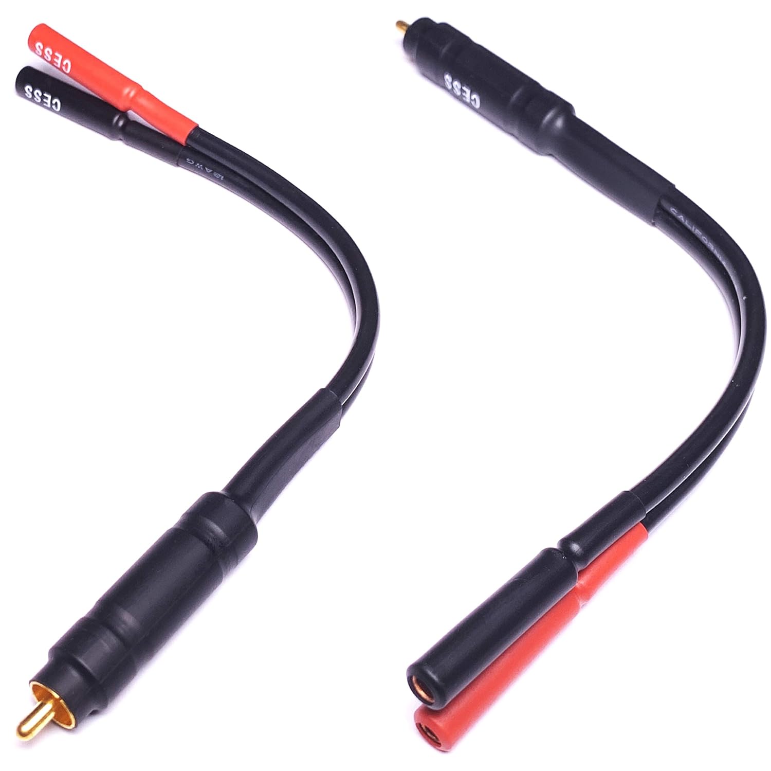

Then, once you've sorted all the wire, you could possibly use something like these to change them over to RCA connectors if you don't want to solder them.

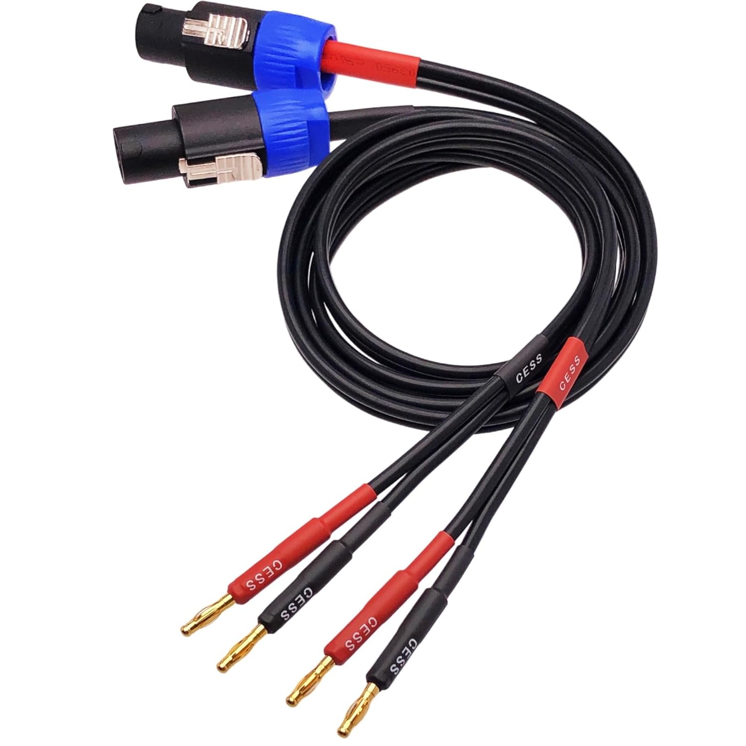

Maybe you can use RCA Male Plug to Banana Female Jack Adapter and Banana Plug to Speakon Speaker Cable for connections.

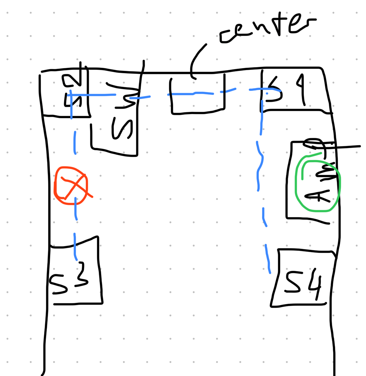

The equipment is: 4x Pioneer SP-FS52s, a Pioneer center and an B&W ASW-3000 sub. Amp is a VSX-933. The wiring diagram is as follows:
Red X is where the last amp was, so the SpeakOn wires converge there. Green is where I need it. I’ve looked into the speakOn connectors sitting at S1 (there are two cables there) and they both have 4 wires each. The amp needs an RCA connection.
If my understanding is right, I might be able to disassemble 2x SpeakOns sitting at S1, and use it to create 4 speaker channels. I would cover S2, S3 and S4 (I can’t do amp->S4 because of a passageway), and use the remaining 2 wires in the SpeakOn to convert it to RCA using an adapter that I would use for the sub. S1 and center would be handled directly to the amp.

Not sure if using speaker cables to send a line level signal to the subwoofer is a good idea.and use the remaining 2 wires in the SpeakOn to convert it to RCA using an adapter that I would use for the sub.
+1 for the adapters. SpeakON is good stuff. Don't wreck something good. I use speakON connectors on everything I build.
