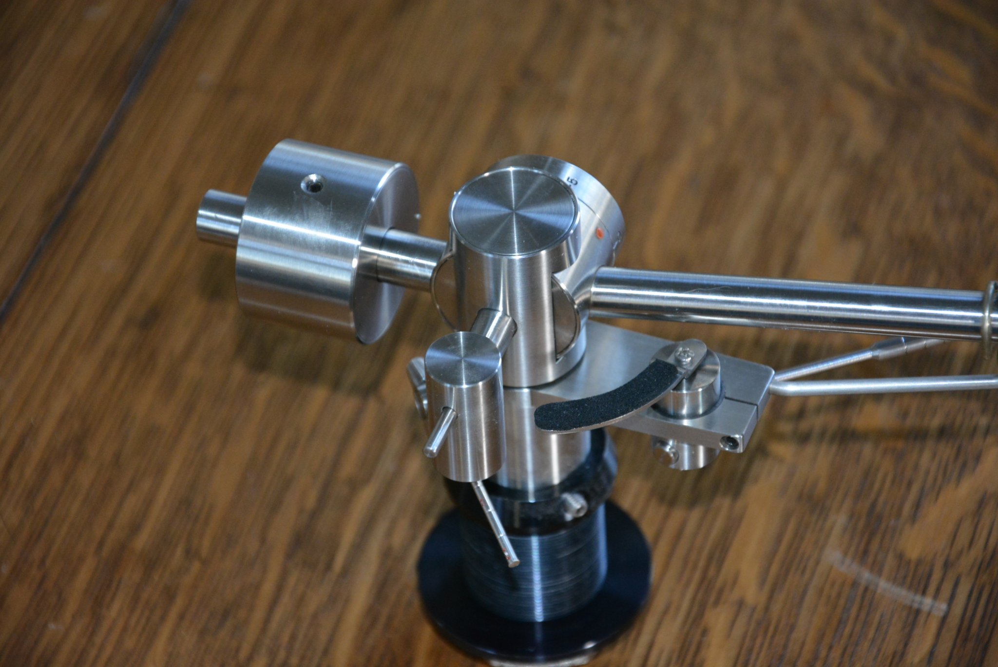

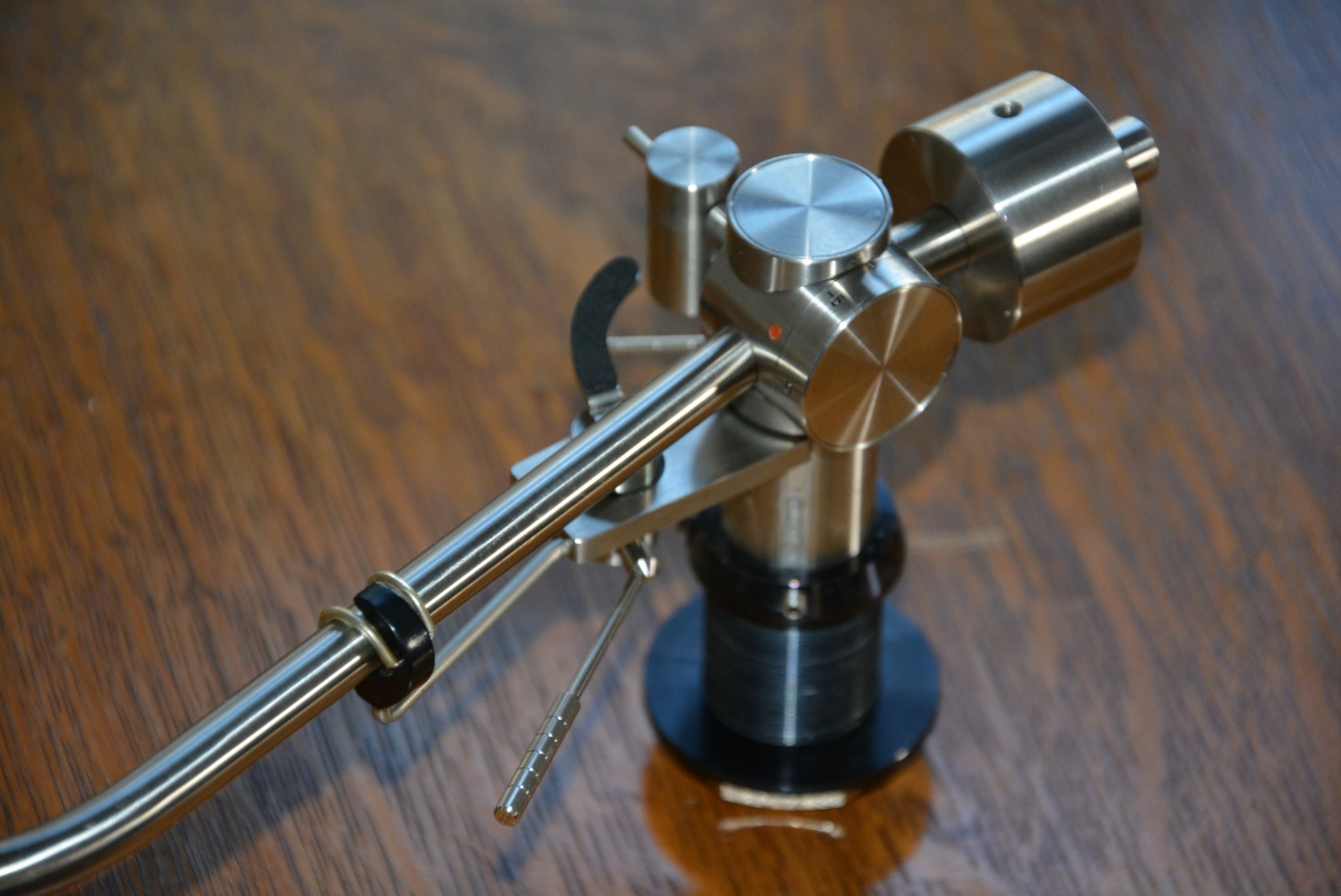

I just received a Fidelity Research FR-64s. I'd like to rewire it. I've done some research on the web but I can't see the way to disassemble it. It appears from photos on the internet that the cap on the dynamic VTF knob must come off but I don't know the trick to remove it without damage. Any guidance will be most appreciated.

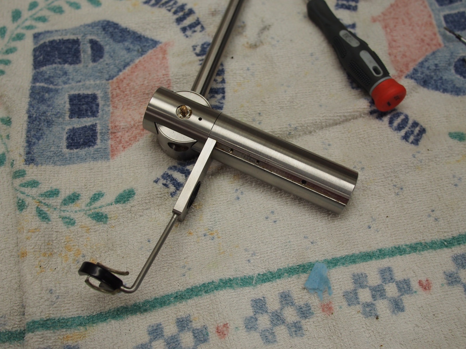

  • remove the rod on which the lateral balance weight attaches - simply unscrews (protect finish with leather jaws)

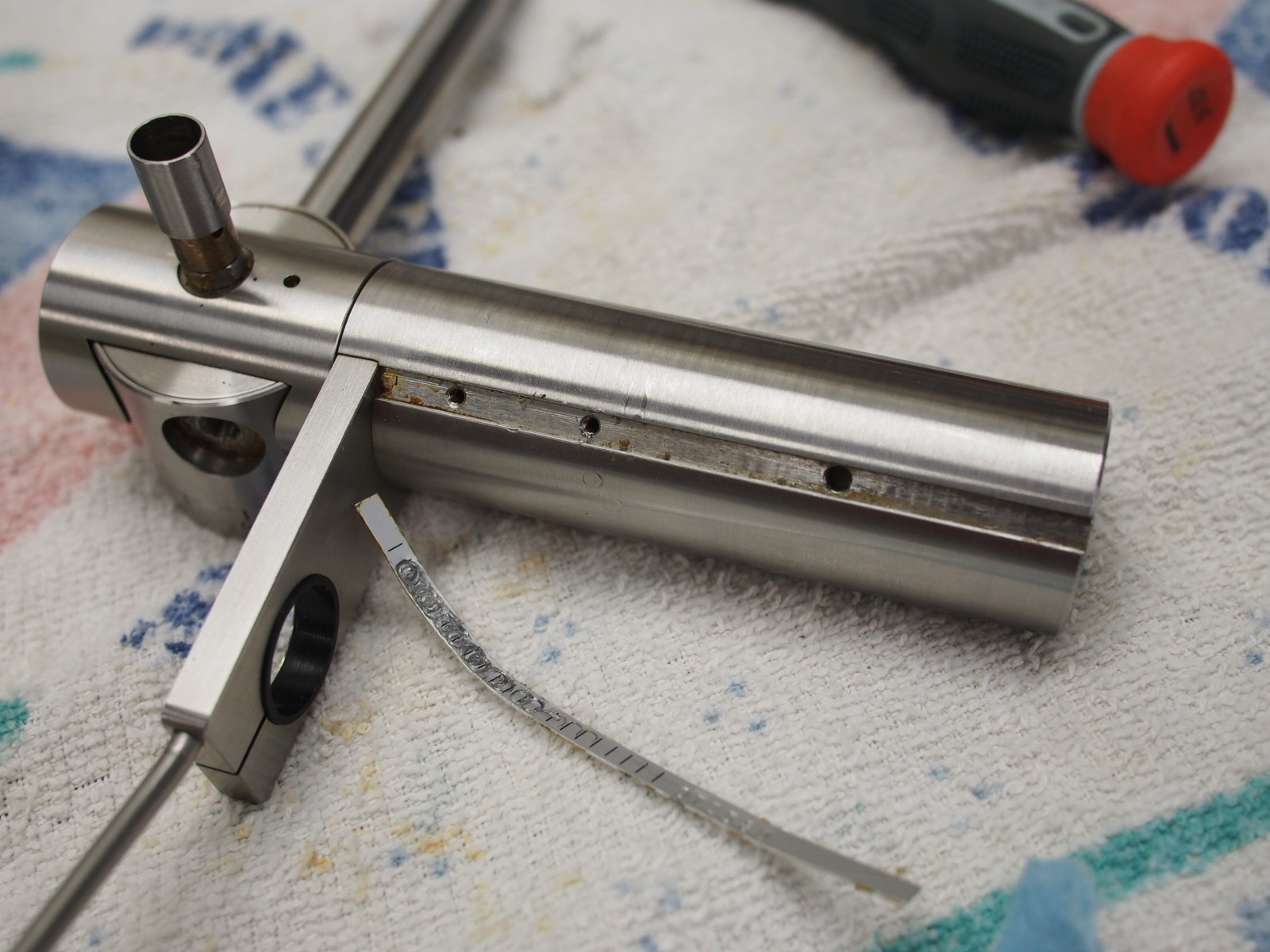

  • remove the stainless collar around the place where lateral balance rod threads - this is just glued but be careful not to scratch
  • remove threaded collar. this photo shows the collar sliding off and the brass collar beneath. the brass collar unscrews using a pin through the 2 holes you can just see in the photo
  • the photo also shows the trim removed from the slot in the pillar.

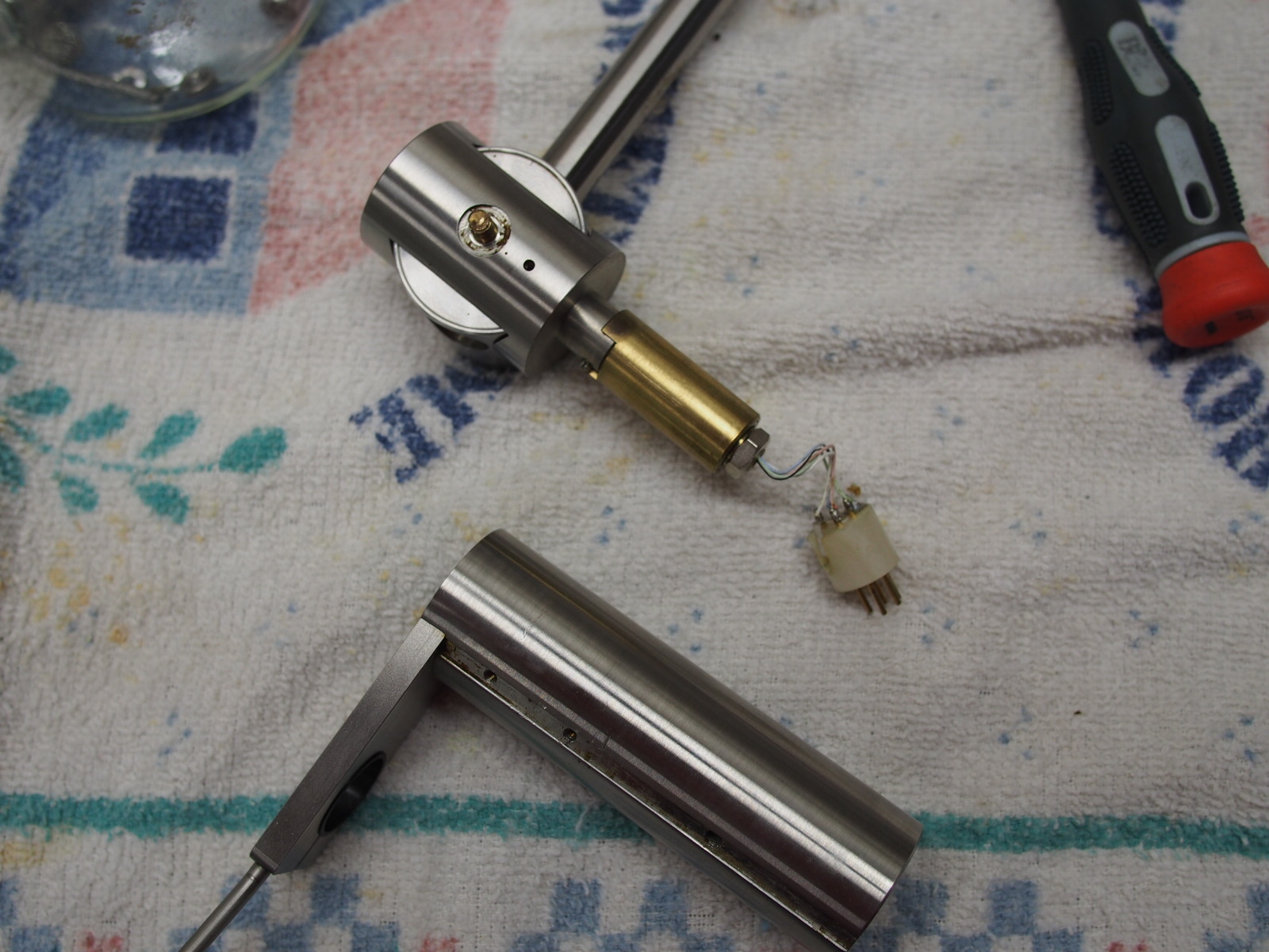

  • after threaded collar is removed you remove the nut. this requires a small metric wrench and even smaller wrench to hold the flats on the shaft that protrudes from the body - below you can see the nut removed and before the balance assembly is removed from the pillar
  • next I removed the 2 setscrews in the pillar (under the trim piece in the slot). top 2 are for arm pivot and bottom one is DIN. The outside of the pillar will slip off as shown: (by the way, these setscrews were slotted and very difficult to remove). I replaced with hex-head setscrews - they're a standard metric size

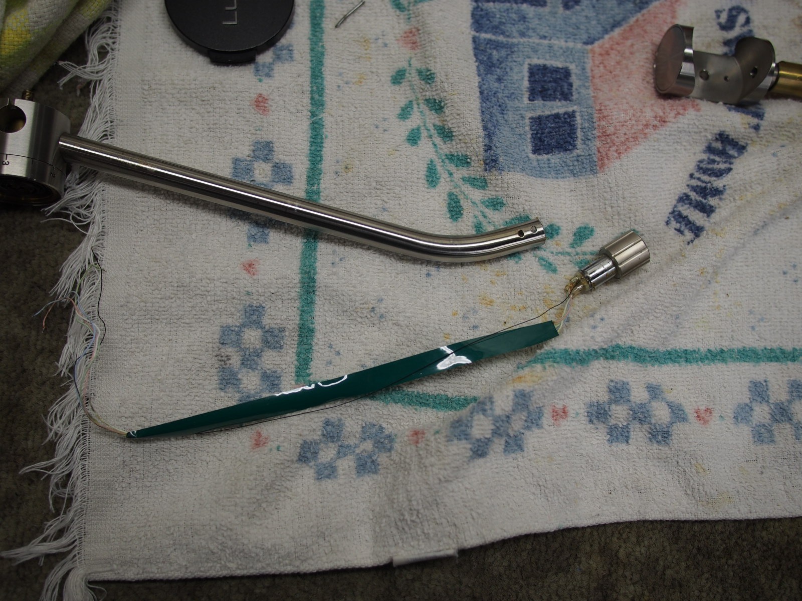

  • at this point the wires will still be connected from headshell fitting all the way thru to the DIN. I just cut them at this time and separated the wand/balance assembly from the pillar assembly
  • next the balance assembly can be removed from the body. Note that some of my photos have gone missing, sorry. I'll insert them if I find them.
  • the wand and balance assembly includes the rotating knob which controls VTF. You can pop off the cover on the knob to access the mechanism (it's just glued. I drizzled some acetone into the knob to help loosen the cover plate and pried off with small knife blade.
  • then I soaked the wand/balance assembly in acetone to clean old grease and bearing oil
  • next I removed the headshell connector and rewired - feeding from headshell end into wand and through
