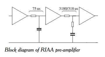

Thank you Merlinb,
however you confused me somewhat when you wrote:
in short, with a relatively low mu tube should the 75us section come first as in the attached block diagram or the 3180us section ?
because it is not clear to me to which case "the latter" refers to ...For split EQ you have to choose between using low-pass in both sections, or high-pass followed by low-pass (or in the opposite order). The latter has the advantage ... .
I was referring to this sort of EQ:Thank you Merlinb,
Usually you would do it as shown, because the Miller capacitance of stage 2 neatly blends into the 75us capacitor. Since stage 3 is presumably a buffer, it has very little capacitance to worry about.in short, with a relatively low mu tube should the 75us section come first as in the attached block diagram or the 3180us section ?
Doing it the other way around has a headroom advantage because everything above 50Hz is attenuated by up to 20dB before hitting the second stage, but Miller capacitance then affects EQ accuracy.
It seems that the split EQ 3180/318us first and 75us last works best for me. Lowest noise and way lower distortion than the other way around.

From my experience, the best solution is not to split the passive RIAA.
Because when you split, you must have 3 gain blocks: if left with just 2, you must think on how to avoid the buffer stage (i.e. cathode follower) or just the pot of the line preamp which follows it - not to interfere with the precision of the equalisation.
If you choose to have 3 gain blocks, the basic problem is that whatever is introduced by the 1st tube will be amplified by all the others... you will need to select for noise and micro-phonics... which is sometimes impossible because you do not have enough tubes to start with - or the level required cannot be achieved with the tube type chosen.
Thus, prefering 2 gain stages - I opt for composite RIAA as well. Willing to reconsider?
