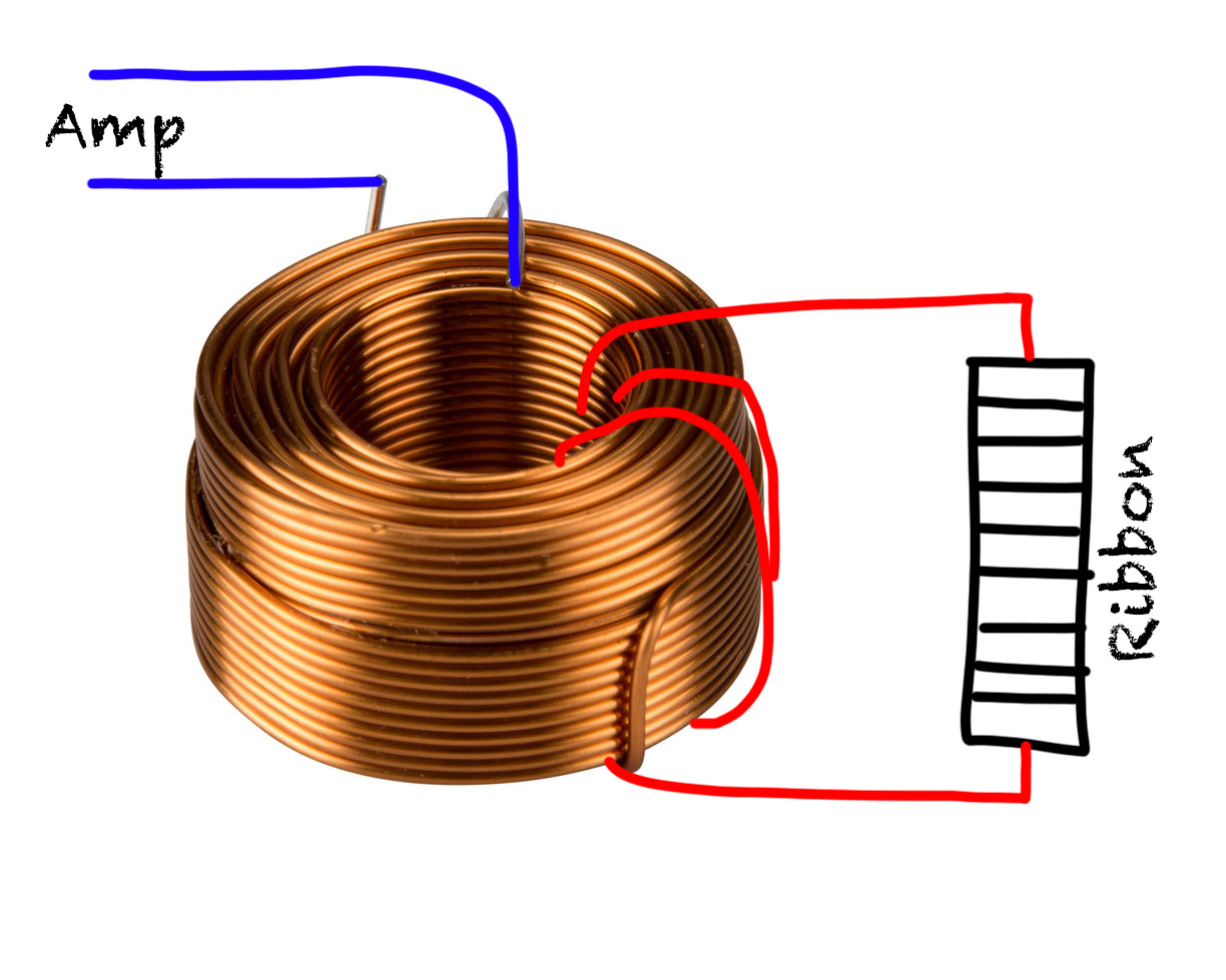

Looking at this website... http://hyperphysics.phy-astr.gsu.edu/hbase/magnetic/refload.html I can see the equation for reflected impedance (resistance) at the bottom which says.... R x (number primary turns/secondary turns) squared. So a 20:1 transformer with a 0.01 ohm ribbon gives a reflected impedance of 4 ohms. Am I right so far?
If so, a transformer would need to be made with a 20:1 winding. So you could do 20 on the primary and 1 on the secondary or 40 and 2 or 60 and 3 or 80 and 4 etc. The primary winding would be a very low impedance I would imagine, so does the high pass capacitor need to be calculated on the resistance of the primary winding or the reflected impedance that will be 'seen' by the amp.

0.01 ohm... It will be difficult to make the winding resistances much smaller than the loudspeaker resistance.
If you don't, the input impedance increases by the primary winding resistance plus turns ratio squared times the secondary winding resistance. Some of the input power will then only heat up the transformer.
When you have a capacitor between amplifier and primary winding, you could dimension it such that it forms a second-order Butterworth or Linkwitz-Riley high-pass with the magnetizing inductance and the reflected load and winding resistance. The thing is that the magnetizing inductance is inaccurate and quite non-linear unless you use an air gap in the transformer core.

So, if a transformer was made using 0.5mm diameter wire around a transformer core which was 100mm long per turn and there were 40 turns, I would have 4m of wire, which is 0.34ohms on the primary. If there were 2 turns on the secondary (200mm of 0.5mm diameter wire would give 0.017ohms) and we have a 0.01ohm ribbon, giving a total of 0.027ohms of resistance on the secondary. With this being a 20:1 transformer, we add the primary resistance of 0.34ohms to the turns ration squared x secondary resistance (0.027). So 0.34 + (20 squared x 0.027) = 11.14 ohms.
So would the amp 'see' 11.14 ohms when driving the ribbon speaker? What would happen if the ribbon broke and open circuited the secondary? On a power transformer, the current on the primary increases when there's a load on the secondary, so I assume it's the same here.
I assume 11.14ohms is the value that will be used in determining the values of components for the high pass filter for the ribbon speaker?

Your calculation is correct. The 11.14 ohm would be in parallel with the inductance of the primary winding of the transformer.

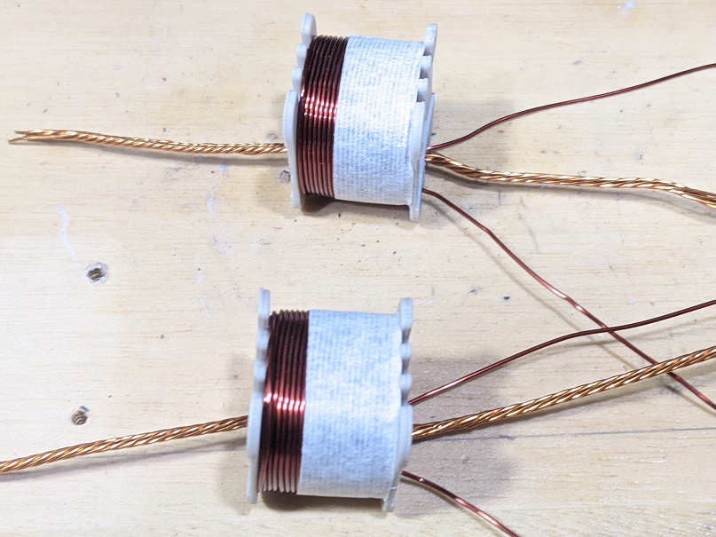

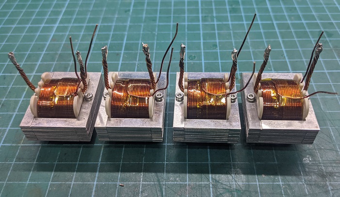

For primary, u need to parallel a few enamel wire to create the low DCR. For my ribbon tweeter transformer I uses Litz wire which are individually enameled which made winding much easier to do.

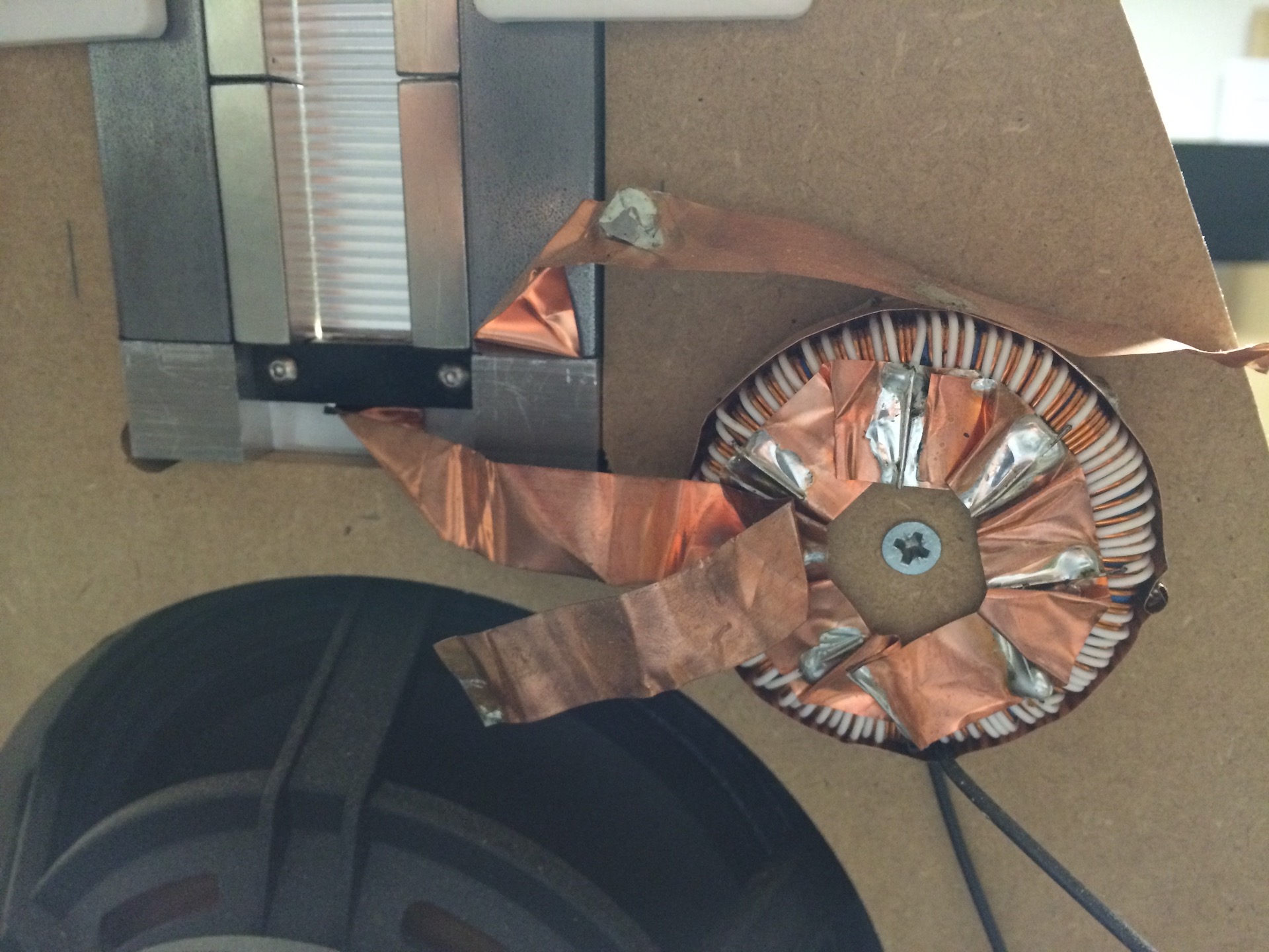

First thing you want to know in with frequency range you want to use the ribbon.
If its for high frequency only you can use something like B64290L0040X830.
I fill it compleet with 1mm wire and calculate the secondair winding lets say 3 windings.
Then wind as much as possible the secondair windings and put a pcb with 2 rings or thick copper wire.
Rob
