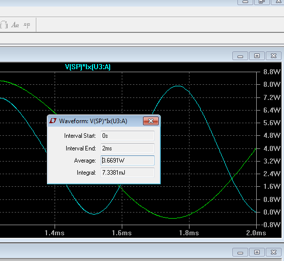

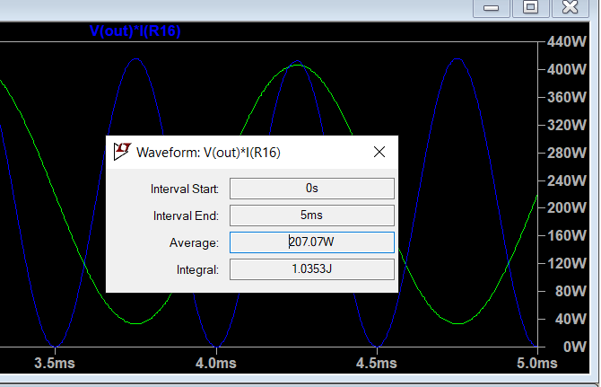

This works well for a voltage or a current over time.
In your RMS(v(OUT)*i(RL)) script LTSpice you force LTSpice to apply the same integral to the product of voltage times current over time and this is undefined or just meaningless.
Had you simply multiplied the RMSs of voltage and current: RMS(v)*RMS(i) the result would have been the correct one.
By the way there is an alternate way to get the average power:
- run a transient analysis
- hover the mouse pointer over the load (can be anything, Resistor, Transistor, Tube ... actually any power dissipating element) while holding down AltGr
- now left click when you see the thermometer icon pop up above this element
- this displays a curve of the power dissipation over time
- now while holding down AltGr again right click on the power formula on top of the display window which pops up a window with the correct average power
- the power formula can be simple in case of a resistor or quite complex in case of a pentode in which case it includes plate, screen and grid disspation.
