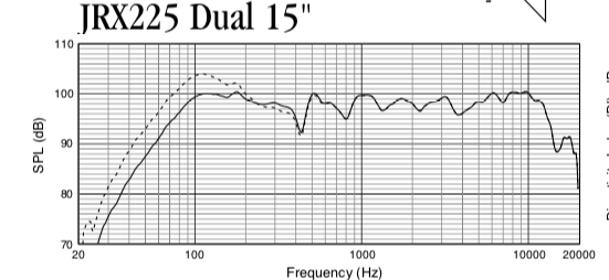

I have access to several power amps and looking at some speakers for use as MAINS for my band. Speakers I'm looking at are JBL JRX 225 rated at 500 -1000 watts @ 4 ohms and Peavey PV215 rated at 700 watts program, 1400 watts peak @ 4 ohms. The amps are QSC types; GX5 and RMX 2450 which both can drive 700 watts @4 ohms.
None of the JBL or Peavey ratings make sense to me so would I have a problem driving either of these speakers with these type amps? BTW, I'm not going to ever drive these amps to max.
Brent,
The amps shouldn't be a problem.
The JBL JRX 225 roll off below 100 Hz. The low "E" on a guitar is 82Hz, low "E"on a bass is 41Hz.
If you were driving the amp to half power, 350watts, and adjusted the low end of the guitar up just +3dB, it would hit 700 watts.
Forget about flattening response below ~80 Hz, the speakers will just flap.
If you were to try to flatten it's -10dB response at 60Hz with EQ, the amp would use 10 times the power as at 100Hz.
Say the amp is cruising along at 1/8th power, 87.5watts, add +10dB =875 watts, the amp is overdriven (clipping) by 175 watts.
The GX5 "GuardRail™" circuitry, not so much.
