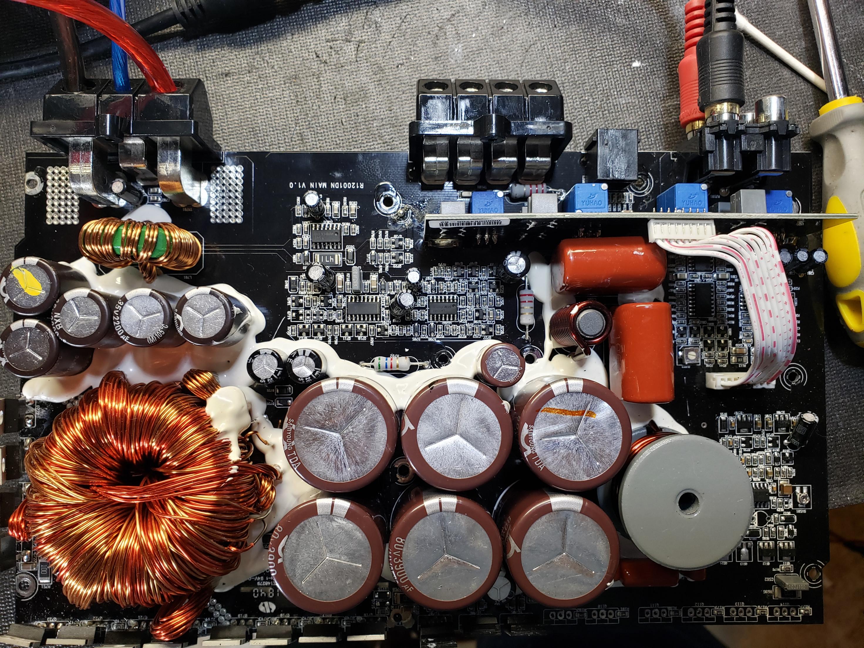

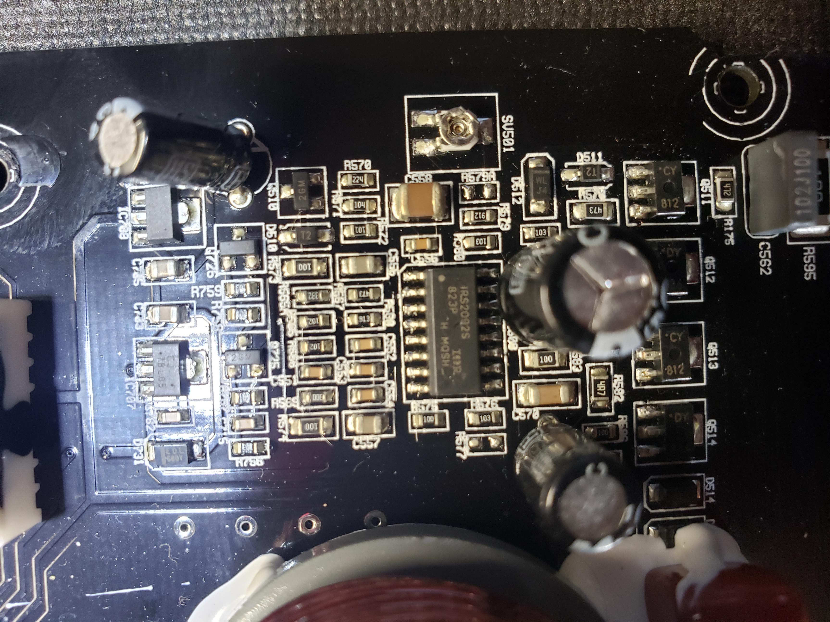

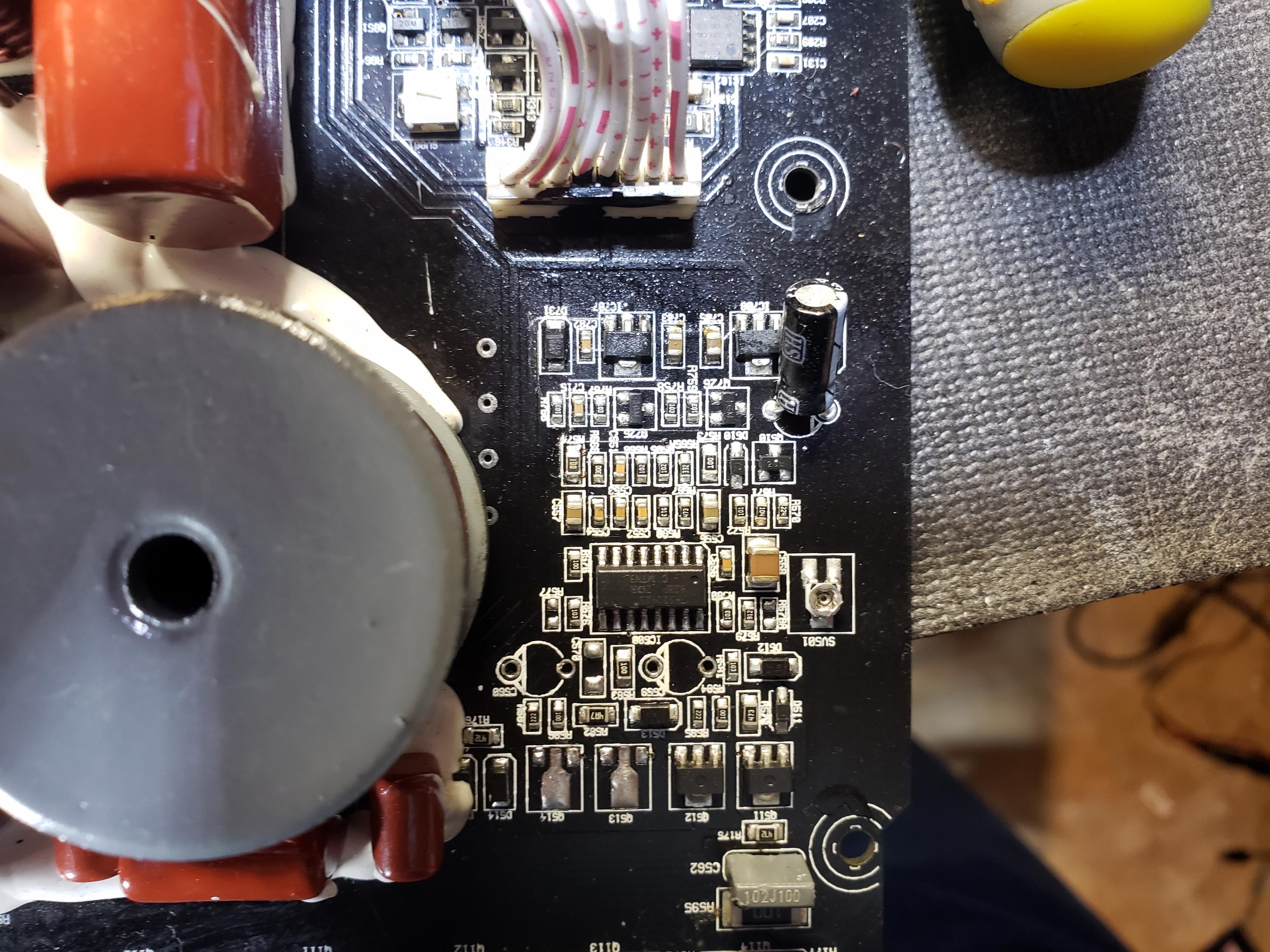

Looking for a little help on this Rockford Fosgate R1200.1d V. The amp is in protect. I have pulled the outputs. I pulled 2 drivers (low side) because I had 23 ohms between gate and drain of Q513 and Q514. I pulled the IRS2092 and the 23 ohms went away. So I replaced the IRS2092. But soon as I applied power the 2092 went up in smoke. Fixing to pull the IC again.

Voltages on the IRS2092 ref to power grd. This is a new chip. I am not sure what the voltages are suppose to be.
01: 5.1
02: 0
03: 0
04: -4.9
05: 0
06: -4.9
07: -53.96
08: -53.96
09: -59.14
10: -59.2
11: -59.2
12: -59.2
13: 1.97
14: 1.97
15: 13.8
16: 7.53
