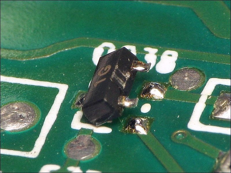

Is there a Q703 that has its emitter connected to pin 14 of the 494 and its collector connected to pin 4 of the 494?
Q: Is there a Q703 that has its emitter connected to pin 14 of the 494 and its collector connected to pin 4 of the 494?
A: You are 100% correct.

The diagram I'm working from has only inverting inputs connected together, It appears that 7 and 8 on your 339 are connected together. Do you read 0 ohms between them?
Lift that transistor and power up the amp. The amp will likely power up without remote so start watching it as soon as you connect B+. This will disable all protection so, if you have a current limiter, use it.
It would be better to do this with all FETs clamped tightly to the heatsink until you see what the amp does when you power it up.

I don't think the 339 is involved. All of the outputs are the same as they were when you posted the other voltages.
The jumpers you used are better than making individual jumpers but the type recommended for the JL amps require no soldering. They are item #14 on the TT5 page if you missed them.
I think you'll have to lift the transistor and repeatedly power cycle to see if anything every fails to work properly. That may indicate whether the problem is with the audio circuit or with the protection circuit.
