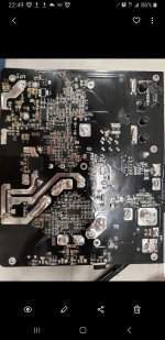

Can you post a good quality photo of area around the diodes?

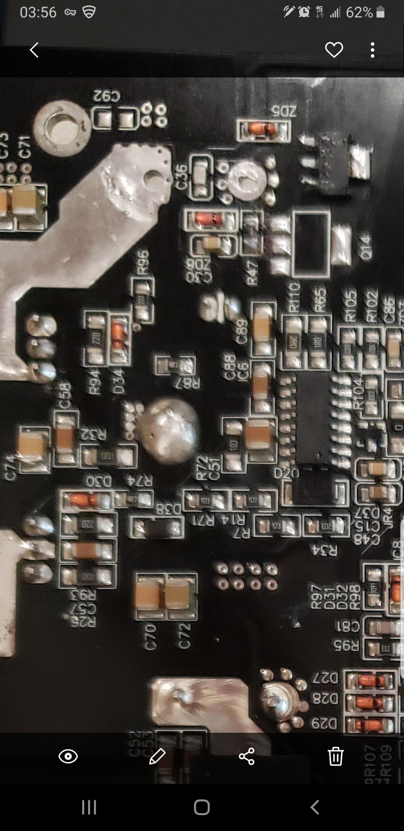

Why do you think the non-zener diodes are defective?
Did the outputs fail?
Yes there was one blown output, and 2 blown rail caps, a the driver that is in the picture a BCP56, the zener is shorted and a resistor is burned crispy.
The diodes test shorted, I checked to see if they were in parallel with the resistors around them, they are not.
OK. Well, I don't have anything similar that doesn't have those diodes in parallel with resistors, Actually series with a resistor and those two in parallel with a resistor.
