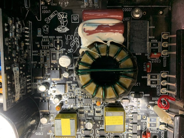

Hello can anybody help with schematic for this amp ? I have C2016,C2017 blown and not sure what size mylar capacitor is needed. Also L2000 is burnt If anybody can point me in the right direction for schematics and also where to purchase parts that would be awesome.

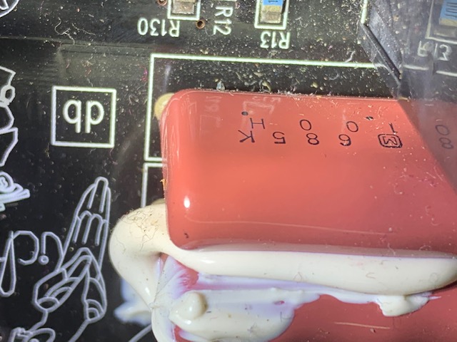

The caps are 6.8uF at 250V
I'm not 100% sure on the voltage. Measure and confirm that the 250v will fit.

Thanks for the picture goviboo. What would cause the caps to explode like that? could it have been the inductor is just burnt from the caps, any ideas? It looked pretty bad, but after cleaning all the magic dust the PCB is extremely fire retardant. Thanks again y'all for all the info I turned it on yesterday with a PSU and it seems good on the power side. I have removed the caps,inductor, and the legs from the caps that blew up. monday I will be ordering the mylar caps if thats the only part I can find to order.

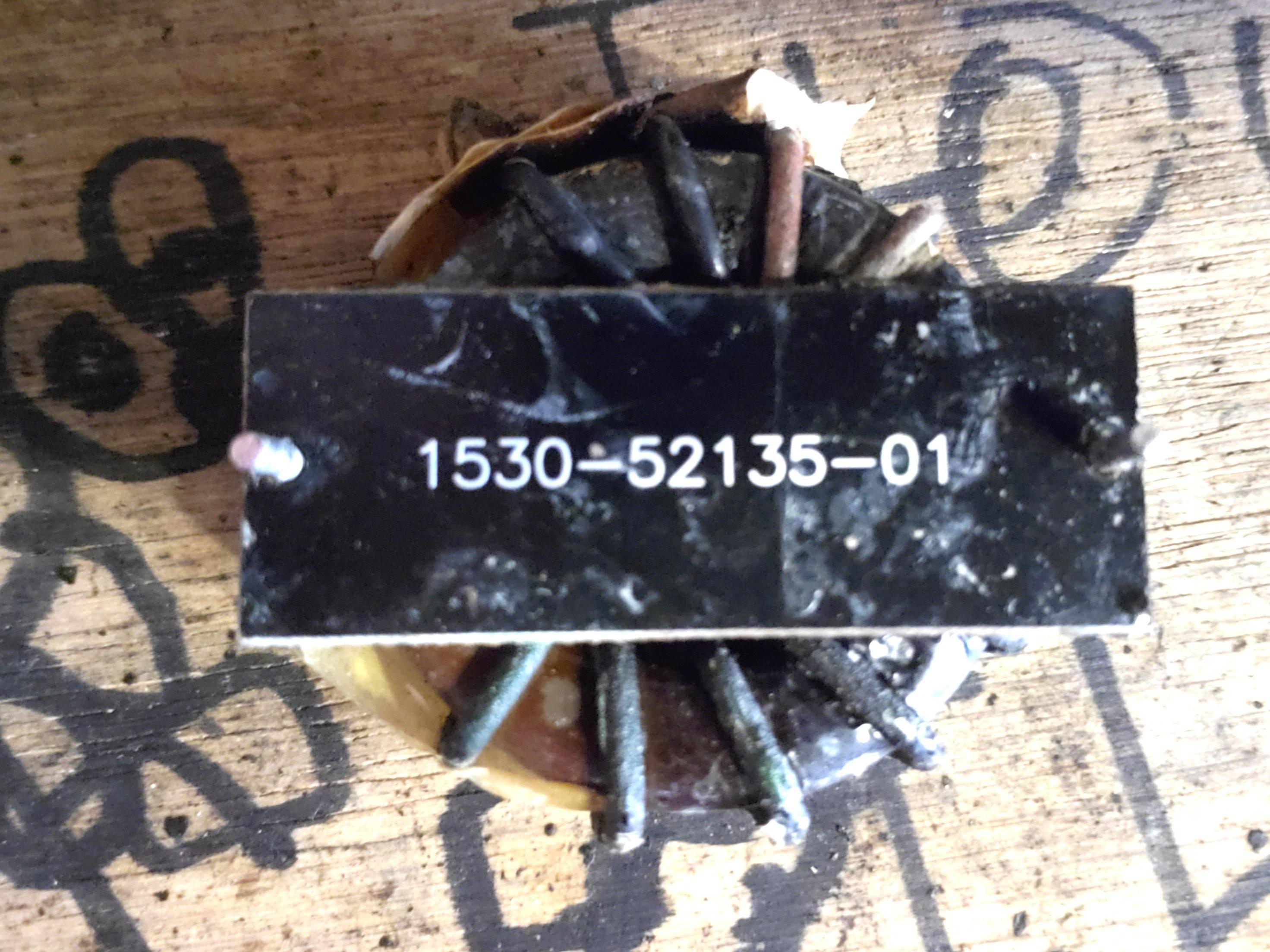

Did the inductor actually burn or was it simply covered with soot from the caps failing?

inductor looks like it had fire on it the caps only had pins/legs left in the board from the caps so they exploded.
Post a good quality photo of the inductor.
Does the enamel look like it's starting to lift from the copper anywhere?

It needs to be rewound. Is the coating flaking off of the core?
If so, if you try to read the resistance across the bare core material, does the meter read infinite resistance or something lower?
If the core didn't get too hot, you can wrap the core in an insulating tape (mylar, kapton, not electrical tape) and then re-wind the copper.

What usually causes something like this to happen is it user error or is there is a short deep within?

This is a bit like... which came first, the chicken or the egg.
The caps could have failed causing the inductor to overheat or the inductor could have shorted driving too much of the carrier into the caps, causing them to fail.
