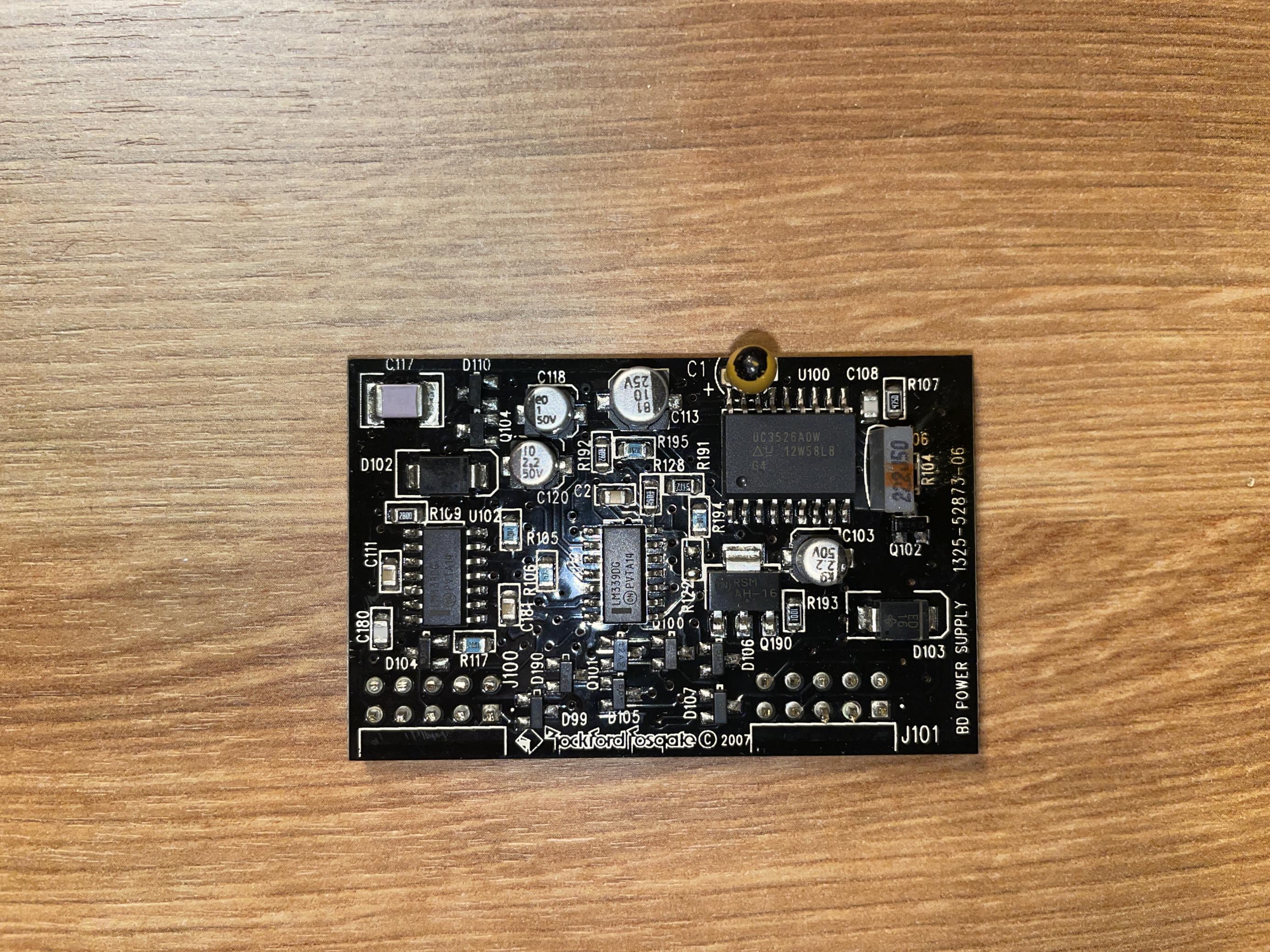

Working on my RF T1500, seems to be an issue with the power supply card, I'm not seeing any gate drive. I've removed the card but haven't started measuring stuff yet but will start on that tomorrow. What typically goes out on these?
Does anyone have the schematic for this power board (1325-52873-06)? I have the schematic of a T1000BD that I'm referencing off of.
Also, is there a direct replacement for the LM339DG comparators? They seem to be obsolete.

Try Rockford to see if they've released the diagram you need.
Any LM339 in the SOIC package should work. One example:

That's interesting. It seems that AH-16 references BCP53-16, looking at the datasheet it has a lower beta compared to PZTA56.
I wonder if this was changed before? It does seem like someone has worked on this driver board before since I see flux residue and unclean solder connections. Specifically on R104, this is a 20ohm resistor instead of a 10ohm resistor from what I'm seeing online?
What the PZTA56 drive? I should be seeing at least something on the emitter pin?
And yes, I ran out of chipquik and didn't have an extra hand for using two soldering irons. I've the board connected via jumper wires now for testing.

Check with Rockford to see if the diagram for this board has been released. I'm assuming that you only have the main board for the 1000 since they use the same PS board.
R104 could be a factory revision. My photos have it as a 10 ohm.

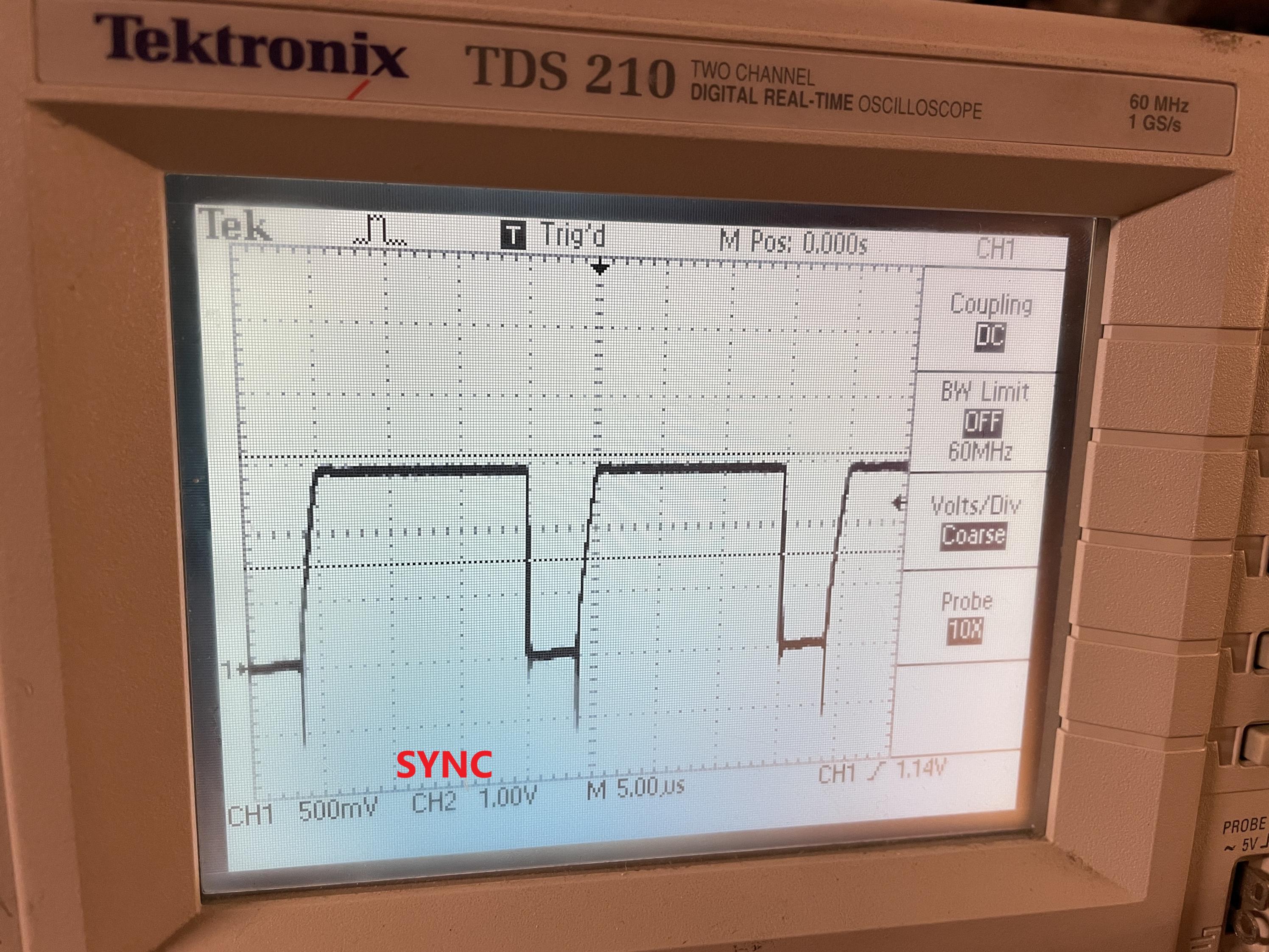

I was about to take down some measurements when gate drive was present and not present.
Gate drive present:
UC3526:
1 - 5V
2 - 12mV
3 - 4.21V
4 - 4.73V
5 - 5V
6 - 9mV
7 - 9mV
8 - 5V
9 - 3.63V
10 - 2.09V
11 - 20mV
12 - (see attached picture for sync, about 1.5V amplitude)
13 - see gate drive picture (measured at fets)
14 - 12V
15 - ground
16 - see gate drive picture (measured at fets)
17 - 12V
18 - 5V

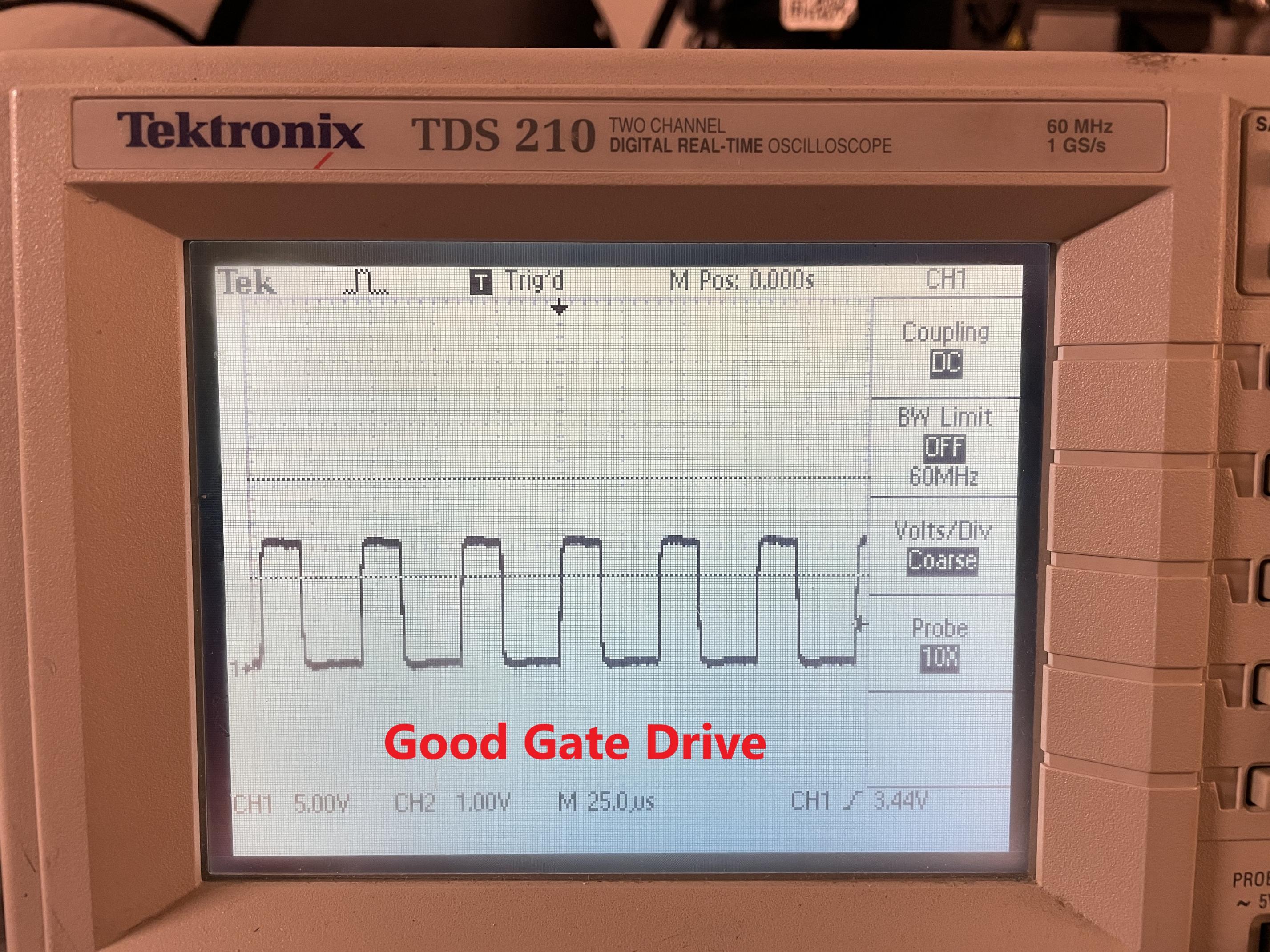

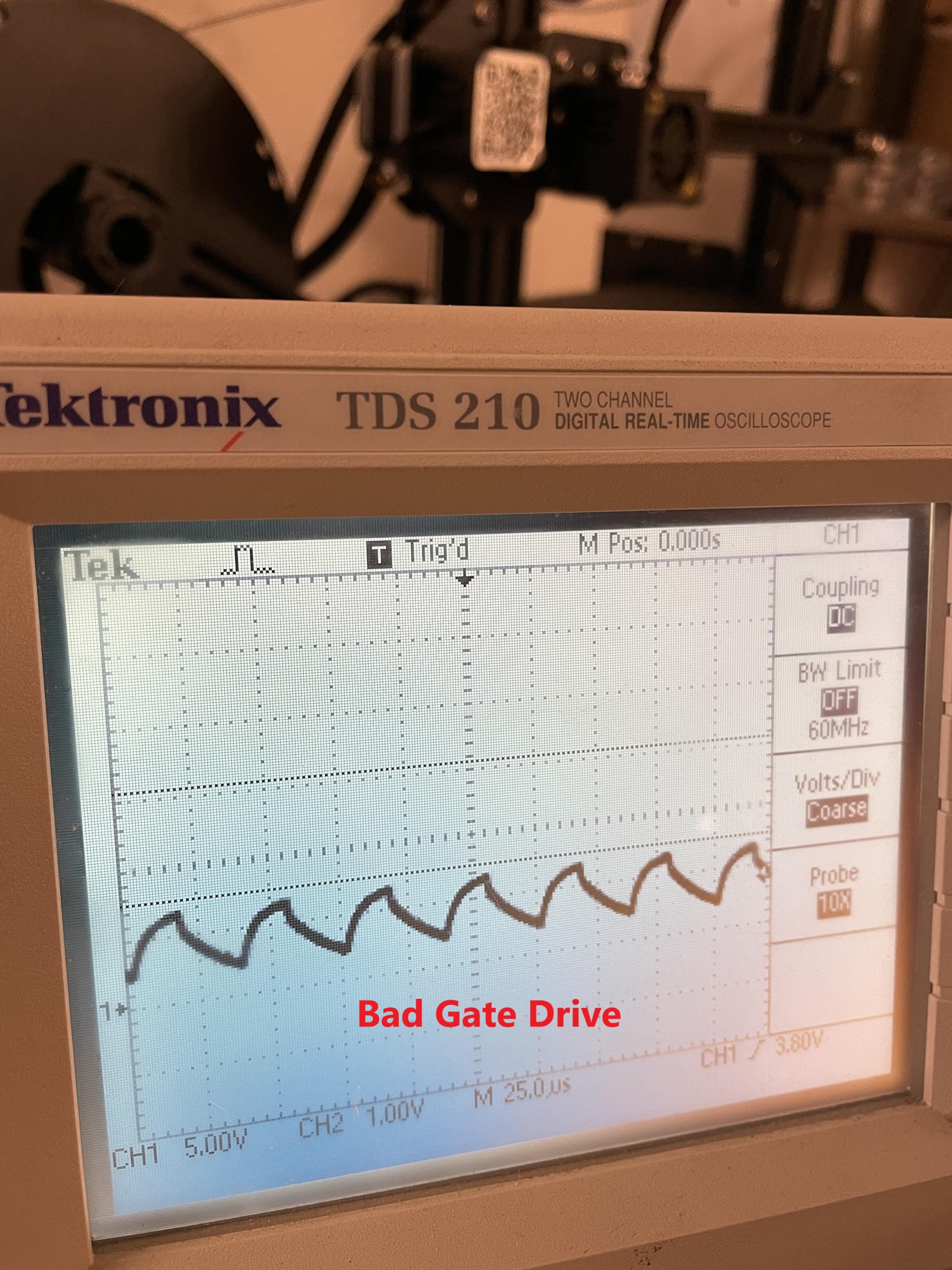

Another thing I noticed is, when I first apply power to the amp, I will see gate drive for a second before it goes away (sometimes longer). When it goes away, I can sometimes power cycle and I will see gate drive each time before going away. When I see the gate drive it looks normal as well.
Initially I was thinking a bad driver transistor because of the weird gate drive waveforms that occasionally show up, but since the outputs of the comparators on the LM339 also change, I'm thinking there is a bigger issue as well?
I have replacement ICs coming tomorrow for UC3526 and the LM339s. But they seem to be working?

Today I replaced UC3526 & both LM339s. Got more consistent gate drive initially. Applied B+ and blue power light came on but the protect light was on was well. It was drawing ~3A @ 13v. Noticed the output FETs getting slightly warm so I disconnected everything and put it back in the case.
Once it was back in the case, when I apply B+ it would attempt to turn on but not fully turn on (rapid pulsing noises). I look at gate drive and I can see spikes (see picture attached).
Now gate drive is gone again and will occasionally come back. Also the protect light will sometimes be on and sometimes off.
I think it is something causing the PWM driver to turn off and its borderline between on & off. What conditions causes the PWM driver to turn off?
Also, what drives SYNC? In the T1000bd schematic, it is driven by a 74HC74A flip flop.

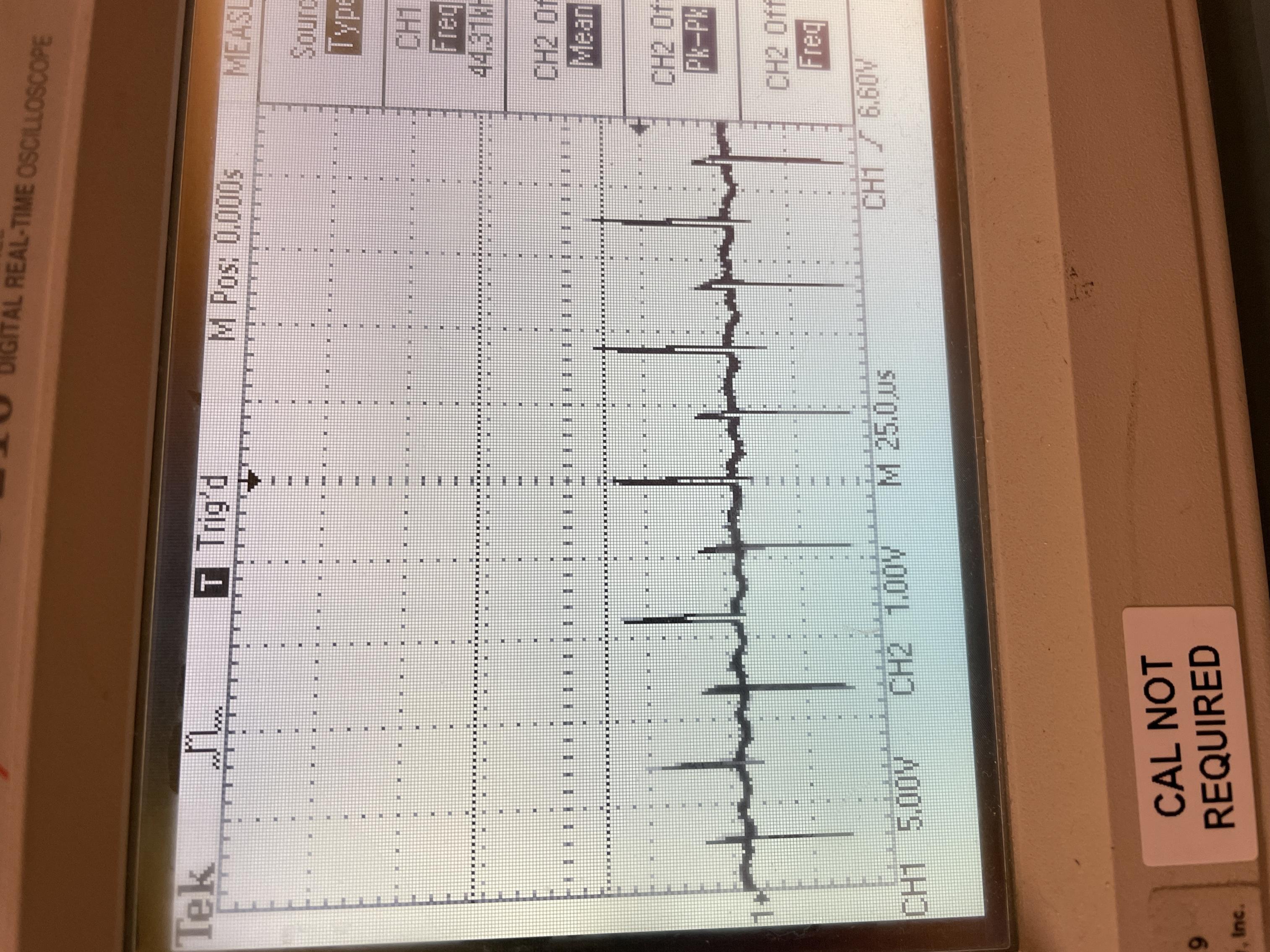

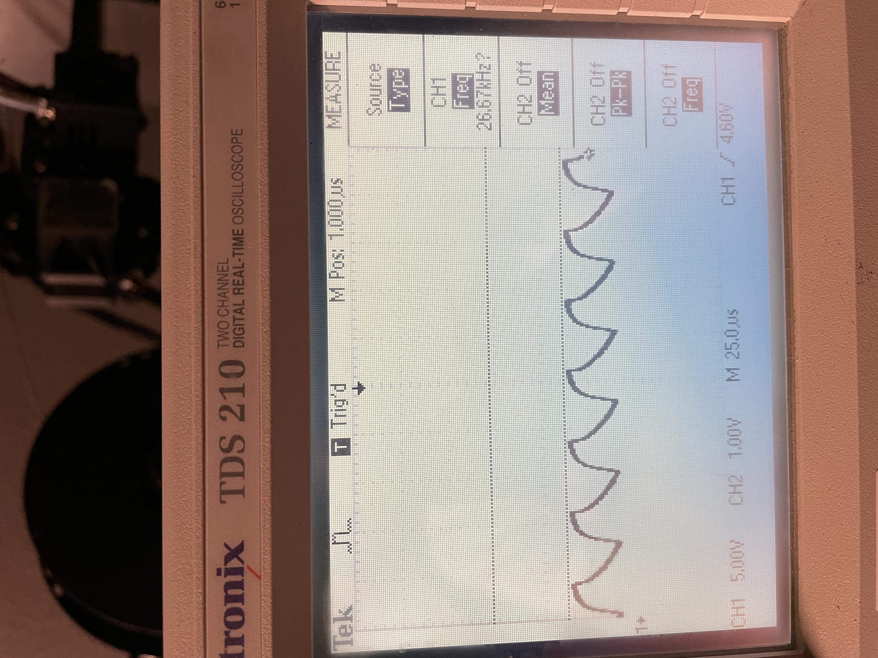

After not touching the amp for a few hours, I go to turn it on and gate drive is there again. But it is kind of a rounded saw toothed look (see attached). I modulate the input voltage to 11V to 14V and as I'm modulating, I see that the gate drive will jump between this rounded saw tooth waveform to a normal square waveform. After a few seconds of modulating the waveform is a nice square waveform and not switching back and forth.
I connect B+ the amp turns on, has blue power LED and the protect LED is slightly on (very dim). I connect a speaker and touch the RCAs input and the speaker moves.. So amp is working, when it does work.
After about 30 seconds of the amp being powered on, i hear switching noises coming from the power supply section. I look at gate drive and it is still a nice square waveform but it is shifting around a bit, looks like the frequency is unstable. I noticed that the switching freq with just GND and remote power is about 36kHz and when B+ is applied it drops to about 26kHz. I guess this is how they change duty cycle since the pulse width remains the same but freq decreases, effectively increasing the duty cycle.
edit: sorry for the sideways pics... it looks fine on the computer before uploading
edit2: also, i measured the rectifier voltages with my scope so that is peak voltage, and not the averaged voltage.. maybe around 70V averaged voltage on pin 2 of the rectifiers?

One of the protection LEDs will remain partly lit. That's normal.
You have to measure rail voltage with both probes on the rectifiers' center legs, neither probe on ground.
The frequency of oscillation for the PS will read differently after the output stage begins to oscillate and the two oscillators are synchronized.
