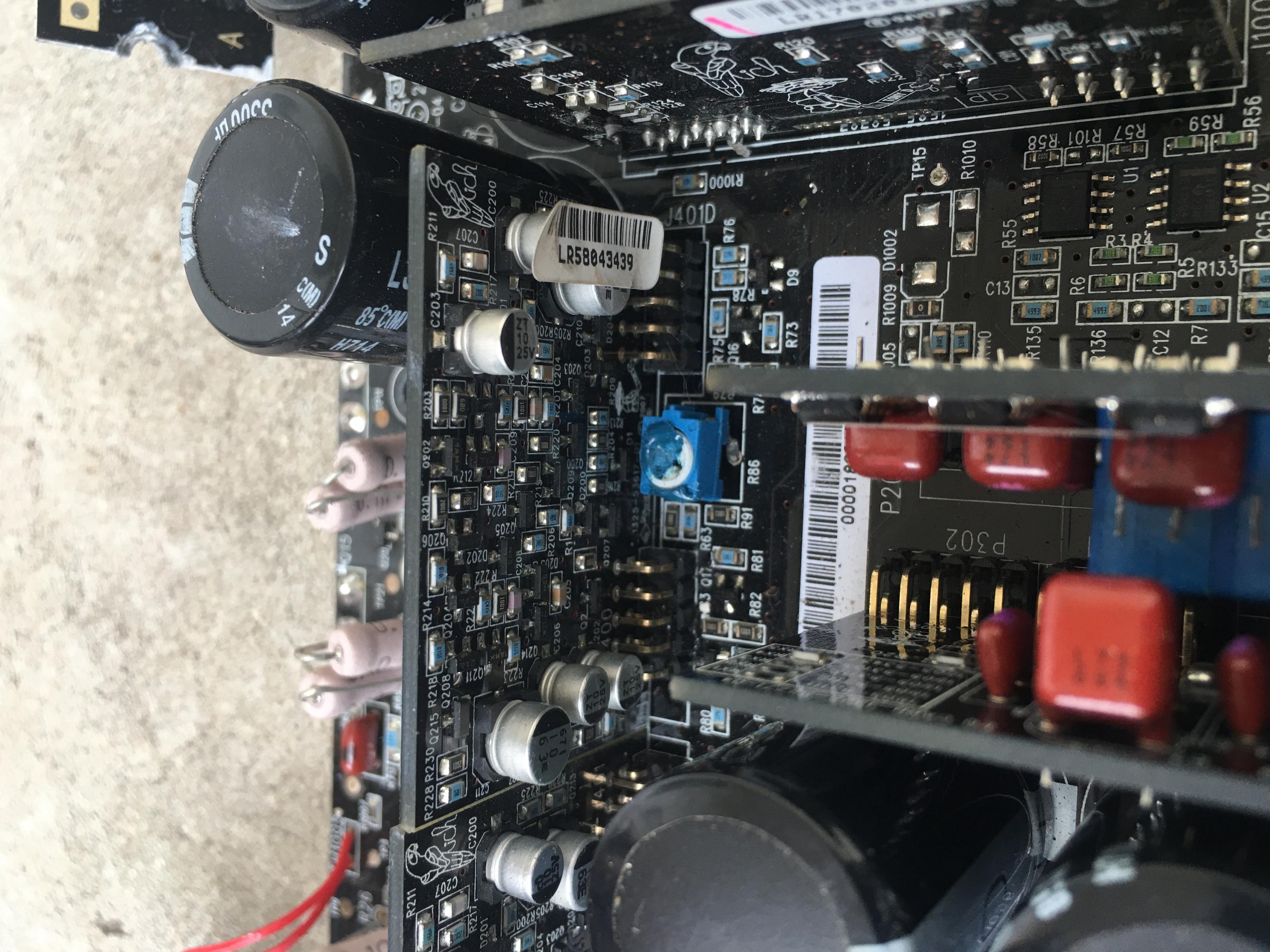

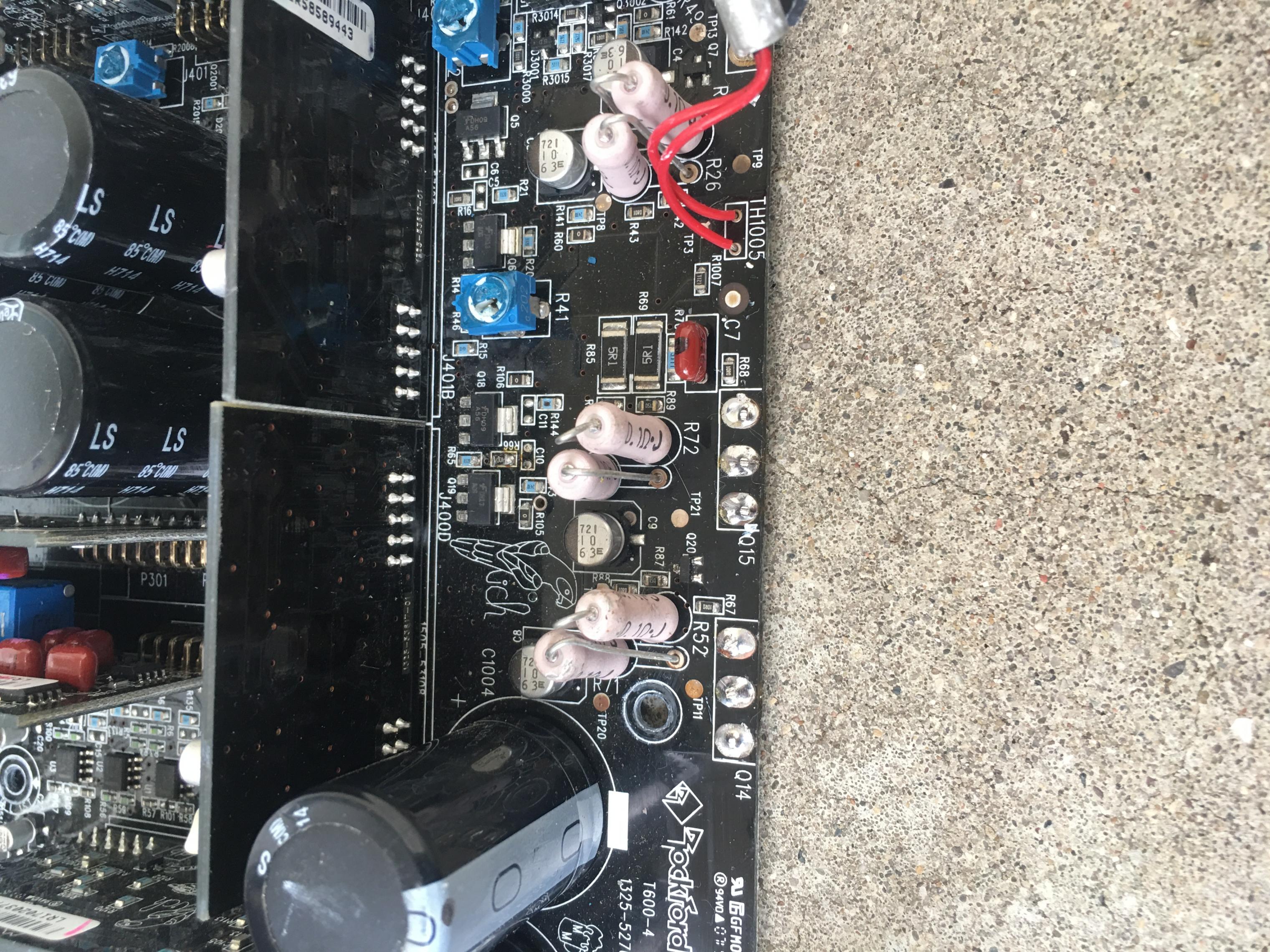

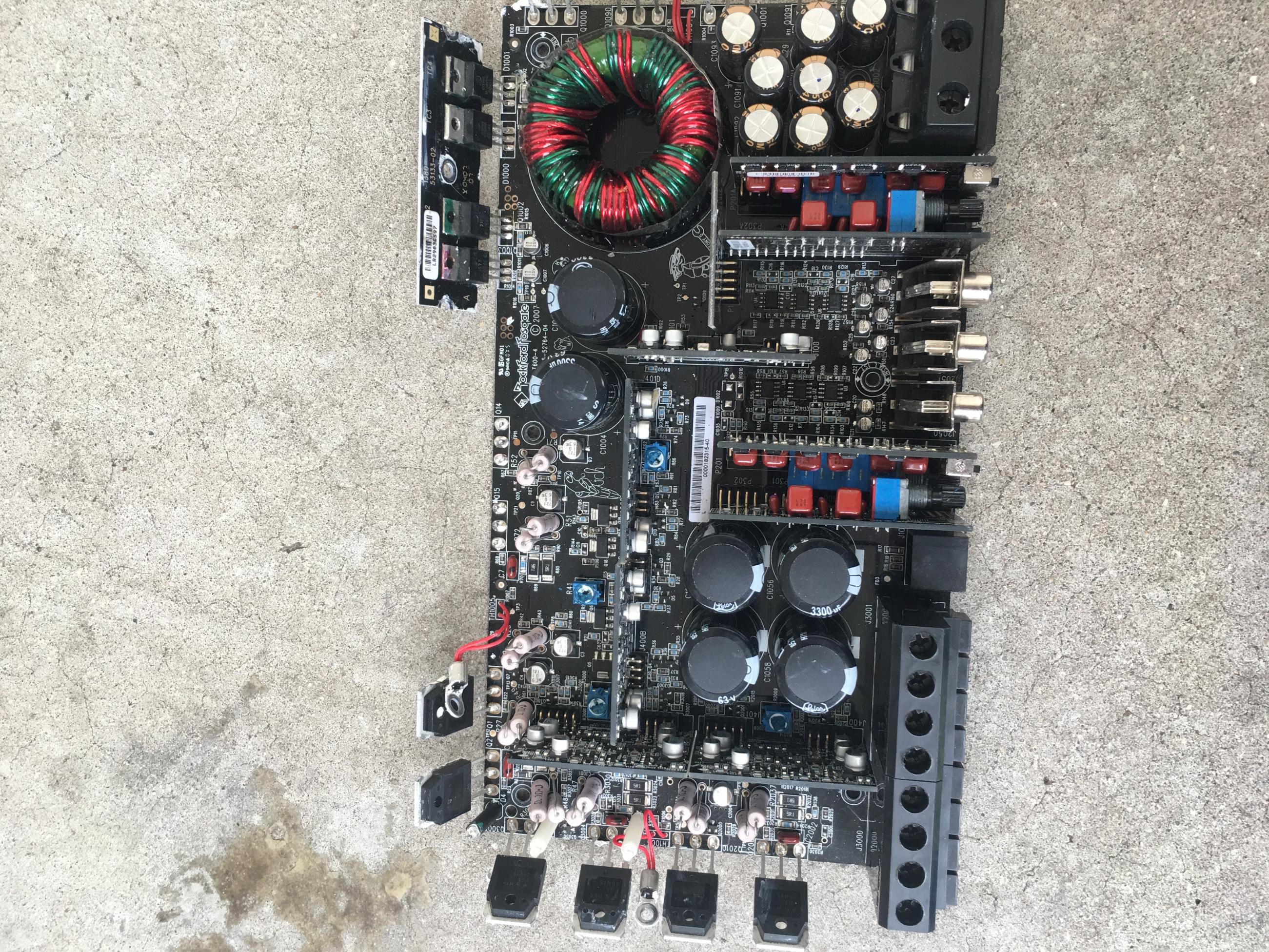

Rockford Fosgate T600-4
The outputs were shorted in 1 channel .
I replaced the outputs and checked the source resistors gate resistors all check fine .
With the outputs in that channel it draws excessive current .
Are the A56,06 the drivers for the outputs on the main board or would the problem be on the driverboard for that channel most likely ?
Here are some pics of the board .
I will call Rockford after posting and see if I can get a diagram .
