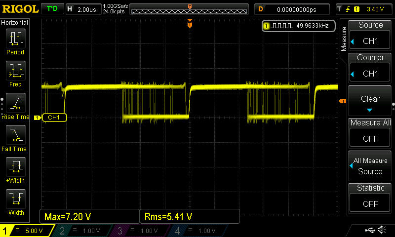

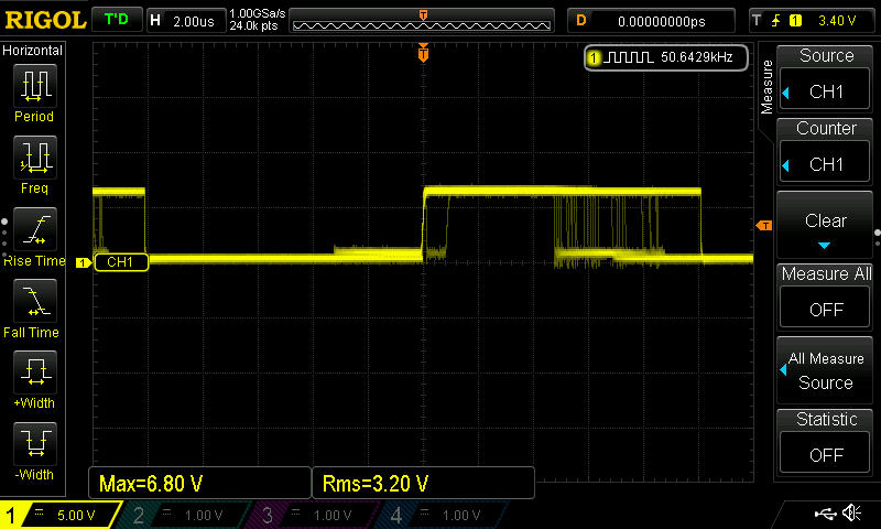

I have also attached photos of something I saw that was a bit strange - I'm assuming it's because the Q2010 and Q2012 isn't able to supply the 12V to R2035... But when probing the toggle A and B at the anodes of D2000 and D2017 I get different results. The anodes of D2000 have a nice square wave (around 50KHz), but the common cathode is basically DC voltage that sits around 6.4V. When probing D2017, on all pins I get a duty cycling square wave that sits around a volt or so.... When removing D2017, the toggle A and B pins match that of D2000, but the duty cycle on the common cathode remains. Also when removing the U2002, the R2035 voltages stabilize at about 11.38V. I've replaced U2002 again and the same thing happens. The collector voltage drops to about 9.28V on Q2010 and Q2012, R9 gets really hot, U2002 starts heating up, and C1015 starts getting luke warm.

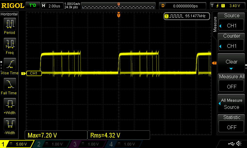

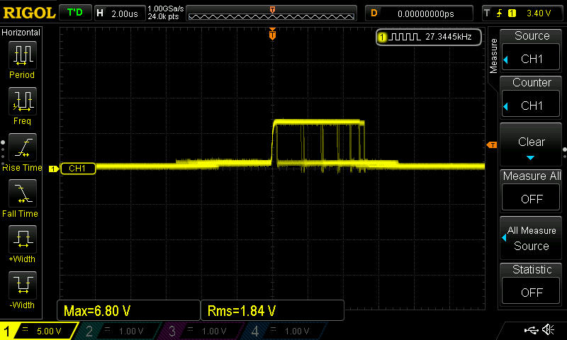

I have attached some waveforms that I think confirm that my 74HC74 is still good.
