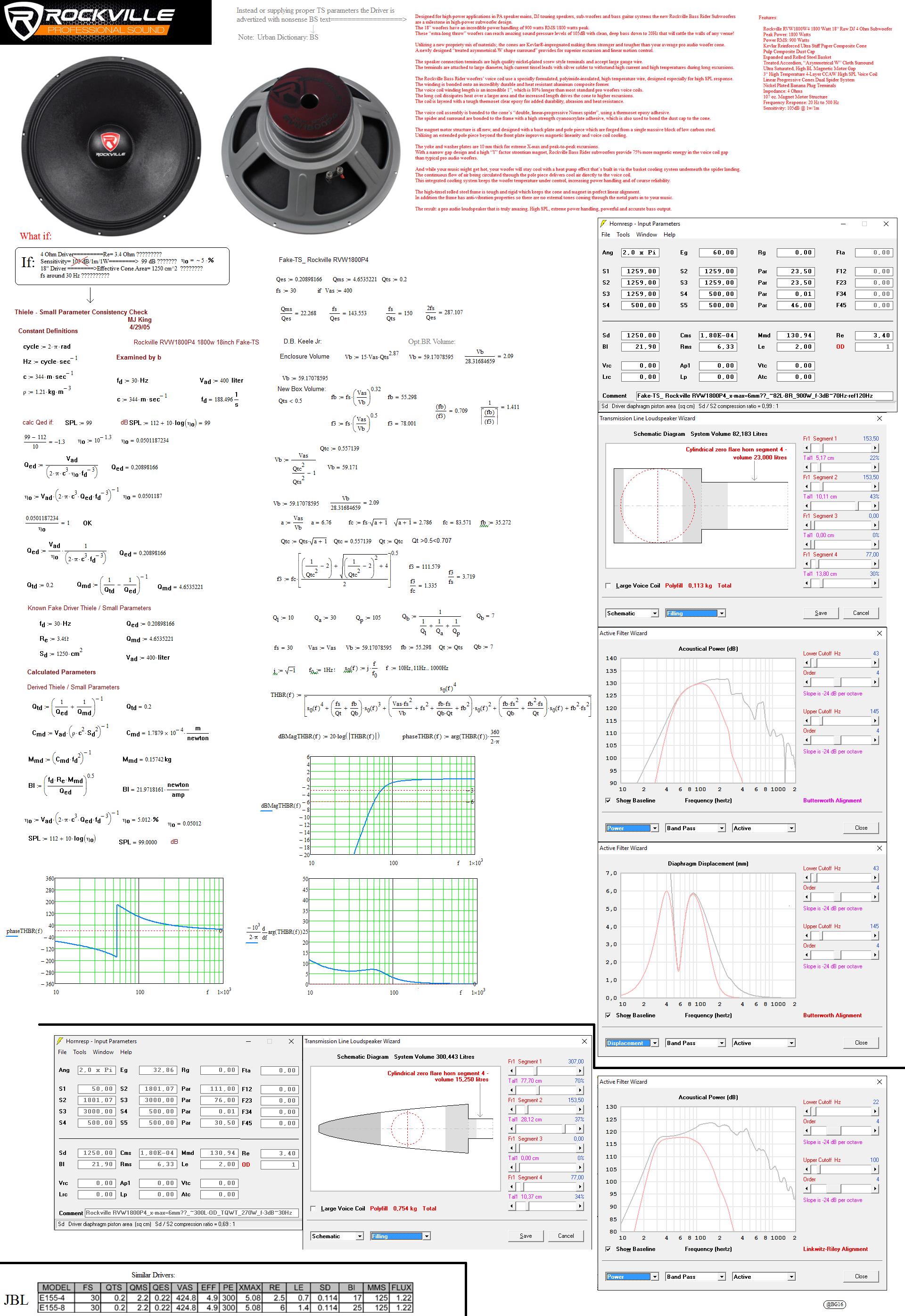

Might be worth it to buy one and test it with DATS. Someone on Amazon posted a pic of the ts parameters. Lots of red in bassbox pro so I suspect they aren't accurate. I ended up using a PRV 15W700 sub for my build, much better numbers according to Bassbox.
Thanks, though 8 ohm, which theoretically will be close: Amazon.com : Rockville RVW1800P8 1800w 18" Raw DJ Subwoofer 8 Ohm Sub Woofer 240OZ Magnet : Electronics
The posted specs are a bit bogus since BL, Mmd are way off relative to the T/S specs, but the only difference is vent length and of course two different tunings, though ideally this would be empirically determined to best blend in room.
They claim a high Xmax, but its accordion surround pretty much limits it to ~5 mm, so 80-100 W usable power handling below ~70 Hz, though this is still ~115 dB/m/2 pi space in ~14 ft^3 tuned in the ~22-27 Hz range with a 10" dia. tube ~13 - 23" long depending on which of the 8 ohm driver's specs are most accurate.
If the drivers have a higher Qts, then worst case is you have to either damp the vent or seal it up completely.

Hmm, the only specs I've seen are for the 8 ohm listed on the posted Amazon site, which equate to 0.47 using T/S and 0.45 using Cms, BL; with Fs shifting from the published 25.02 Hz to 30.87 Hz using HR.
As you know, 4 ohm drivers typically have nearly identical T/S specs to their 8 ohm models, so very curious how you arrived at a 0.2 Qts.
