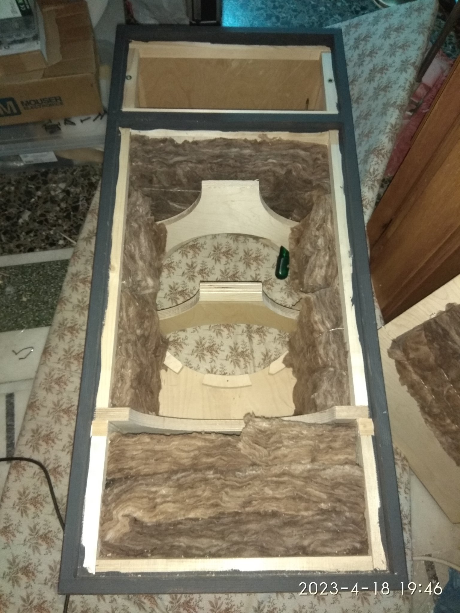

I grabbed some fiber glass mesh with 1/8" perforations to pin over a single layer. To act as a barrier that holds it down. The box is sealed and I got it how I like with a mere 1 1/2" layer covering just the bottom panel. As long as rockwool particles don't make a mess or get in to the sub assembly or hinder cooling.Personally prefer OC 703 duct board mounted using felt roll roofing nails or similar to hold in place and/or OC fiberglass roll insulation for walls, ceiling joists, etc., depending on width, thickness required.

The material is usually placed tight against the cabinet walls, but in some cases a layering might be desired. If it’s the soft wool material it can be fixed to the walls using the hammer type staples.

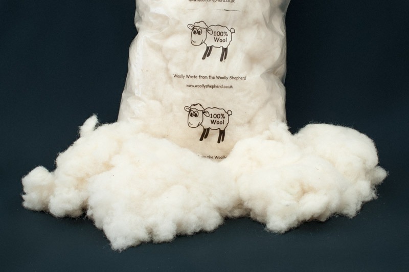

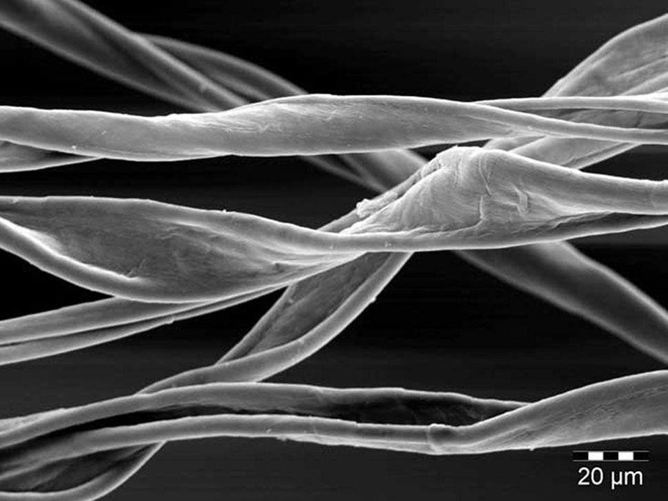

Merely seeing magnified fiberglass made me itchy. I hate that stuff.Wool and cotton are superior damping materials due to the random nature of their natural fibres.
I think I'll save the RW for my acoustic panel needs and shop for some natural cotton.

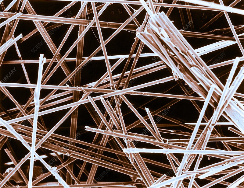

The hazard of fiberglass, wood fiber, cellulose, rock wool, asbestos, and every other friable [evil] fiber is the same. They are inert. They don't directly harm you in any way.
What happens is the fibers can get trapped in your lungs, and your immune system detects foreign material and attempts to remove the fibers. But these fibers can get stuck in your lungs, so they can't be removed. When that happens, the immune response ends up essentiall plugging parts of your lungs, reducing lung capacity a tiny amount. If you are exposed to high concentrations of these fibers for a long time, you may develop "asbestosis" many years after the exposure. Like 20 years later.
