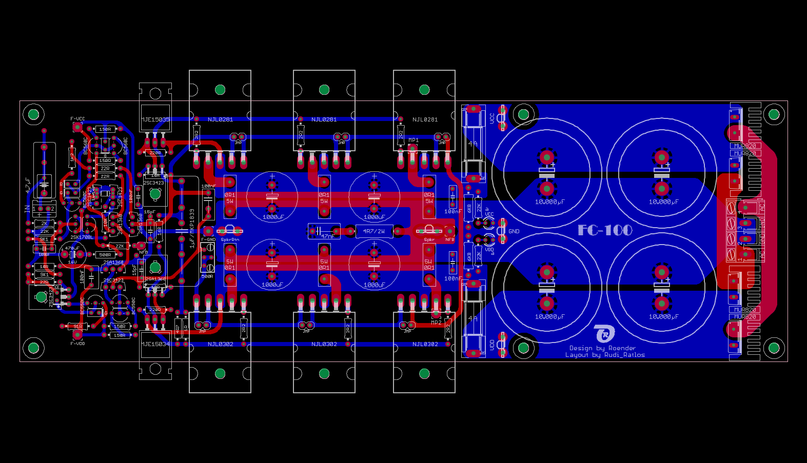

I have only done some very slight, "cosmetic" changes to my original FC-100 layout (changing the input connector, the positions and heatsinks of the backend-rectifiers, ...).
"Never change a winning team". (see image #2).

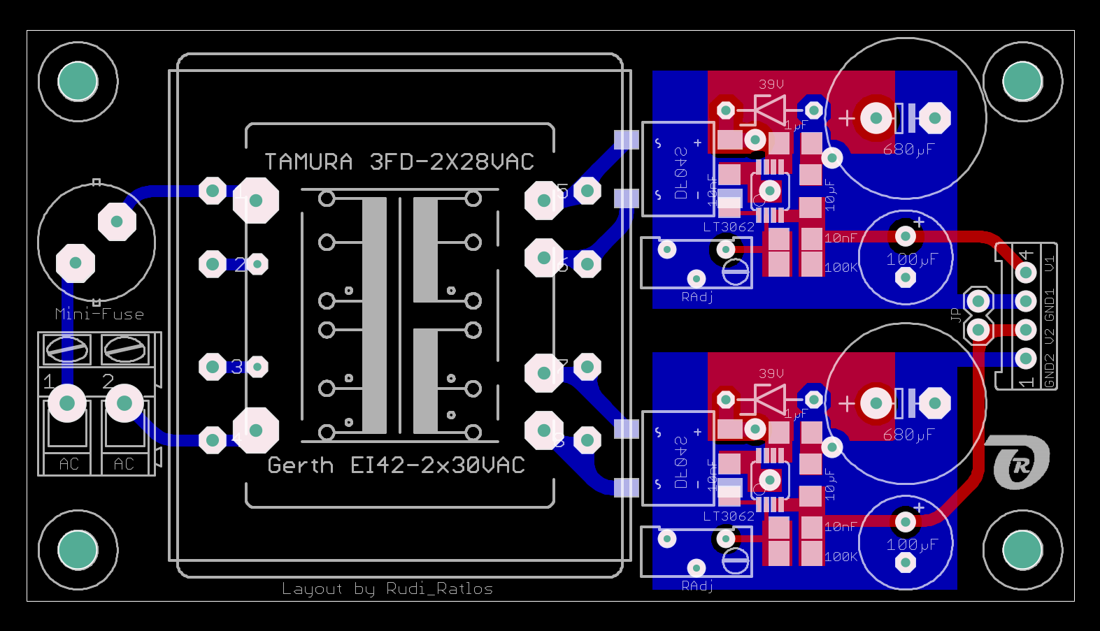

As the FC-100 frontend-PSU I will happily offer you my Dual LT3062-based PSU (see image #3 and the zipped LT3062 - LTspice model).
A German DIY-friend of mine has soldered the LT3062 prototype, being driven from a 2x30VAC EI42-transformer and has adjusted it to give an output of +/-37VDC.
The prototype works flawlessly.

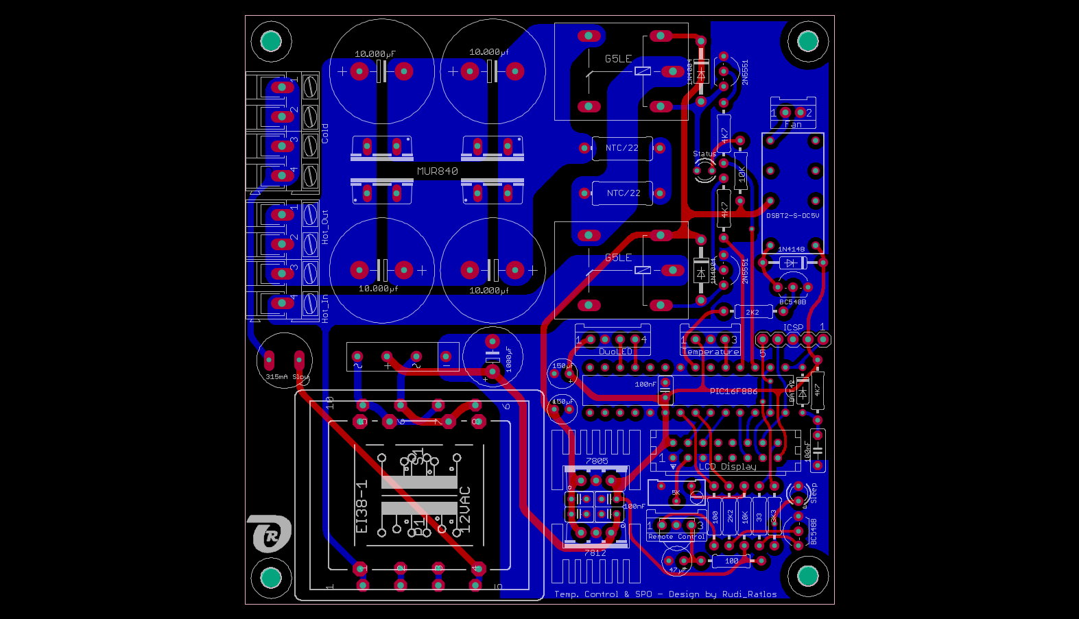

If you want the FC-100 to be driven from a "Soft-Power-On Circuit", I will offer you my "SPO/TempControl" - PCB (see image#5).

Aradan, you see 2 OMRON G5LE-relays on the PCB.
The lower one is to pass the mains hot. If is open, no current will flow at all.
If is is closed, the current will flow through 2 NTC resistors, wired in serial. The current will therefore be limited by the combined value of the 2 NTCs.
The current limitation is active, as long as the upper G5LE-relay is open.
If the upper relay is closed (after some delay), the 2 NTCs will be bypassed by the upper relay and the current flows unhindered.
Opening and closing the relays is accomplished by the used µProcessor.
For example: #define SOFT_POWER_ON() { PORTA |= (0x01 << PRIME_RELAY_PIN); __delay_ms(250); PORTA |= (0x01 << SEC_RELAY_PIN); }
Besides the Soft-Power-On circuit the PCB contains a mains DC filter and the functionality to monitor the temperature of a heatsink.
The current status can be displayed on a LCD.
Power_On and Power_Off can be remotely controlled by a IR control unit.
The SPO-PCB can be used for the M2 as well - no problem.

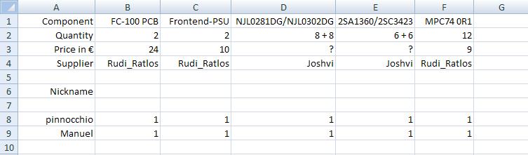

Joshvi, thank you for your willingness to match the transistors.
I have prepared the shown order-form (image 1).
Everybody needs two FC-100 PCBs, the total price of which is 24€.
Then he needs two frontend PSUs (either LT3062 based or Mihai's shunt-regulator).

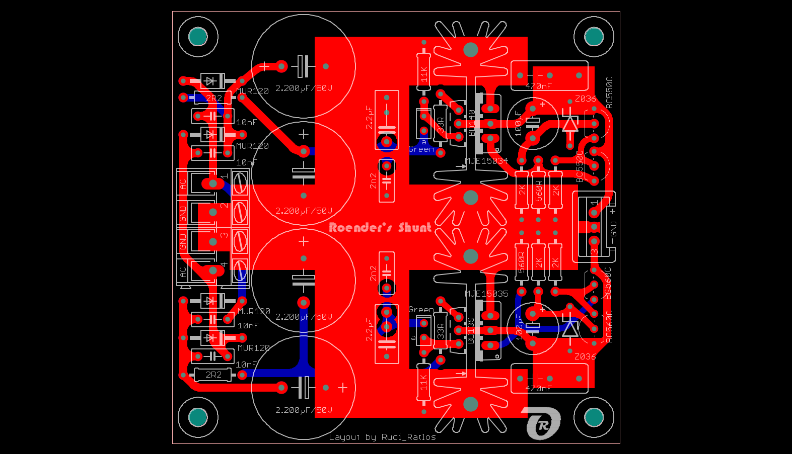

I have asked Mihai to give me his opinion about the LT3062 regulator.
The price for the 2 PCBs is 10€.
I recommend that the participants buy 8 pieces of each NJL0281DG and NJL0302DG (allthough only 6 pieces of each are needed),
to increase the chance to find 2 well-matched triples of each for every participant.
Joshvi will supply the 2SA/2SC transistors.
I myself will order 12 pieces of MPC74 0R1 emitter resistors for each of the participants.
I will stop this group-buy, as soon as there are 5 participants.
Please, gentlemen, hurry up!
I am getting a little bit nervous while observing the stock of Mouser's NJL-transistors.
Best regards - Rudi_Ratlos

Just to show you, how my own FC-100 looks like (image 1).
It is driven by 2 transformers rated at 2x25VAC/225VA each.
It uses 2 of Mihai's shunt regulators to drive the frontends.
I have mounted my Soft-Power-On PCB on top of the 2 transformers.
The heatsinks are "kind of overkill".
They are never getting hotter than 31°C.
