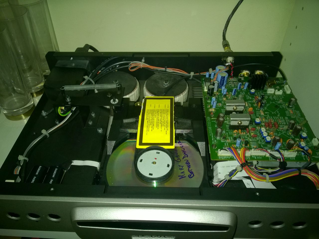

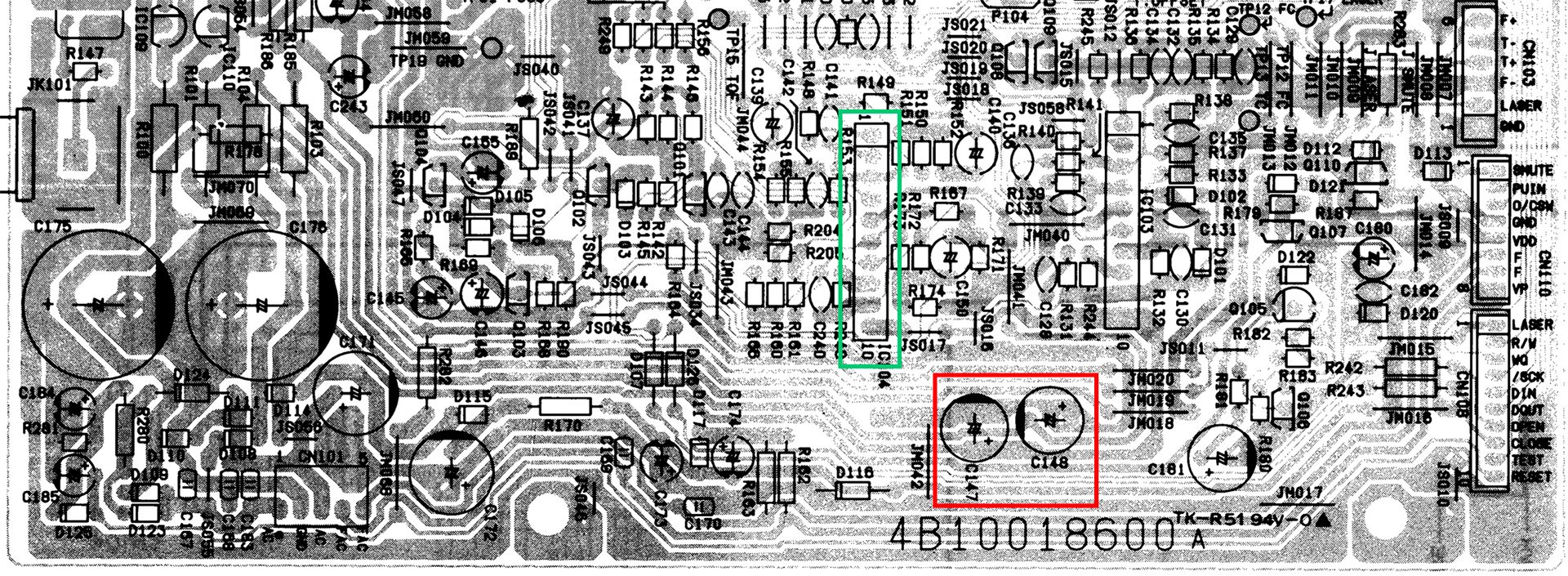

Picture is of a similar model (but not mine).

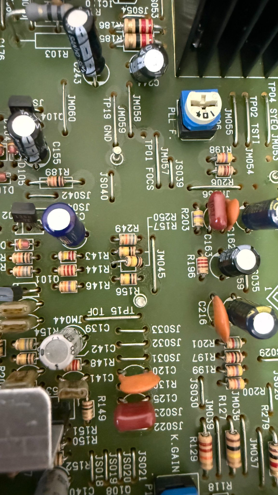

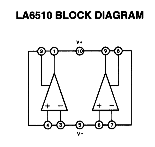

I've traced back the lines from the disc motor to the IC104 marked in green. Pin 1,2 are the ones responsible for spinning the motor so I checked the pinouts for the +ve and -ve voltages. Power is supplied by C147,148 marked in red. Checked my parts bin and found suitable replacements so i replaced them. Voltages are +15V and -15V.
The motor now sputters intermittently. It looks like its ticking trying to spin stronger than previously but it still does not spin. If I leave it alone for long, sometimes it would spin half rotation or so and then stops.
Measuring the disc motor shows very little voltage going out.
I also probed the voltage rails when the tray motor spins and it sags quite a bit from 15V to around 13V when the tray moves in or out.
For those interested, IC104 responsible for disc motor is an LA6510. Anyone has some idea what else to probe?

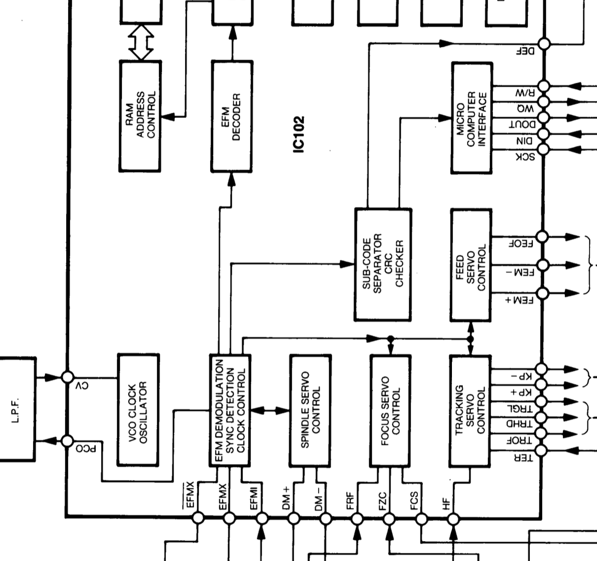

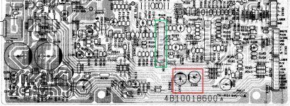

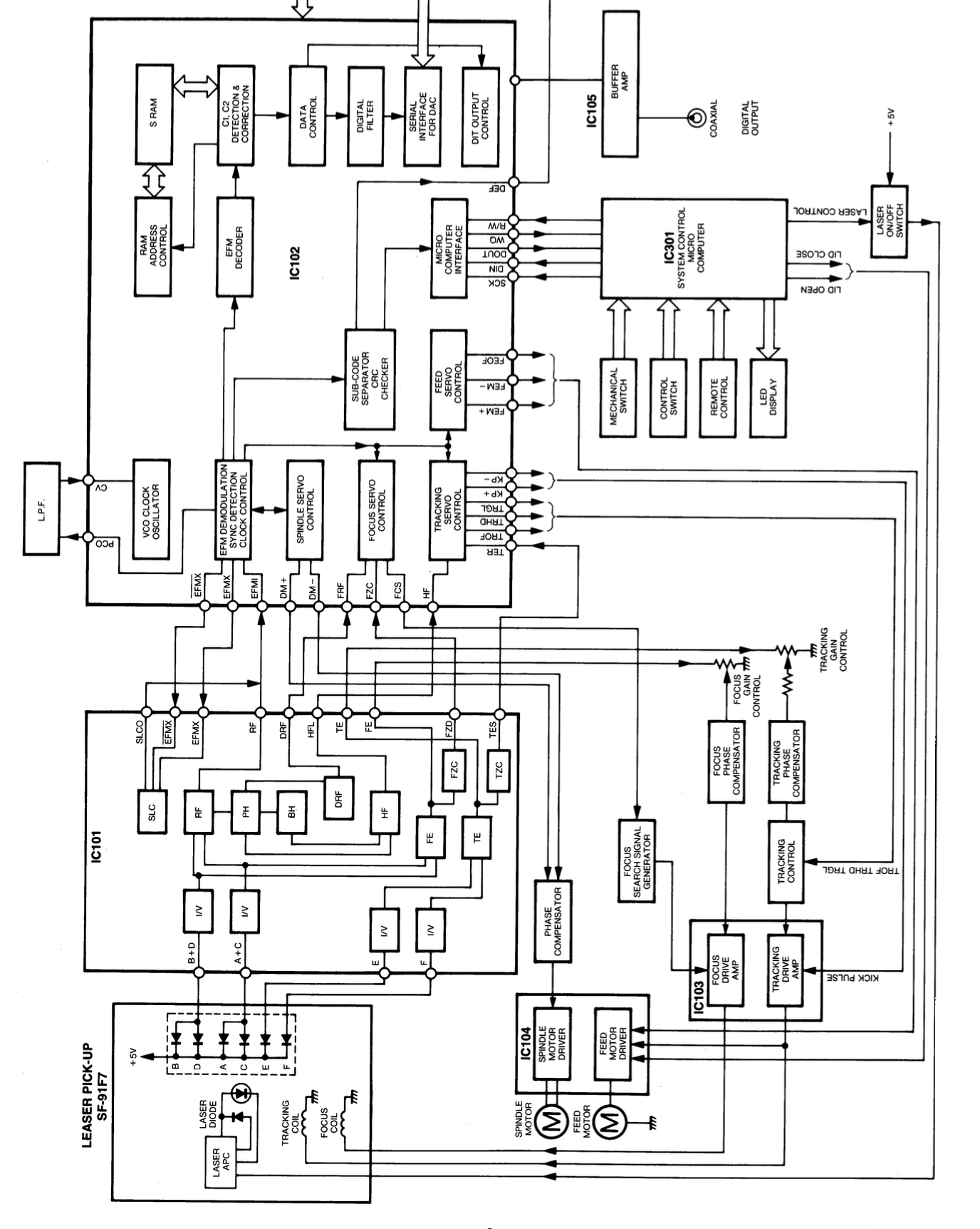

Seems that I'm getting somewhere. Based on the functional block diagram, IC102 is responsible for sending the signal to spin disc motor via SPINDLE SERVO CONTROL.

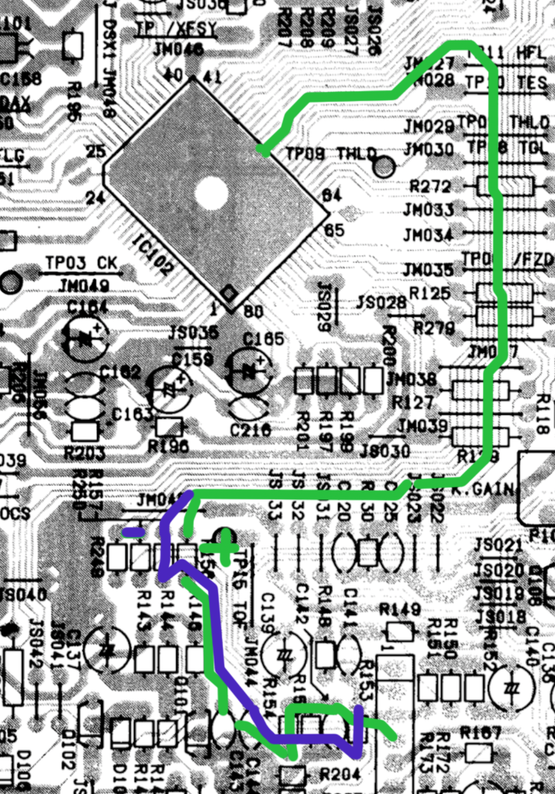

I replaced the electrolytic capacitors around the IC and the disc motor now jitters quite strongly. Jitter is constant, erratic, and has no pattern to it. Power is fed by a voltage regulator but it outputs a stable 5V so I'm ruling that out.
Checking the IC102, YM7121C datasheet it shows pin 53 is disc motor +ve and pin 54 -ve.
Tracing the line with the thick green stroke, i've split the +ve and -ve towards the end. Blue is -ve.
Reading on +ve is a constant 0.9mv
Rreading on -ve is erratic, up to 20mv
Spindle Servo Control is fed by EFM Demodulation Sync Detection Clk Control. This is fed by IC101 which gets fed by the laser.
What I am thinking is, either IC102 is faulty and cannot provide a stable disc motor signal, or IC101 is faulty and cannot feed a stable signal to IC102.

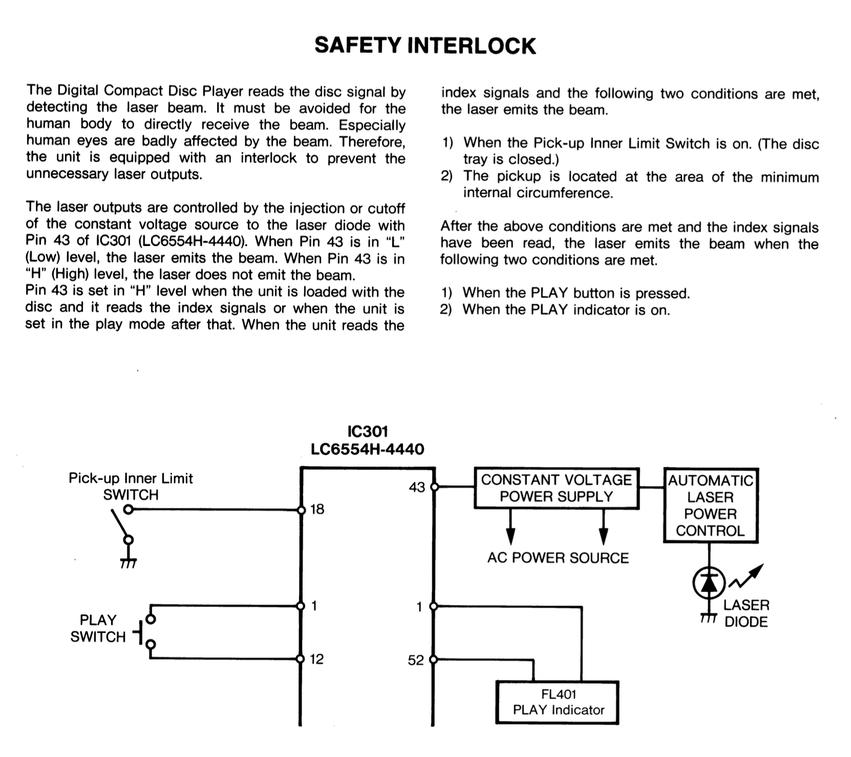

I looked at the service manual I have (for a CEC CD2100, similar main board but different front panel board).
On the block diagram it shows the laser is controlled by IC301 LC6554H4440 (image attached) in the front panel which is common to players.

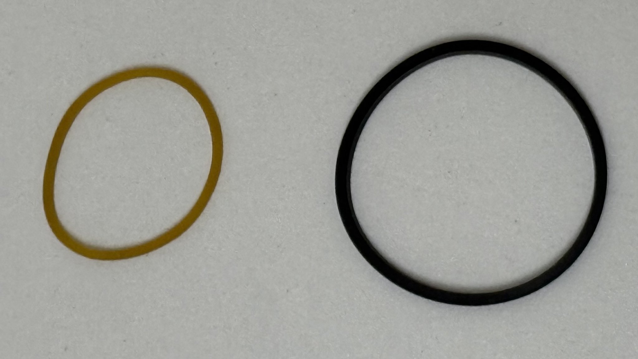

Thank you very much. I’ve found out what was wrong with it. Sorry it slipped my mind I should’ve updated it here.
The unit came with an original belt. My go to servicing is to replace it but my black replacement belt is thicker and stiffer.
When the laser moves to home it’s supposed to back out and release the leaf switch to initiate focus. The new belt is too thick and stiff, so it rubbed against the laser sled.
After a few cycles the belt settles into the grooves loosely so it rubbed the laser more.
It couldn’t back away from the leaf switch to laser doesn’t start.
I replaced the belt to its original one and it runs well. There’s plenty clearance with the thinner belt so laser moves freely and can crawl away from the leaf switch.
