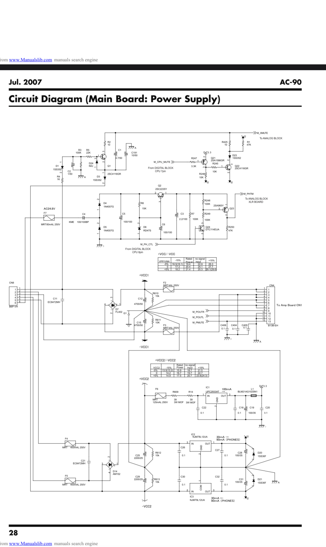

Hi
This is probably not relevant - but did you check the power supply rails?
Allthough your problem is likely related to the amp itself (of which I have no experience) then the problem you describe would happen if the power supply were not capable of delivering the current needed for larger loads.
If the issue is the same for both channels I would definitely measure the power supply rails under different loads.

Hi Martin,
Thanks for your reply.
I just checked the power rails pin 1+2 to pin 10 and 3+4 to pin 10 on the amp board which is connect straight to the power supply board and I’m getting voltage on them. 23.84v and -24.16v. When the music is playing the voltage pretty much stays the same only the values after the decimal point is constantly changing. I suppose I’d be better to use a generator tone for testing.

Hi Paul
I am not sure that there is a "best way" to measure on a power supply - it may depend on what one wants to measure.
Using a tone generator would definitely make the reading of the output voltage simpler (as it would be more constant than when using a sound input) - but it will carry a risc that the speakers might not like a constant high-power signal for several seconds (nor may your ears).
Another approach that does not risc the life of the speakers would be to load the power supply directly with a resistor (something like 15 ohms) - this however will require that you have for example a 15 ohms resistor capable of at least 40W.
This may not be present in your drawer with resistors 🙂
Anyway: a precise measurement of the power supply is not necessary for a basic analysis if your problem is with the power supply.
If you can measure that the power rails stays around 24V - even when provoking the clipping problem, then it is not the power supply that is causing the problem.
For the power supply to cause the problem I would expect that the power rails would drop dramatically when you applied a signal.
Another thing to investigate (as it seems from your previous measurement the power supply is not doing something strange)
If you have an oscilloscope: then look at the output from the amplifier an find out at what output level the clipping sets in.
If not you can input a constant tone to the amplifier (PLEASE: ONLY DO THIS FOR A VERY FEW SECONDS) and then measure the output signal from the amplifier with an AC-voltmeter.
Given your description of the problem I would expect that this would show only 1 or 2 volts (or less for that matter)

Hi Martin,
Voltage between +VCC1 and -VCC1 is 47.7v
Voltage between +VCC and power Ground is 23.90v
Voltage between -VCC and power ground is -23.84v
This is a constant voltage from the psu when listening to audio at low level with no clipping and remains the same when volume is increased to a point where the clipping starts. Typically input volume at 9 (no volume being 7 o’clock) master at 12 o’clock.
I measured the output at the speaker terminals with AC volt meter and clipping voltage is 1.9v AC. I recorded a max of 4.185v AC. According to the min max on multimeter. I Measured around 0.3v playing with out clipping on and off.
I connected a signal generator to the input.
80mV amplitude at 1K no clipping at all and would remain around 1v AC very loud on ears just a few seconds only.
300hz at 80mV got distortion and AC voltage over 1v AC.
100hz at 80mV got distorted straight away and AC voltage near 1.8v
I disconnected the power amp board and left the sig gen inputting 100hz at 80mV and measured on the oscilloscope between pins 9 + 10 (Main Sig R) and AGND. The wave form was perfect 100hz increasing with the volume control with no signs of clipping at all. Same result on main sig L pin.
Leads me to believe the amp board is the issue. I looked for dry joints. I couldn’t find any. So I Basically solderied every component on the board. Still no change.
If I could find an amp board somewhere it would speed things up a bit to whether I’m going down wrong path. .

Hi Poul
I sorry for my late reply.
Given your measurements for the power supply and your other observations I agree that the amplifier ifself seems to be the problem.
Unfortunately I do not have sufficient experience with class D amplifiers to provide any usefull comments.
I looked up the TDA8920 chip and the design by Roland follows the application suggested by NXP quite close.
One last suggestion though: try to look at signal at the PROT pin.The clipping could be the protection circuit activating - although the behaviour when in protection mode described by NXP is not the same a what you experience.
