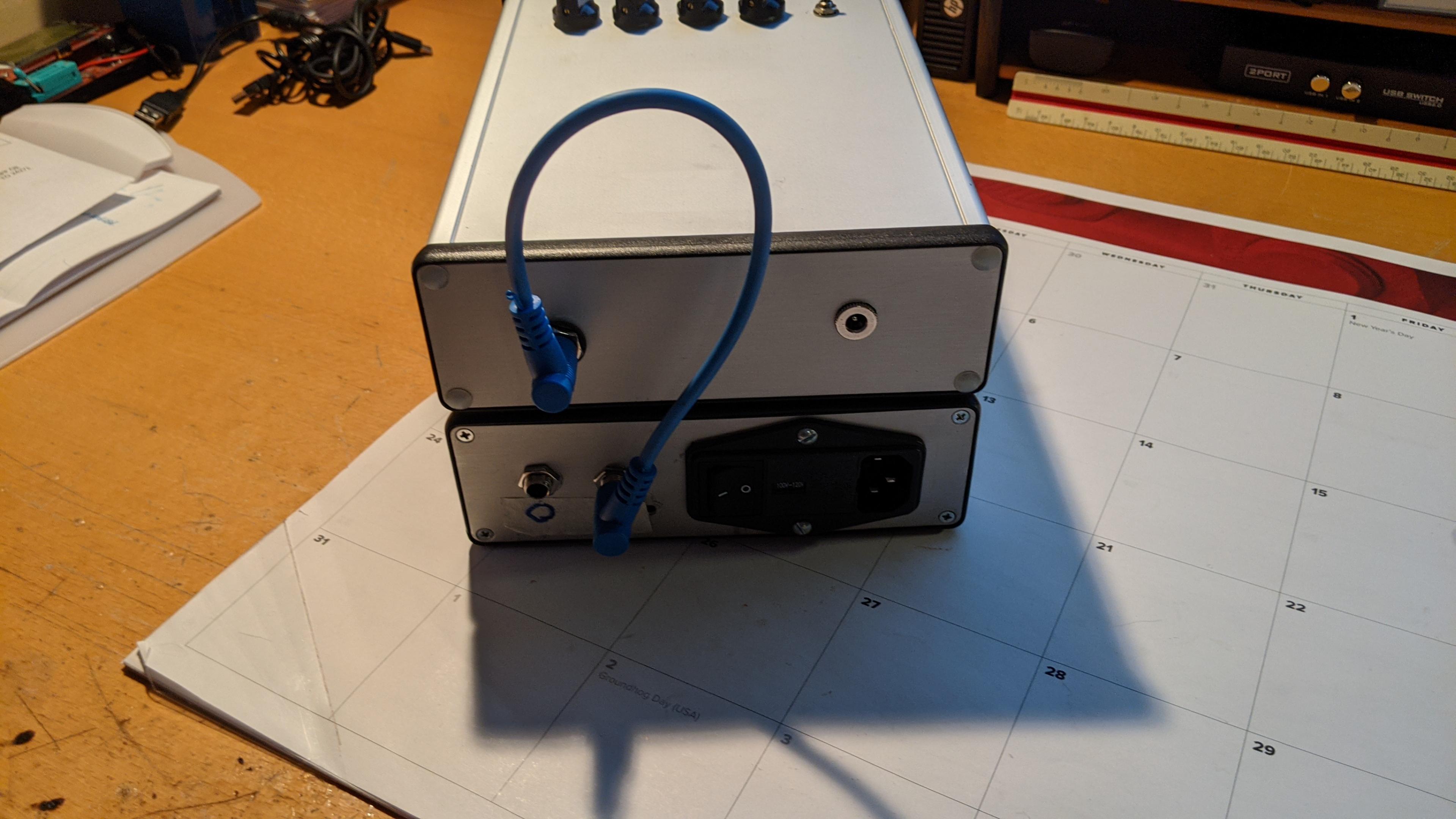

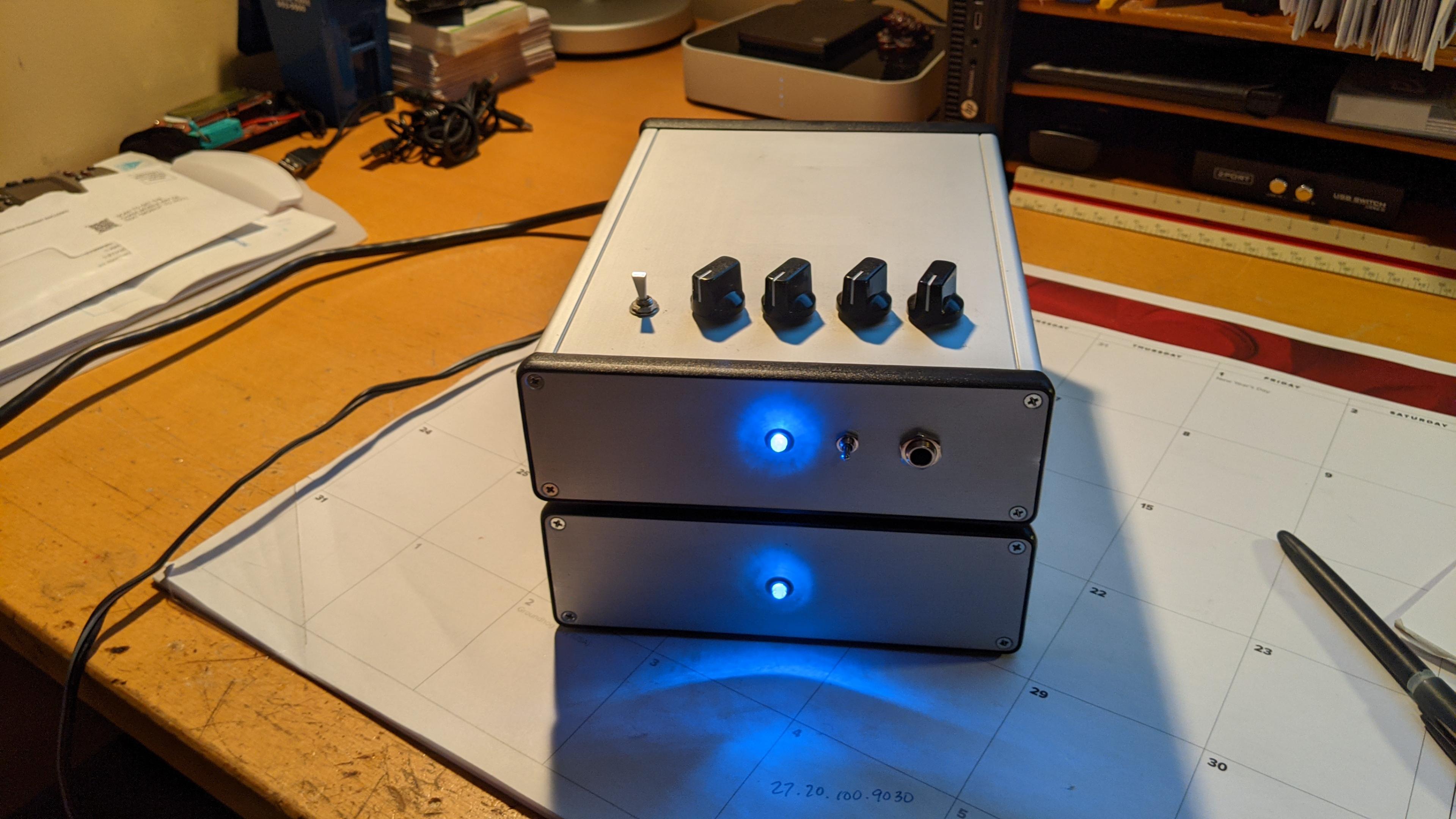

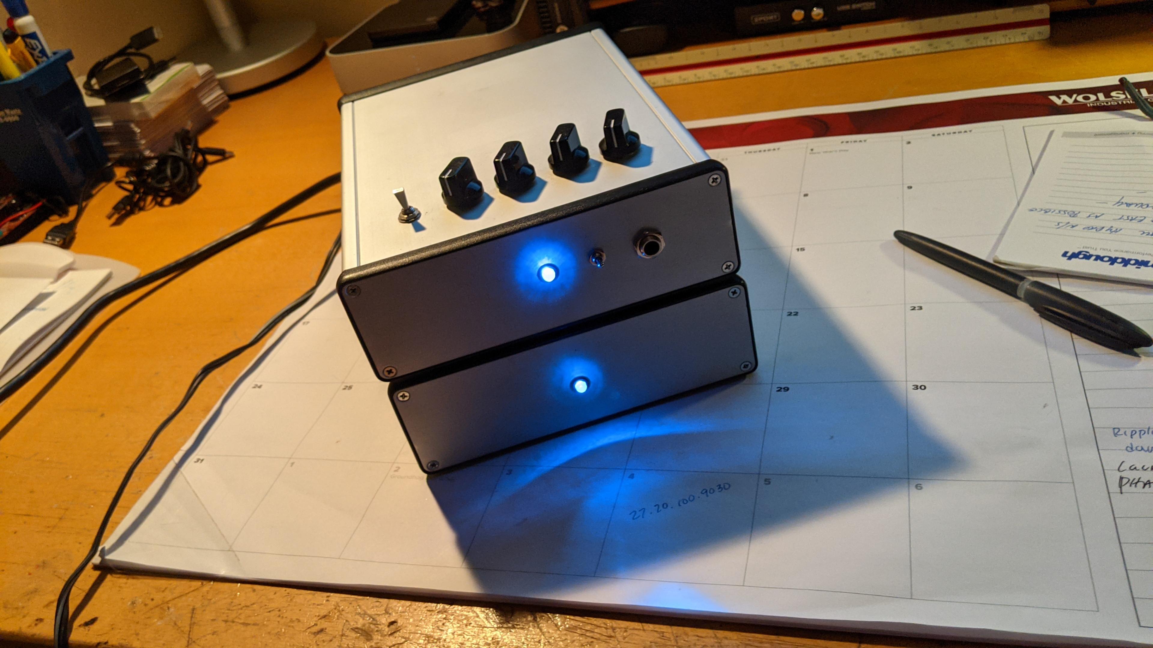

Anyway, I downloaded the schematic (the version with 2SK117 not the later opamp version) and had a PCB fabbed with the help of a fellow DIYAudio member (Thanks Craigtone!!)
So the preamp has all the goodies including a quad of 2SK170 instead of the 2SK-117 (a deluxe version?) and behind it is a LM3886 - standard fab of Brian Bell's gainclone amp. Preamp has volume, bass, mids, treble and a Hi Treble switch. With LM3886. it's roughly 45 wpc. No reverb, chorus, etc, just the preamp / amp section. The rest you can do with pedals.
After building the amp/preamp, I bought a real Roland JC-120 Guitar amp, and surprisingly sounds very close. Bandmates were impressed!

Please note the four transistors Q1, Q2, Q3, and Q4 are all reversed from depiction on board for a 2SK-117 / 2SK-170. All else perfect. Found out after PCB were made...did not do a good job checking...
Voltage is 20 -35vdc (I used a 19vdc power supply from old laptop, but original amp was around 36vdc)

very thanks ¡¡¡The preamp section is around 27vdc, while the amp is at around 40vdc.
Preamp comes before the amp
Then this pcb pre is +27 -0- -27Vdc?And that is +40vdc -0- -40Vdc
