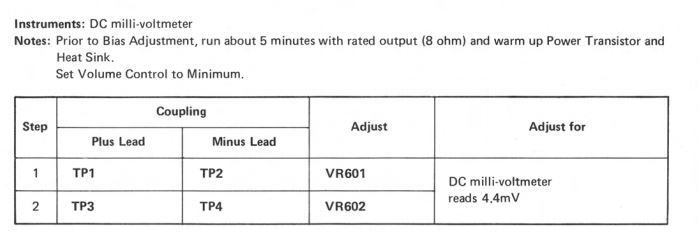

First check for DC offsets on your output (TP3).
Then check the voltage at the base of Q623.

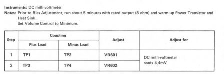

Also recheck the Bias per the attached thumbnail.
Thanks for your thoughts.
I did some checkings: Q627 and Q629 both measured fine.
There was some DC offset on this channel (~30mV, the other channel was fine, approx. 0mV) which I corrected. Bias was at approx 2.5 mV, as suggested.
The base at Q623 was at 1.18 V (compared to TP3). The equivalent on the other channel measured the same (but the schematic suggests it should be 0.53 V?).
However, measuring the temperature again, the situation appeared less asymmetric than before: Q637 was ~ 71 C, equivalent on the other channel ~ 67 C. The other two drivers were ~ 55 C.
Perhaps nothing to worry about?

If you measured from Q623 base to TP3 part of the voltage drop would be due to the dc offset.
I take it you used the diode test function to check Q627 and Q629 base emitter junctions and the voltage range to test between base Q623 to TP3 under power without the speaker being connected.
I would be comfortable with driver temperature at 55 C if that applied to all 4 of them. I recommend measuring the voltage drops across all the emitter resistors in the driver and output stages and work out the current levels.
The safest way to do that is to put the black probe into the black speaker terminal in that way you only have to use one hand with the red probe.
