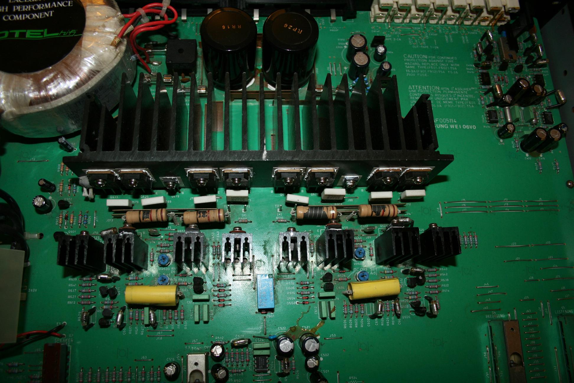

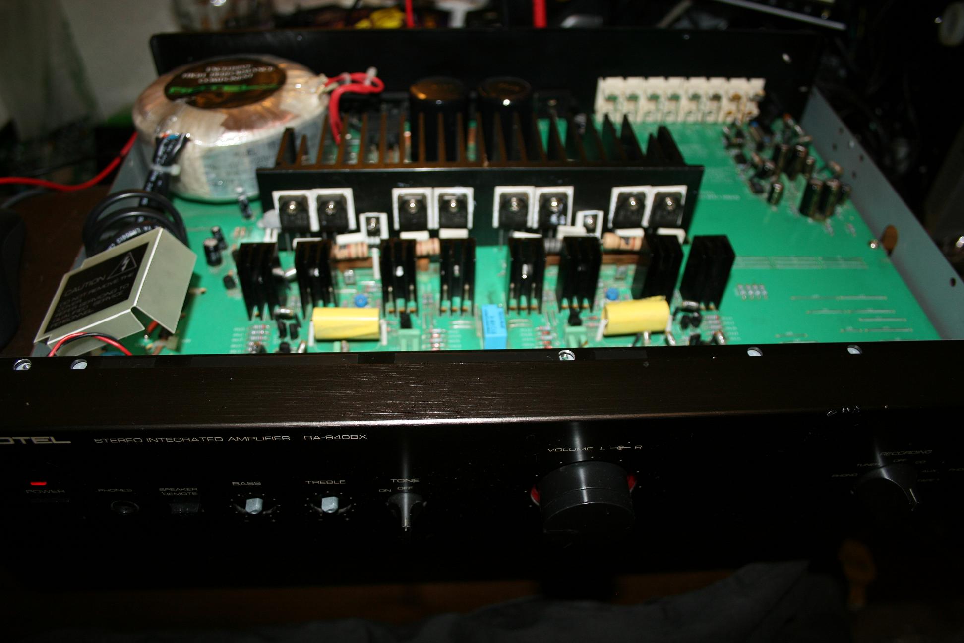

Hi guys I failed miserably on a teac amp recently and decided to try this rotel out.
The problem is the sound on both channels is distorted. you have to turn it up max and all you hear is crackles on speakers and via headphones sounds half decent but at high volumes struggles and starts distorting.

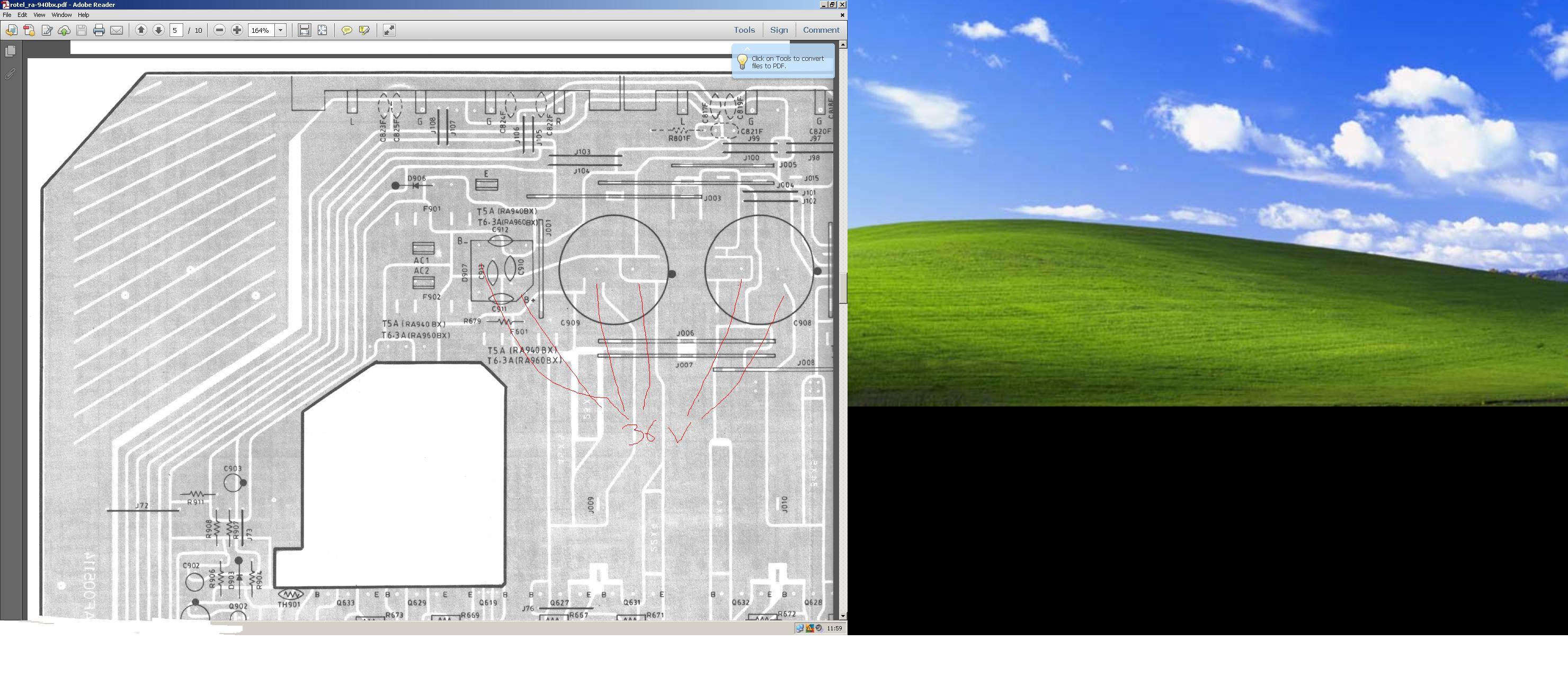

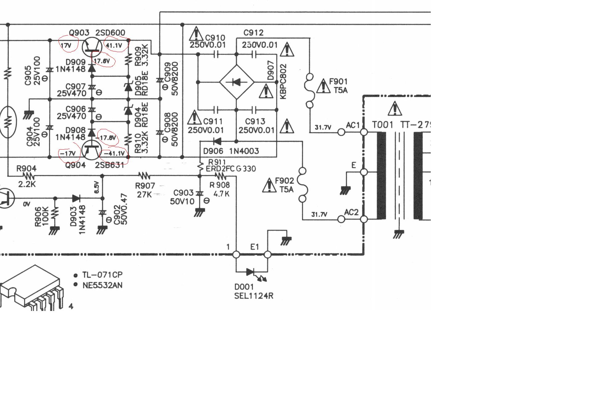

I have service manual and its really confusing. The voltage seems right for one side but the main voltage is wrong but everything checks out ok?!?!
The part is also not the same on sm is 802 bridge diode. but its actually an PBPC803 installed but it checks out ok. everything there seems to check out diodes, resistors, caps. sm manual states 41v but im getting 36v. on the other end it states 17v and i am getting 17v

The +/-17V supplies are for the preamp. They are broken down from the raw +/- 41V DC that supply the power amplifiers, by voltage regulators Q903,4. If you still have +/- 36V there at the collectors of Q903,4 , you would expect these would have no trouble still maintaining the correct +/-17V output for a light load like the preamp and other ICs. The measurement points are from common ground to each collector there.
With the main supplies down to 36V though, you still have a serious fault, like possibly shorted power output stage. Given the symptoms of scratchy, rough and low level output, it seems very likely the case. Note - once you hear this sort of problem, don't persist with trying to get power out of it - remove the speakers and any input leads, turn down the volume fully and measure any DC voltage (offset) across the output terminals of both channels. Obviously, they need to be connected to the amplifier by the speaker selector being in the appropriate position or you can connect direct to TP4 and ground if the amplifier is opened up. If your DVM is better than junk, it should have a lowest range about 2V so that it can resolve only millivolts (mV), which you would expect to measure here. A reading somewhere between +or- 0-50 mV would be acceptable for either channel.

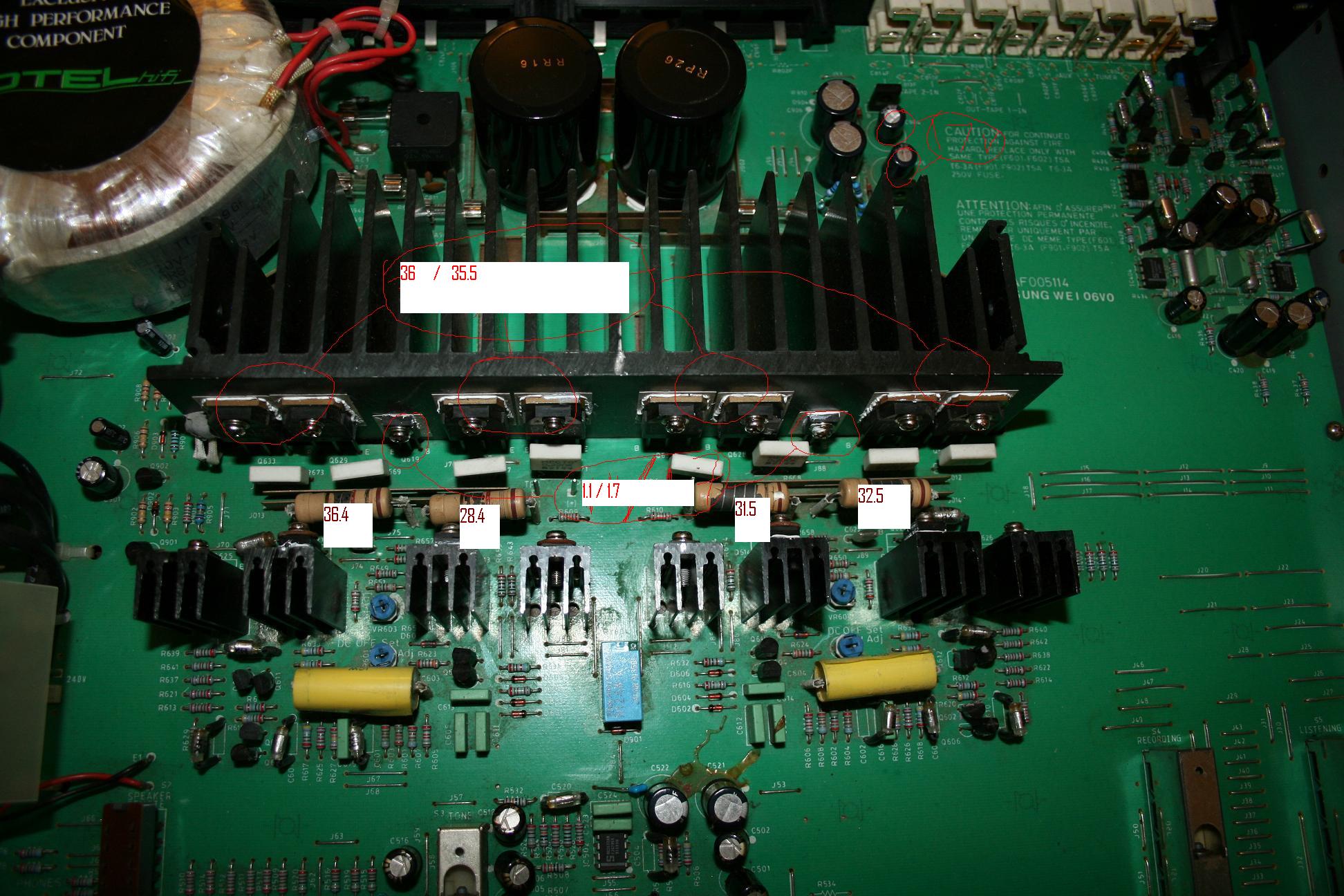

Hello Ian it was a bargin actually lol. I bought it for £20 about 6 months back. It had so many black gate caps init I thought to my myself cant go wrong even for parts!
As you can see right have very little dc off set with the bias turned all the the way down and left has a little more. I think the setting is millivolts. so right is 0.004 v and left is .040 v
The one things I did notice was when headphones connect dc off set set at highest rating I could hear half decent sound. When dc off set was set lowest like now I could only hear distortion via headphones. Alo I get 0 volts across the test terminal for bias adjust, adove dc adjust. dc off set adjust is closest to big yellow cap.

Are fuses F601,2 making good, firm contact withe holders? Have you measured the supply to Q903,4 collectors yet? 'Better look at the voltage on the collectors of the output transistors too (that's the centre pin and/or the metal backplate).
Simply test the marked voltages on the schematic that are associated with the DC side of the power supply and both output stages. It's likely there will still be differences between channels and it's better to know what they are. If you have one channel working, it always makes a good reality check or rather, a comparison for correct operation, for the other. If you see any clear departures from the spec or differences as suggested, please tell us.

Plus...
The fried 3W 1k resistors that limit bias current to the drivers, R683-686 may appear damaged but could still be OK. Coatings shrink and peel more easily from larger diameter parts and this may not be quite the disaster it looks.

Q903/4 have 36v going in and 17 and 17.5 as per sm manual. its suppose to be 41v but everything else checks out.
None of the channels work! pretty much same level of distortion.
There is no shorts on the transistors I checked them once before.
I also suspected the 3w resistors but they seem fine. As far as I know. Resistance checks out.

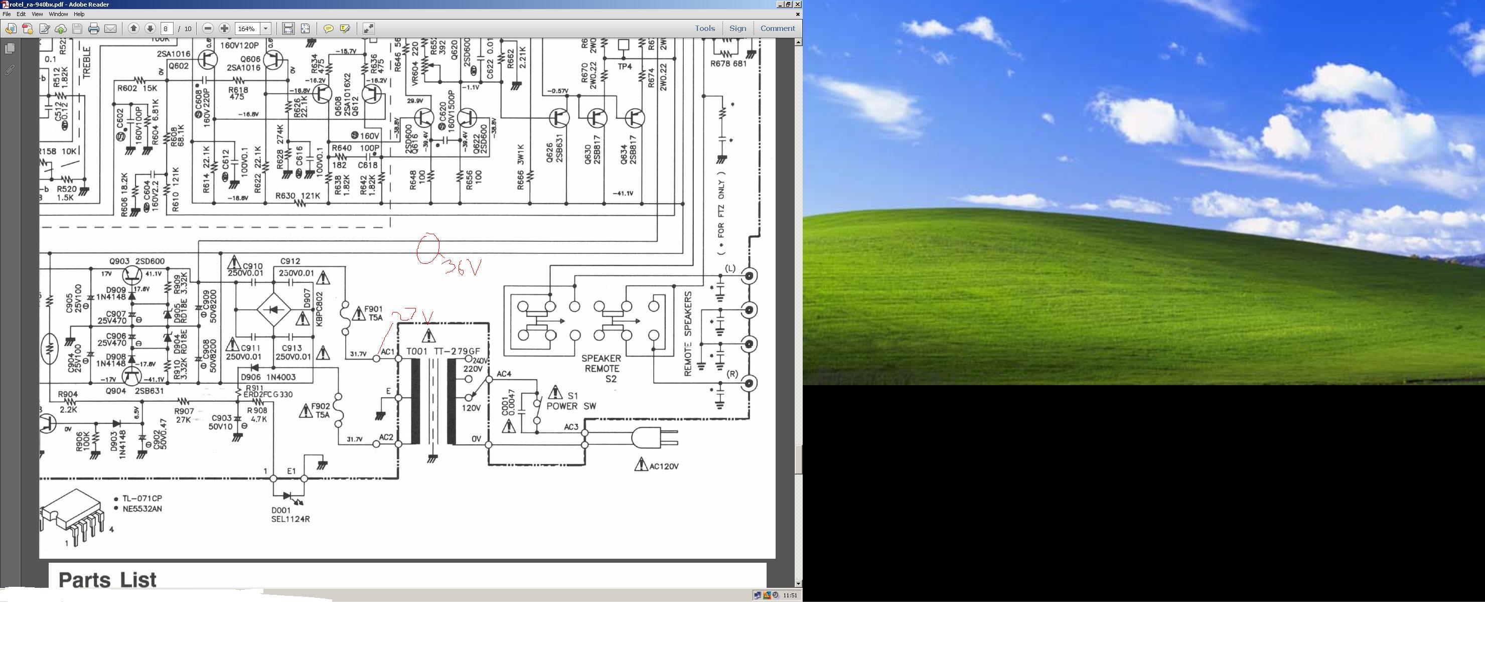

I just measure the transformer and it said 27.1v! the markings on the unit itself say 28.3v. so it was never going to be 31.7v input ac!?!?
Correct, the transformer is either a replacement from a similar amplifier (it's not a standard type with that voltage rating) or a change not shown on that issue of Rotel's service manual. (ex - Hifiengine, by the appearance) I suspect the former and I suspect there have been other repairs before too. The specification for this model seems to change from one retro reviewer to another on the net, so there is confusion as usual among those who like to recycle audio systems.
However, that won't affect operation other than the maximum power available before clipping, which is seldom a problem unless you live in a large house or have free reign to play loud. You have +/-36V which is still fine and should deliver 50W/8R or thereabouts unless it suddenly disappears when you connect a load to the amplifier, which I doubt is the basic problem but you could recheck these voltages at the output stage when the amplifier is connected to the speakers (as briefly as possible) to dispel notions about the transformer being faulty.
I'd be interested to know how you tested the output transistors as all being good, unless you had removed the paralleled transistors to test them thoroughly for shorts or open circuits. Neither can you properly test a diode bridge without disconnecting the transformer but from the balanced rail voltages, it appears to be OK.
Again, were all the Vbe measurements for these output transistors and drivers aprroximately correct? What did you measure for Vce of the output transistors (yes, that means the voltage between Emitter and Collector). Now take a look at the markings on those transistors - what brand or logo are they? Are they poorly laser etched, printed or foil marked? Any other marks like a date/batch/grade code? Are the heatsinks electrically isolated from the circuit? (the anodizing is an insulator so make contact with a bright aluminium surface, such as a hole or worn edge).
Not sure what you mean by "..main diode at the outputs...". Surely it has a part no. reference.
Assuming there weren't actually any problems with the output stage, we'd really need to see what signal you have before it so that we can systematically test the amplifier. You need an oscillosope and signal generator or at least an audio millivoltmeter for that and you may understand that a DMM is not really adequate for other than DC checks on power amplifiers and components. There is little available in a meter alone to conclusively test operation so you are left with systematically going through the smaller transistors for C-E shorts and Vbe checks.
The list of possibilities goes on without more specific feedback but I notice you are also pursuing this matter concurrently on another forum and perhaps hedging your bets. Make up your mind and follow through on one set of advice or the other.

Hello Ian, dont be mad I'm just trying all options to resolve this. Everyone seems puzzled by this. I am really exited about finding out what the issue is.
I did take out ALL transistors and bridge diode there were no shorts and everything seemed ok to my limited knowledge, I'm pretty sure I was thorough. The main transistors the big ones seem all original. From what I remember they all seemed high quality originals/replacements of same.
By main diode I meant bridge diode. The outputs measured 36v in circuit.
I still get no voltage reading on bias adjust 0v.

Guys I willing to do what ever! but understand if the sm manual is wrong Im only getting 36 volts out of bridge diode. and 27 volts from transformer. sm states 31v from transformer and 41v from bridge diode. if 36 is acceptable then the issue lies else where.
i have already tested ALL transistors off board they seem fine unless in circuit they behave different. All main transistors have 36v going in from main. Suggesting they are getting the voltage setout by the bridge diode.
I like the idea of testing the circuit in another amp, thats easiest for me I think. i did conect small speaker to volume control and it did not have distorted sound!
I will test all voltage going into transistors and post results.

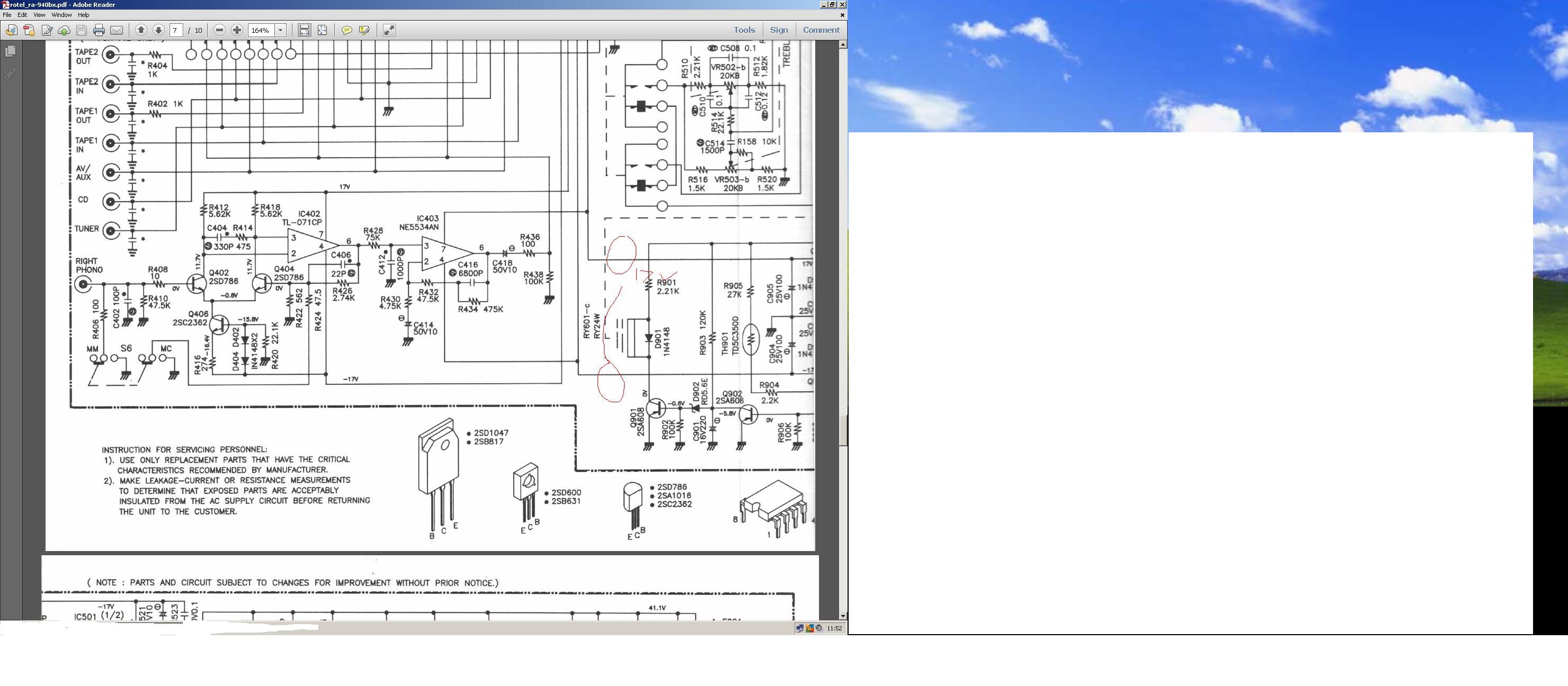

The 28V value is not the good one, either it s the driver that is attached to this resistance that is faulty, or it doesnt get the good command voltage.
Could you check visualy the value of R659/661 and R660/662..?.
If value is 2.2K as in the schematic unsolder a end and measure them to see if they are not in open circuit, of course with the amp being off.....
the resistors look good they all measure 1.42k in circuit. sm states 2.21k. I can unsolder tomorrow and check.
