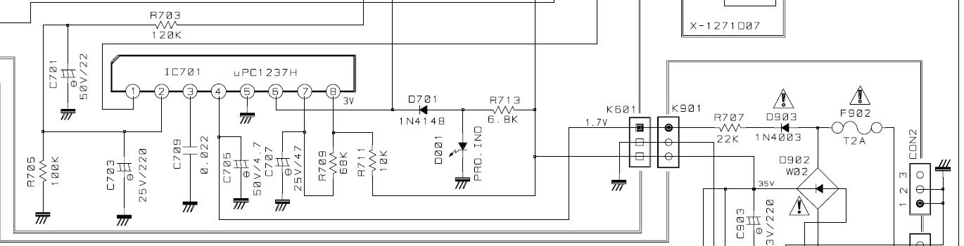

I'm woking from solely from the schematic, so I could be overlooking something. But it appears that there's delayed turn-on established by R13,C14 in concert with T11, T12 and relay RY901. Delay of relay would be very roughly 2 to 3 seconds from plug-strip activation. There may be additional delay arising from the protection ICs, but I haven't studied those circuits yet. When you open the amp, you might look for these delay features.
The work-around idea I was alluding to is to the leave the small transformer (T101) permanently powered, and use an odninary spst front-panel switch to switch B+ to the delay circuit, i.e. switch installed between connectors K104 pin 1 and K13 pin 3.

The power on delay of speaker activation seems to be handled by uPC1237 chip (datasheet available in internet).More when turning on. Just seemed like a quck pop and didn't sound right. Not a pop in the sense of blowing anything, just abrupt.
To increase the power on delay you need to add capacitance on pin 7 - quite easy to test.

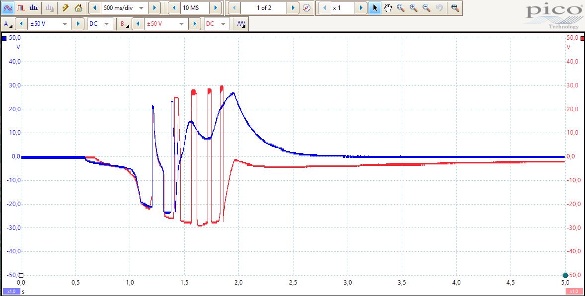

The delay may be too short for the output to stabilize - when you put a digital scope on the output before the relay then you will probably see something like this:
I have been forced to increase the delay from 4 seconds to 7 seconds on some amplifiers.

You should also check that there is no DC on the output. If DC is present then adjusting the delay will not solve the core problem.I will investigate this.
