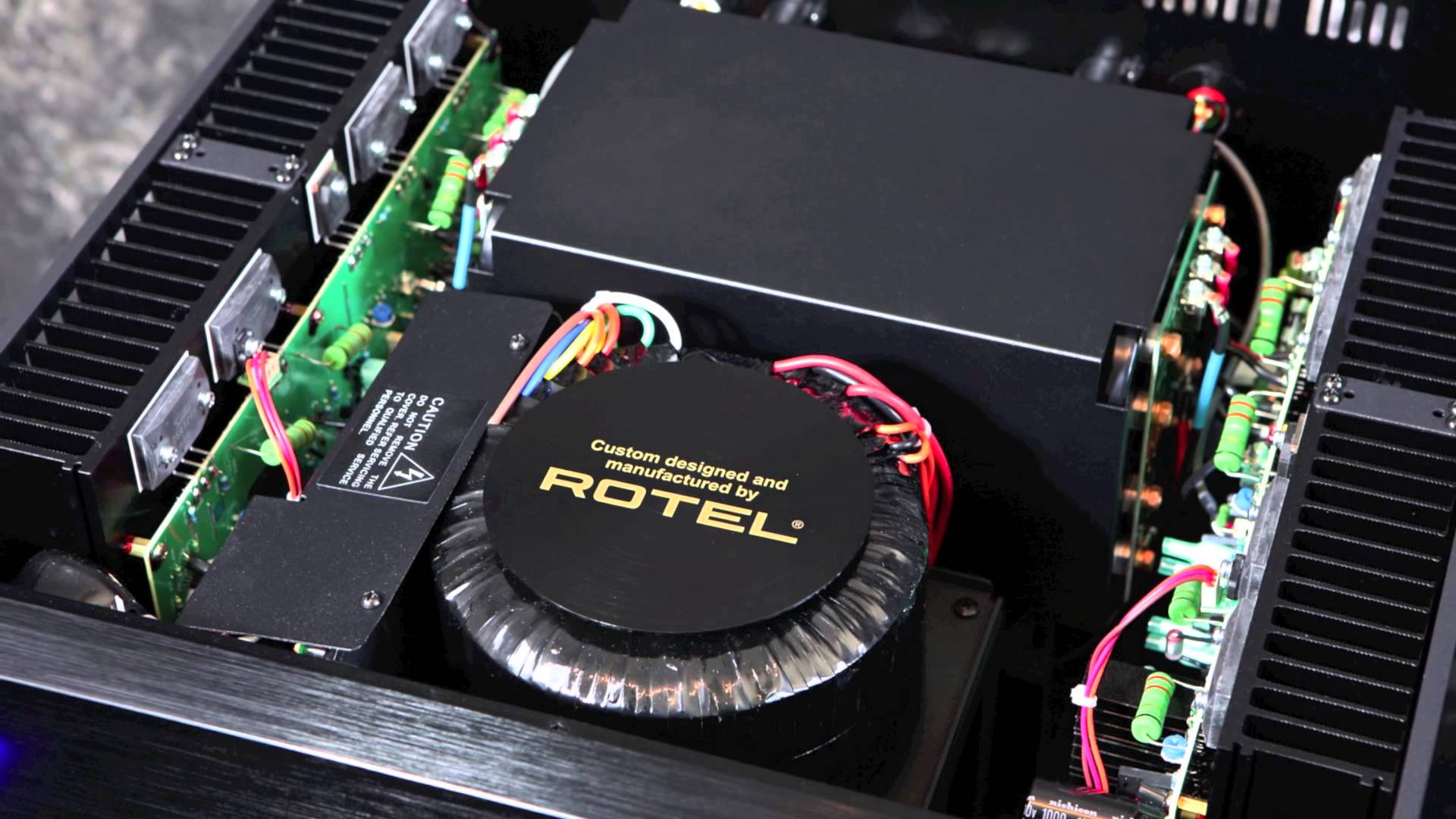

- from the pictures, I can see on one of the transistors written 2SC3264 which has maximum voltage 230V (about right to pick a transistor with 230V if the power rails are + - 100V, or in other words 200V difference) and maximum current 17A. So definitely to get the peak current 21.6 A there should be at least 2 in parallel. Without a schematic, I am not sure where that transistor is used and how many are in parallel, or if the limitation is arbitrary (the designer thoughts could have been: let's put 2 transistors of 17A in parallel and due to components dispersion one transistor can get 30% more current than the other therefore he considered safe to limit the total current to 21.6 A ?!?). Maybe there are 4 transistors in parallel and then 50A output is possible from the transistors' point of view, and if that is the case the current limit could be there to not exceed the maximum output of the supply transformers (also bridge rectifier and capacitors maybe) or maximum power (heat) dissipation on transistors and/or transformers. Without the schematic is just guessing.

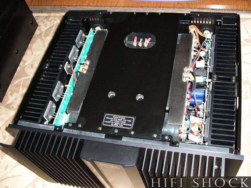

Running that amplifier at 50A output current for more than a few milliseconds is a sure way to get the output transistors to self destruct. Don't forget that the supply transformers also need to be able to supply that amount of current, which they won't for very long without fusing. If the transformers can supply 800 watts, then that is the maximum continuous power (less the maximum efficiency factor for class AB) available, regardless of what the load impedance is. Also the dissipation in the output transistors will rise with lower impedance loads, so the heatsinks will run out of capacity very quickly. Designing the power supply, output stages and heatsinks for delivering continuous power into 1Ω would quadruple the engineering cost compared designing for continuous power into 4Ω, and for what purpose? Such a specification isn't relevant to 99.99% of Rotel customers.

Just FYI, the RB-1590 seems to have 4 transistors per channel (2x 2SA1295, 2x 2SC3264).
I am not knocking the 1590 or Rotel, just trying to restore perspective.Ah, OK. Thanks for your explanation.

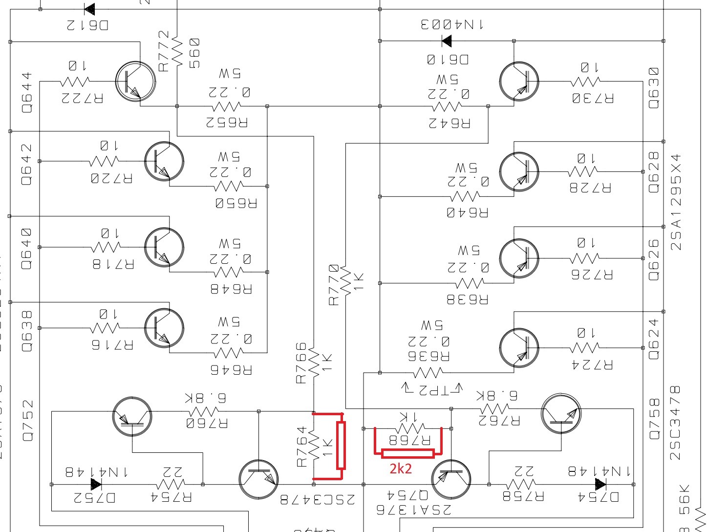

There you go: Each have 17A max current, in a theoretically perfect parallel connection of 2, you can have max 34A (less than claimed 50A). If you want to design a reliable product you don't go up to 17A, you stay preferably way under 15A peak current per transistor.the RB-1590 seems to have 4 transistors per channel (2x 2SA1295, 2x 2SC3264).
If you want to play with fire, you can add a 2.2 kohms resistor in RB-1590 in parallel with each of the equivalent of R764 and R768 (1kohm) from RB-1090 (see attached RB-1090 picture, 2 resistors in red per channel, both 2k2). This is based on RB-1090, schematic, resistor values and schematic could be different in RB-1590, do it at your own risk, you may destroy your amplifier! I picked 2.2kohms value in parallel with the exiting 1kohm for an increase from15A to about 20A in the protection current (again based on assuming RB-1590 schematic and resistor values are the same as in RB-1090 schematic, only having 2 transistors in parallel instead of 4 in the final stage!).My understanding is that the RB-1590 is based on the older Rotel RB-1090 (for which schematics are readily available online).
If you want to play with fire...

... (again based on assuming RB-1590 schematic and resistor values are the same as in RB-1090 schematic, only having 2 transistors in parallel instead of 4 in the final stage!).
The final stage of the RB-1590 should be very similar, if not identical, to the RB-1090. Their ouput powers are virtually identical:
- RB-1590 (as measured by Hifi News): 490W/805W (8/4 Ohms)
- RB-1090 (as measured by stereophile): 437W/~800W (8/4 Ohms)
Based on those numbers the power supply for the older 1090 is 'stiffer' than that of the 1590, which if as good would produce 897W into 4Ω. In any case, I'm not sure how similar power outputs implies anything about similarity of the final stages of the two.
