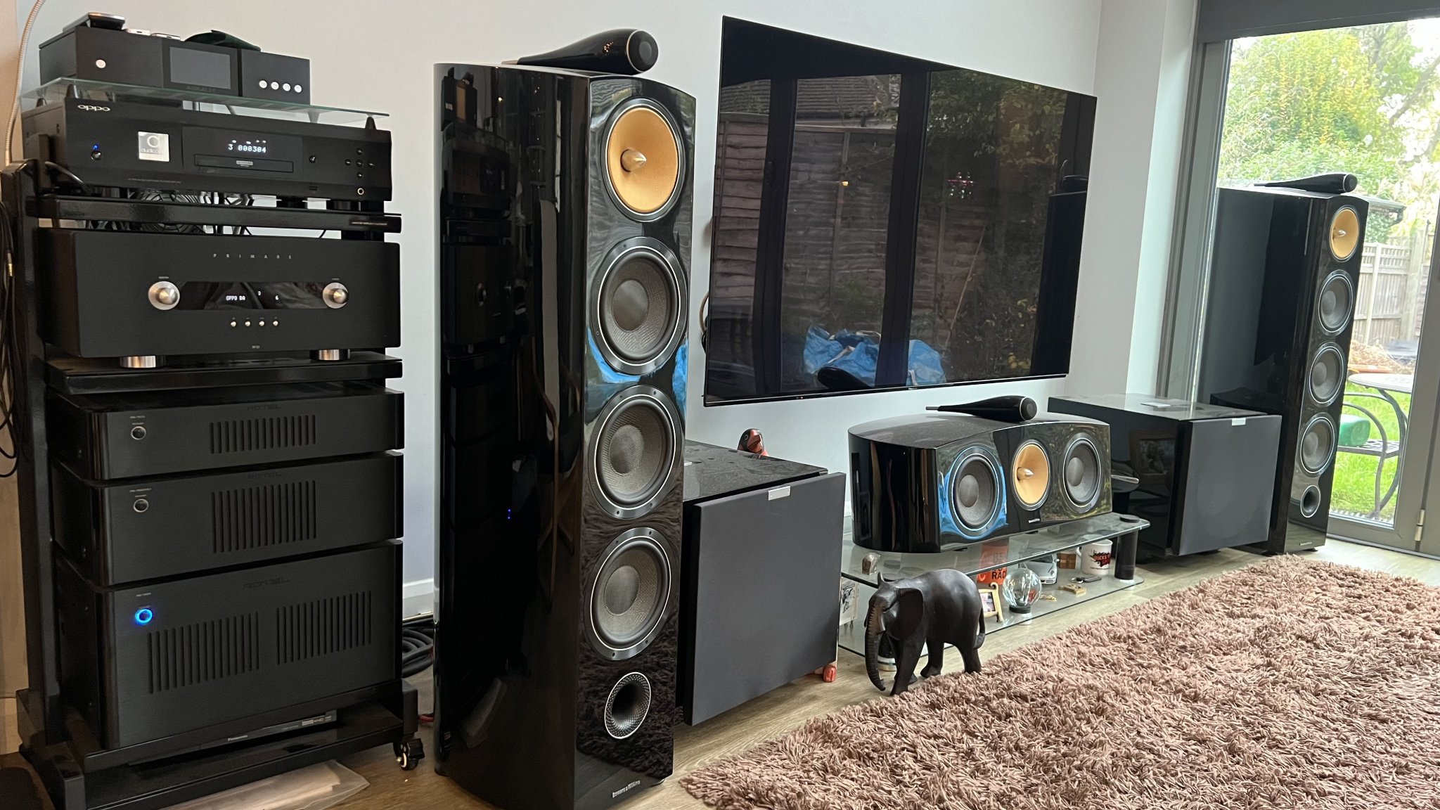

Hi thanks for allowing me to join this group.
My system has been working flawlessly for years but today I noticed the main amp was still powering the main speakers with the blue off , power ring button released !
Still sounds great but would appear to be permanently active .

You need to provide the exact Model number for your power-amp.

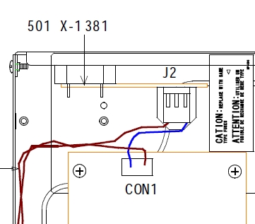

The thing you´ve shown is an IEC inlet, not a switch, and J-2 is a plug on the PCB...... Not a switch.
There´s most probably a softstart circuit with a mains swithing relay somewhere inside, Most certainly welded contacts on the relay.
The reason I ask for the proper model number (letters AND numbers) is, that all I can find with "1060" is RA-1060
which is an integrated amp. Picture shows 3 amps of the RB-kind. 😉

I think you might be wrong here.According to the schematic, J2 is a conventional switch, so I think this will be your problem.

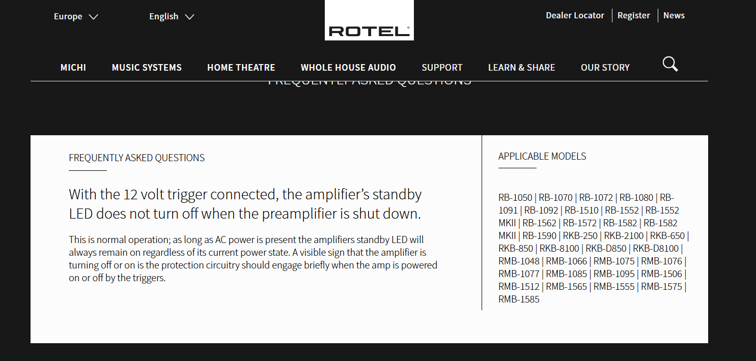

It’s a rb1560 !
Nothing found on web.
Even Rotel´s support webside does not list an amp with that model number.
Hmmm 🙂
Hmmmm 🙂but today I noticed the main amp was still powering the main speakers with the blue off , power ring button released
- Rotel RB-1590
