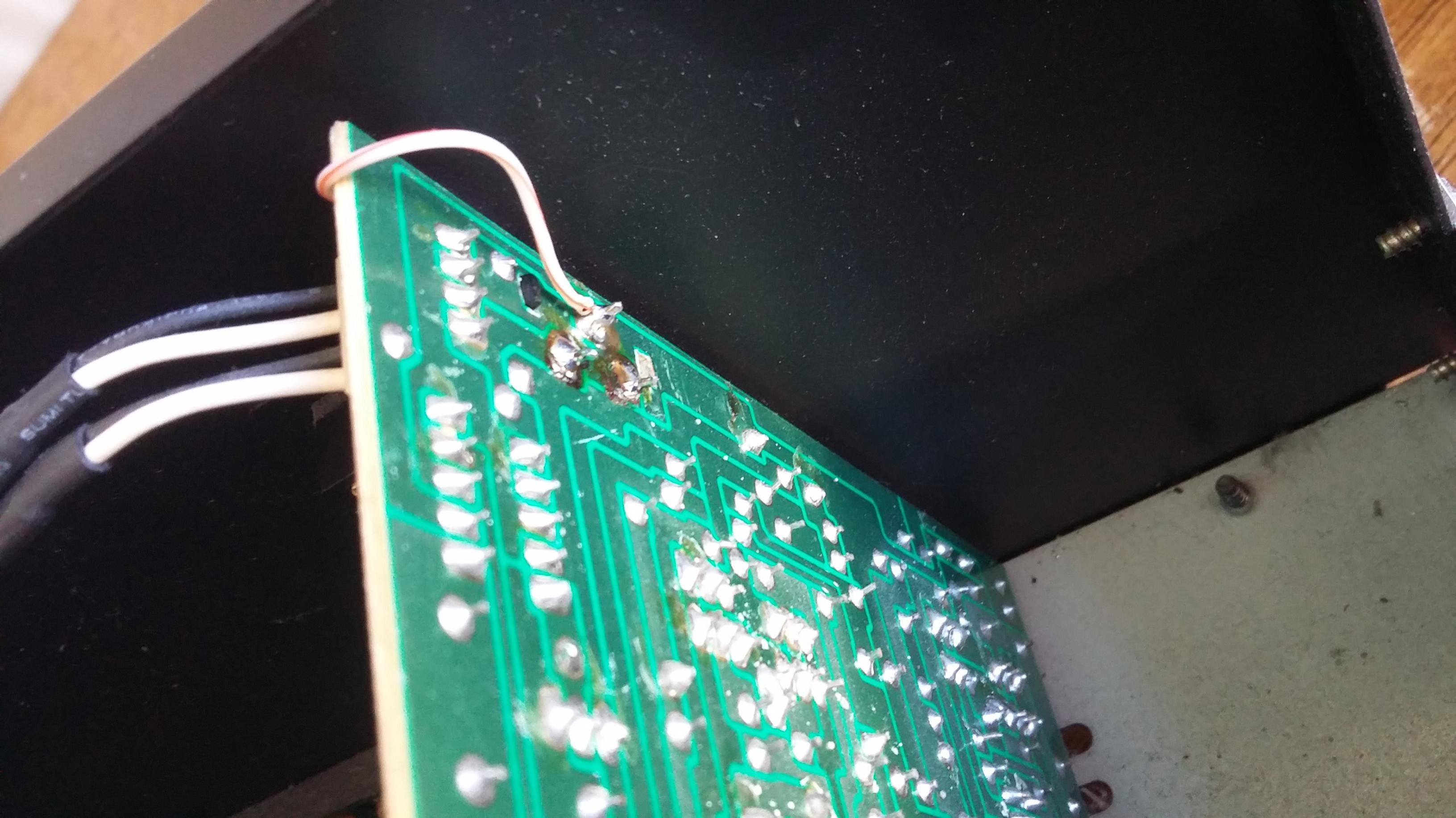

I'd look at the RCA blocks ground into the circuit boards. I have a RB 985MKII which has a similar RCA input scheme. RCA blocks held to rear panel with screw, circuit boards attached to right and left side panel heat sinks. When it was shipped to me, the package was mishandled and chassis must have twisted, breaking a ground pin on one of the outer RCA blocks.
Rather than search for an RCA block, I soldered a ground wire from board to RCA ground.
An example of a board mounted RCA block.

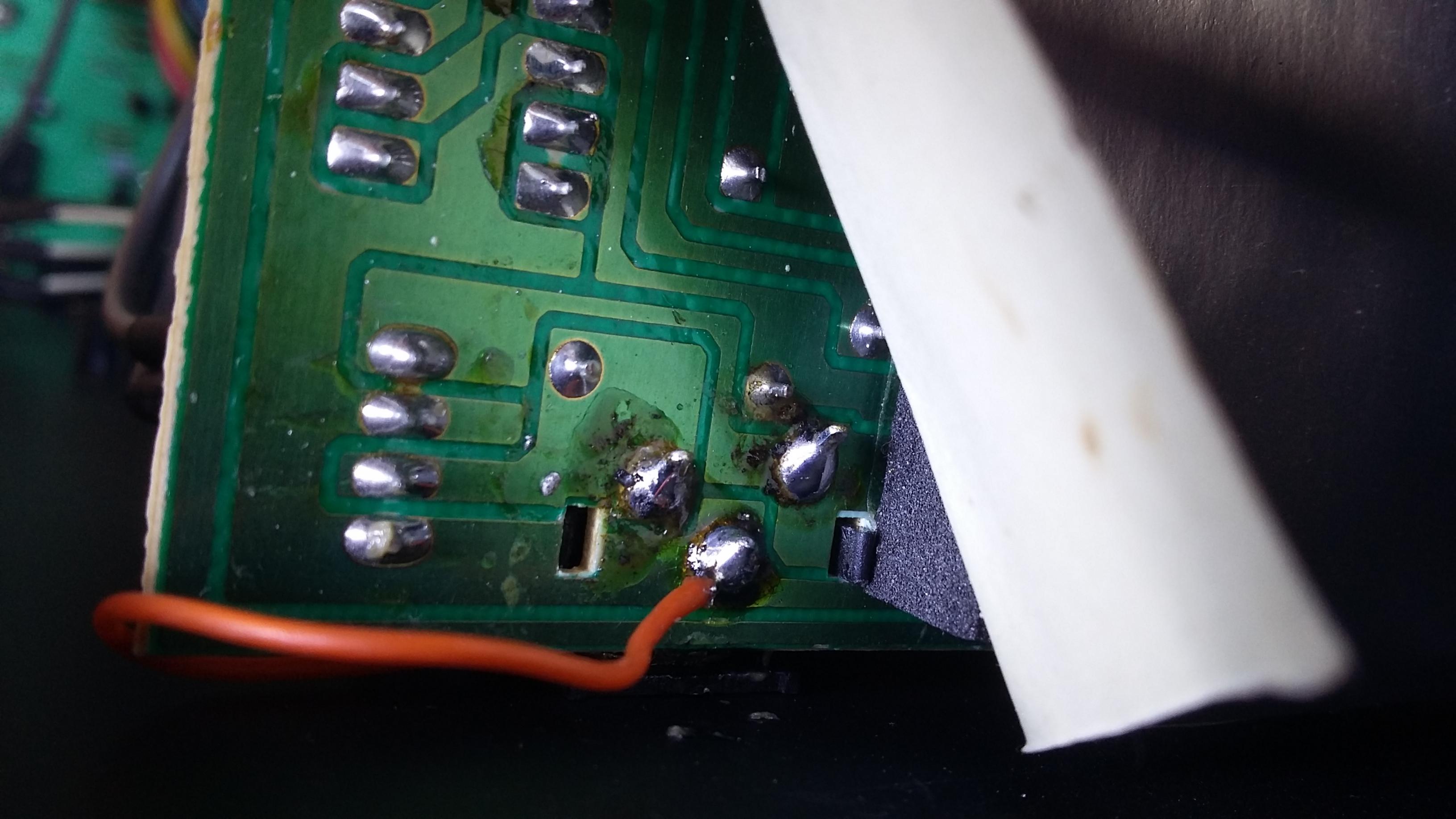

same problem
I have exactly the same problem with my Rotel MK-985 MKII. The buzzing happens only on right surround and right front channels. Other channels work just fine. The buzzing starts as soon as I connect RCA middle pin (not even touching the ground yet).
I measured the bias voltages on all the channels. They were between 3-4 mV. I did not warm up the amplifier as instructed since I don't have proper speakers for load.
The components seem to be ok with visual check. I also checked the diodes D903, D904, D905, D906. They are ok.
I uploaded the service manual if someone finds it useful here.
Could someone identify the AC input filter caps from the schema, please? Should I start by replacing them?
