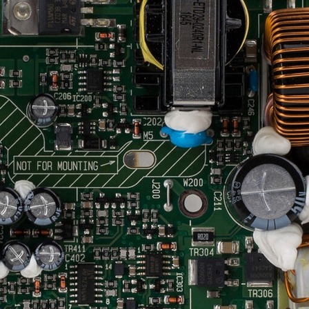

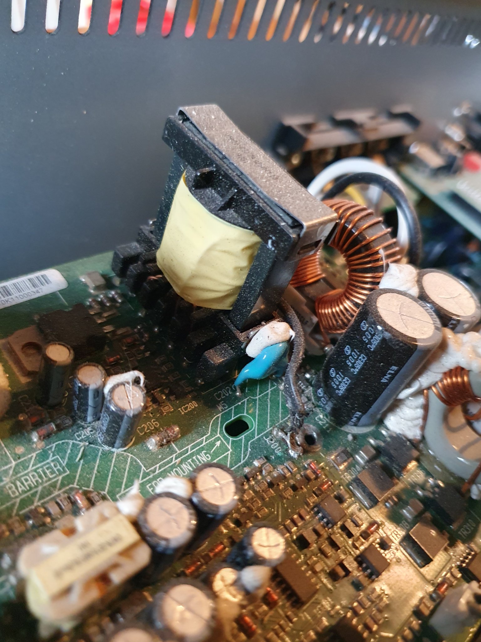

hi I've bought a rcx1500 to try and fix from ebay. the issue was described as a CD stuck inside this doesn't seem to be the case however opening the unit I find that it uses the icepower 200asc module .
I've noticed a wire dangling suspiciously does anyone have any idea what this might be ? anything else i need to be aware of when trying to fox this is there anyway of checking the capacitors are discharged with them still attached ? bought as a learning exercise but would be nice to get it up and running again thanks

OK thanks I had look at the datasheet and didn't see any mention of it definitely looks a bit sloppy so I can assume it's been repaired before .these units seems plaged with problems so i should have dond my reaserch but it would be nice If I could salvage the amplifier modules
When discharged, a few one or two volts will remain on the big caps and again slowly rise but that is of no concern to your safety.

I don't want to disappoint you but debugging such a power supply isn't straightforward. First you will need a schematic and I doubt this will exist. Perhaps some experienced members with this particular supply can help you out but I doubt this is an easy job.
