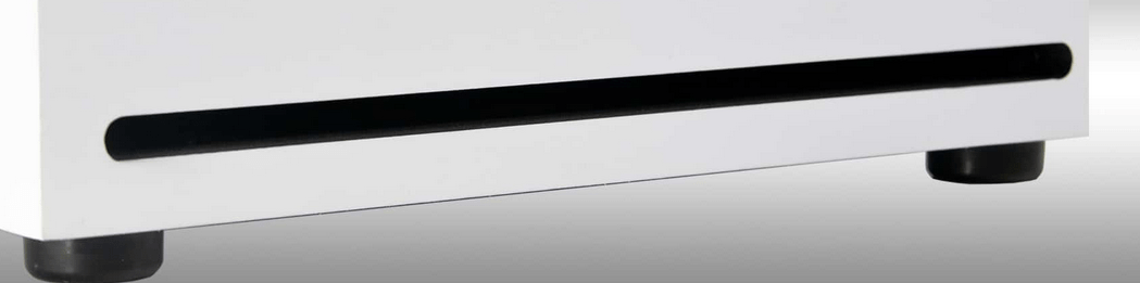

I went ahead and got the RSL speedwoofer. I'm excited to re-house it. I've got the opportunity to redesign the port, but without any raw driver figures I'm not sure how to go about that. Does anybody have any ideas for improvements on the narrow slot port?
Normally you would have to take the driver out and measure its specs for simming purposes, though I imagine it's already optimized as much as practical without designing a whole new cab alignment, in which case better to just DIY from scratch.

The narrow slot port located on the cabinet wall tunes lower for a given length and volume of cabinet space than would one of a lower aspect ratio.
"Improvement" by making the port a more typical shape with the same or more area would require making it much longer, requiring more box volume to account for volume lost to the port, and DSP corrections for it's different pipe resonance.
Since the DSP is built in, probably not user adjustable.
Before considering any improvements, determine the Fb (box tuning). Do a frequency sweep near the low end of the driver, excursion should be at minimum at Fb.
Once you have determined Fb, you can verify the new box Fb comes in at the same frequency.

Ah thats cool. Thank you @weltersys. I figured as long as the surface area of the port was unchanged a less narrow slot might not chuff as bad. Who knows? But I'll probably just copy the port in my new housing.
