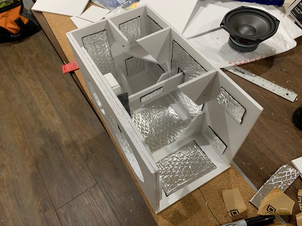

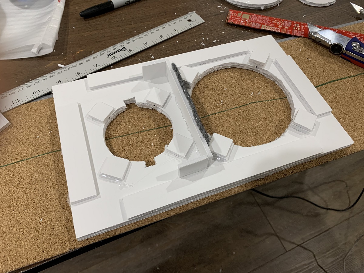

Here are some photos of the construction:
Here is the assembled speaker:

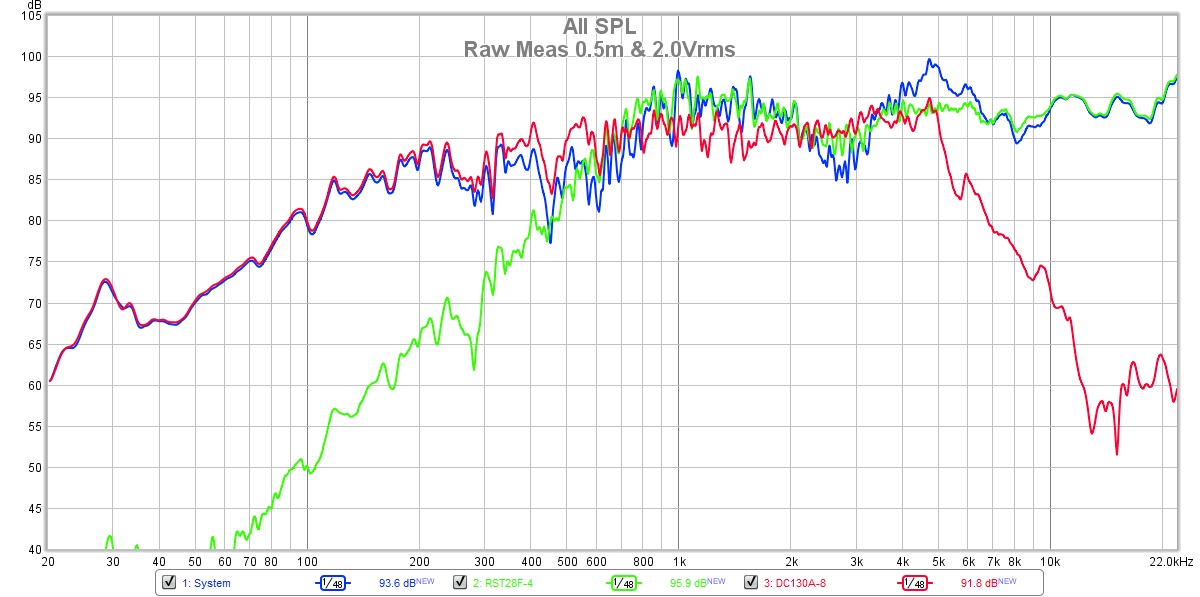

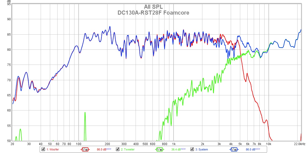

The measured raw responses of the drivers:

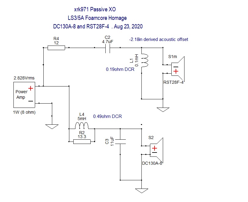

Here is first cut at the crossover (asymmetric Harsch-like with inverted tweeter):

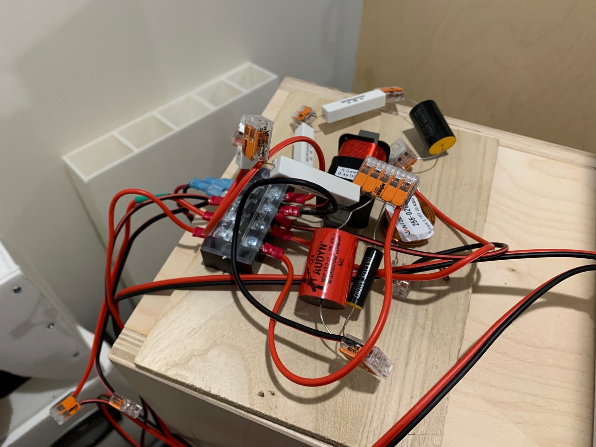

Here is the XO implemented outside with Wago connectors:
Here are the Crossover Part Numbers from Parts Express (per speaker)
L4 = 5mH 18ga #275-141 qnty 1
L1 = 0.1mH 20ga #257-568 qnty 1
C2 = 4.7uF MKP #255-020 qnty 1
C3A = 10uF MKP #027-114 qnty 1
C3B = 1uF MKP #027-410 qnty 1
R2A, R4 = 12.5ohm #006-12.5 qnty 2
R2B = 1.0ohm #006-027-101 qnty 1
C3 = C3A+C3B
R2 = R2A+R2B

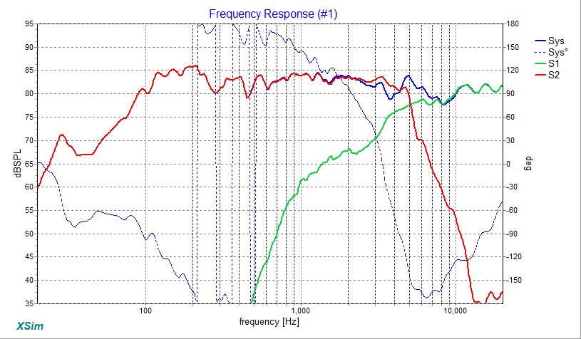

Here is the predicted frequency response:
For comparison, here is the measured response of a typical LS3/5A:

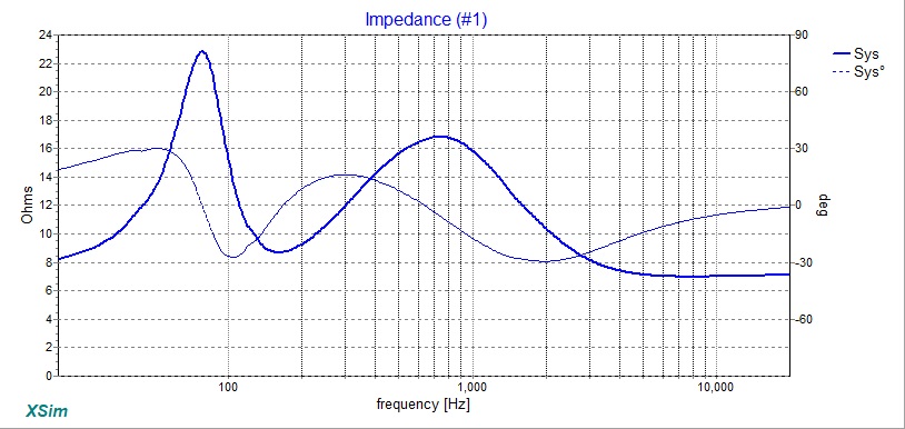

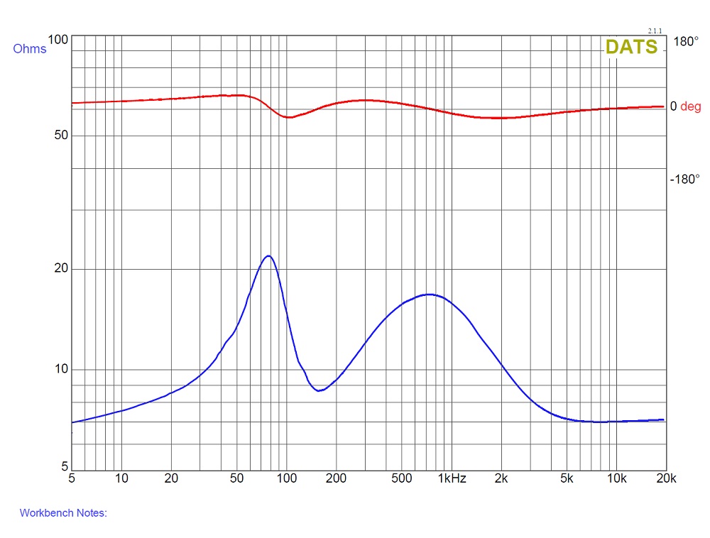

Here is the predicted impedance - very benign and nominally 7 to 8ohms with a 22ohm peak at box tuning:

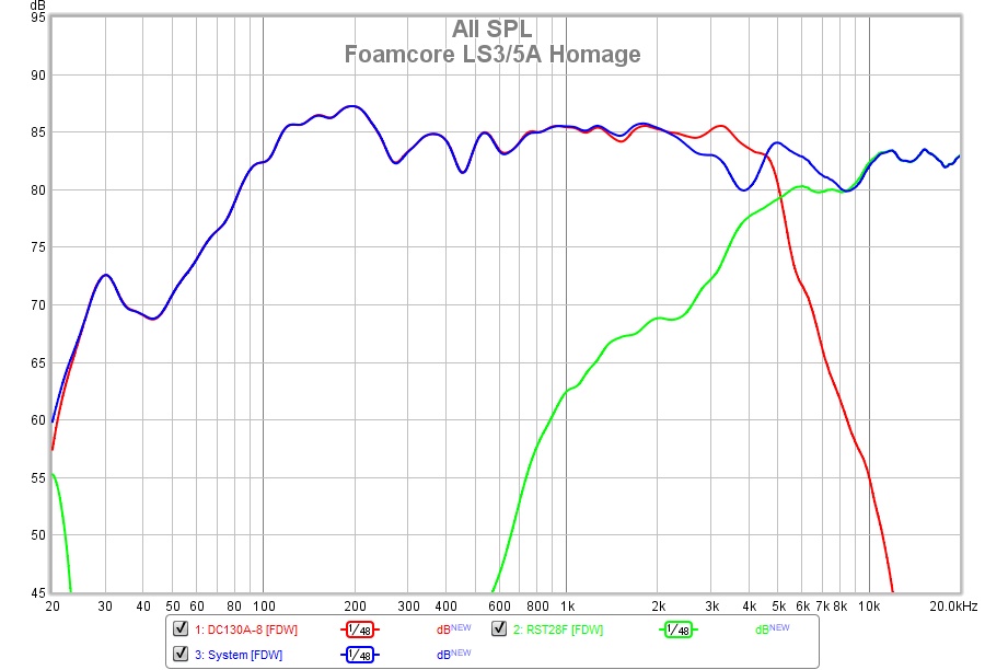

Here is the measured frequency response of the XO - note the wiggle in summed values around the XO - results from the asymmetric slopes in a Harsch-like approach:
Edit 8/25/2020: I remeasured the freq response a few days later and applied 7cycle FDW to match closer the smoothing of the Stereophile data:

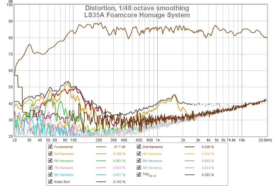

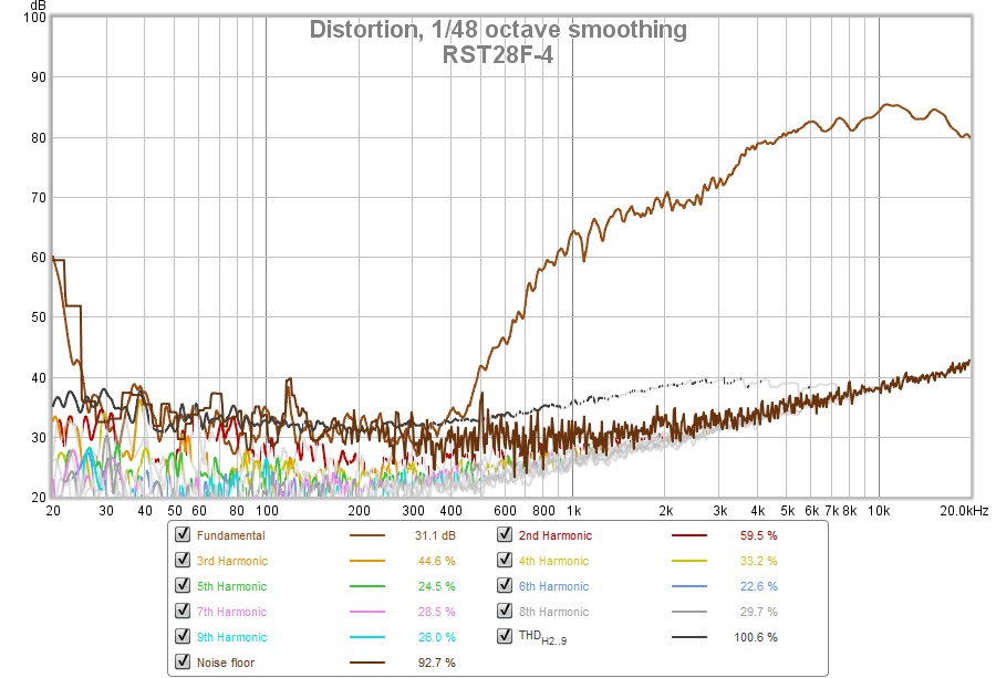

Here is the corresponding HD vs frequency at 0.5m and 2.0Vrms:

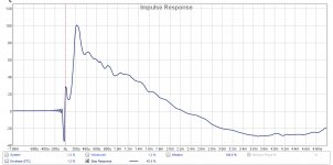

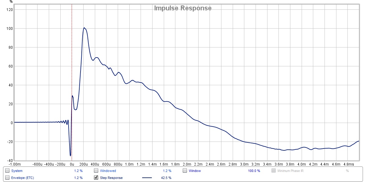

Here is the measured Step Response:
This is the measured system impedance with XO and inside the box:

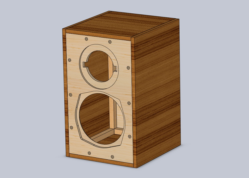

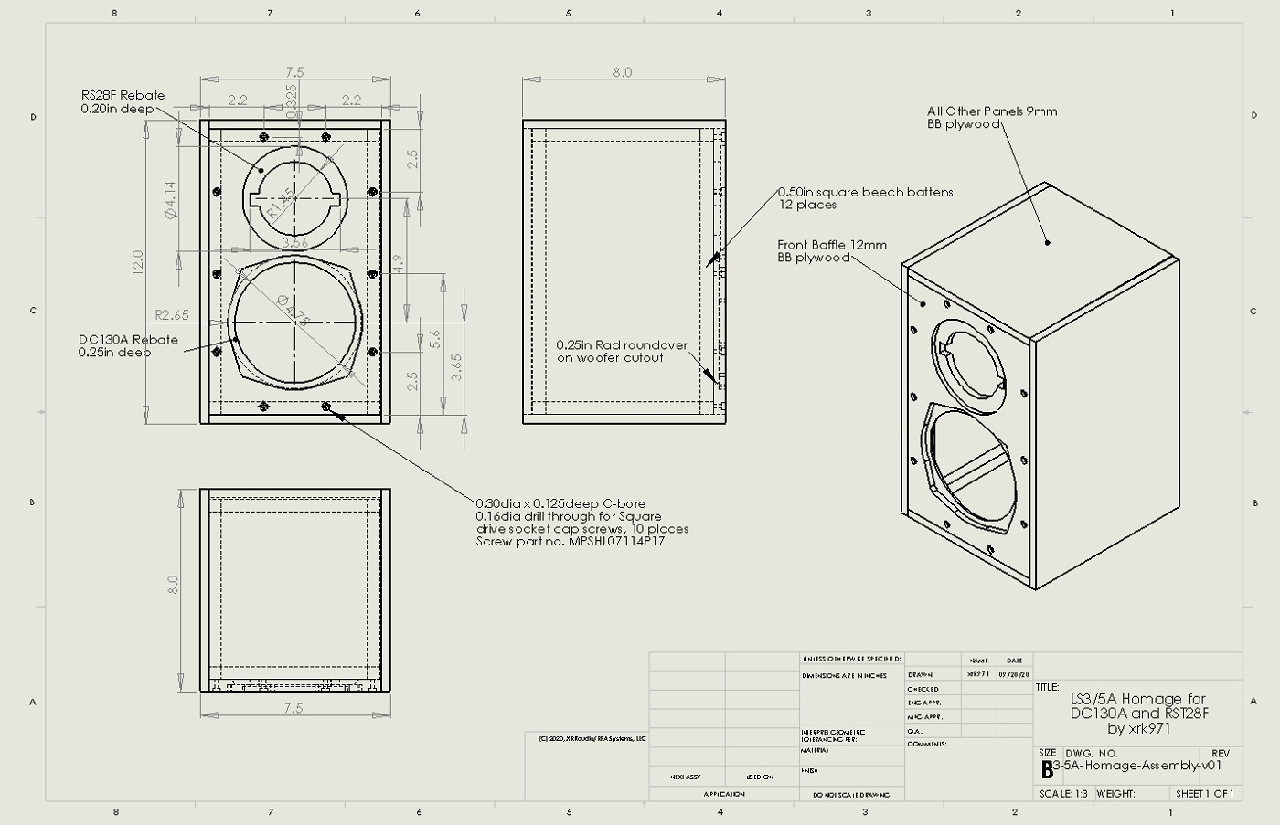

3D CAD plans for 9mm BB ply version with beech battens and 12mm baffle to allow for rebates for flush front mounted drivers:

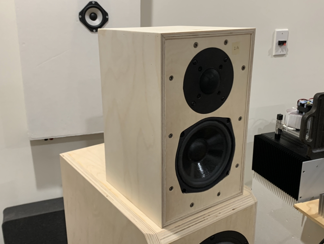

Edit Dev 5, 2020: wooden cabinets - called Rockville’s now finished and playing nicely. These speakers sound superb as near field monitors.

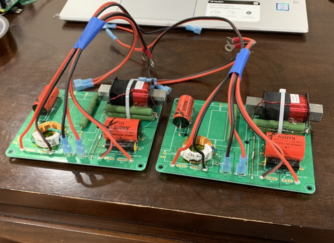

Crossover boards:

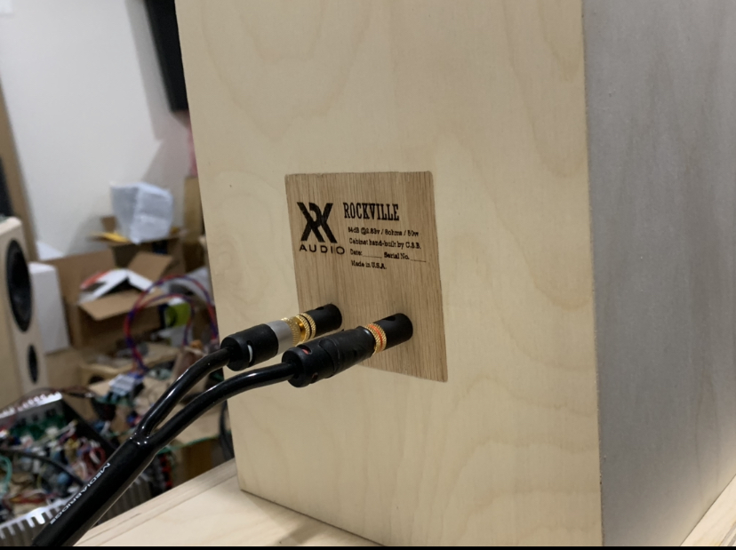

Back panel with name plate made (same as battens) from Civil War era white oak from a razed barn near Rockville Maryland.
C3 = C3A+C3B
R2 = R2A+R2B
Crossover boards:

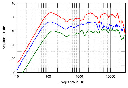

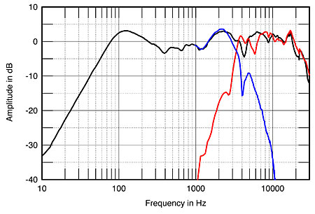

It depends on the year and manufacturer I guess. Here is Stereophile review of a Stirling which has the dip but when compared to 1978 Rogers or 1996 KEF, they don’t have a dip?
BBC LS3/5a loudspeaker Stirling Measurements | Stereophile.com
Stirling crossover response:
It would seem that an elevated 2kHz bump would give extreme presence.
The Stereophile measurements look a lot lumpier than the above reference response which I got from the German website on DIY shootout of LS3/5A.

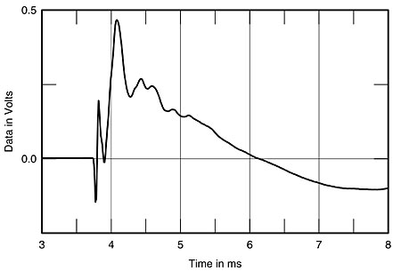

It is interesting to see that the Stereophile measured step response looks almost exactly like mine with a negative sharp overshoot followed by one postive sharp peak closely spaced to the main right triangle:
Here is the step response from mine:
![666SB35fig3.jpg](https://www.stereophile.com/images/archivesart/666SB35fig3.jpg)
![666SB35fig2.jpg](https://www.stereophile.com/images/archivesart/666SB35fig2.jpg)
![666SB35fig5.jpg](https://www.stereophile.com/images/archivesart/666SB35fig5.jpg)

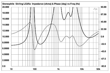

And speaking lof crossovers, the LS3/5A official crossover has 13 components I think. Mine has 6. Does it really need 7 more components to make it more complex and presenting an impedance plot that looks like this (this isn’t particularly what I would call, an easy to drive load):
Vs the impedance and fairly smooth electrical phase from mine:
![666SB35fig1.jpg](https://www.stereophile.com/images/archivesart/666SB35fig1.jpg)

For easy reference, here is the Stereophile measurement of the 1996 Stirling LS3/5A:

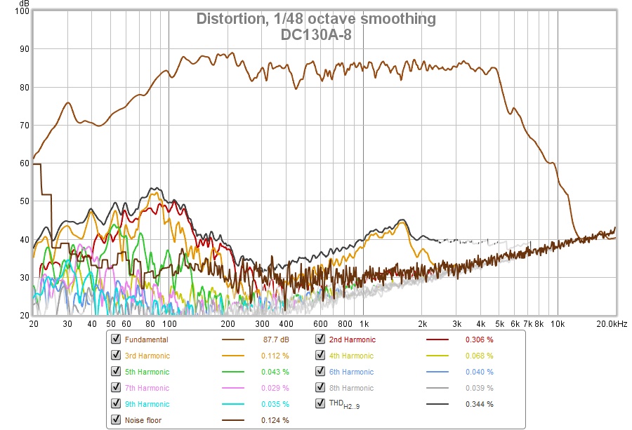

SPL measured at 0.5m on tweeter axis with 2.0Vrms. I actually have a -3.8dB (from nominal 83.8dB average SPL) dip at 3.9kHz. My XO is totally different of course...:
HD vs freq of the woofer (there is a 1.5kHz harmonic distortion bump that is intrinsic to the driver), the rest of the box resonances seem well controlled with the Noico damping, braces, and melamine foam pads. The rise in HD below 100Hz is also intrinsic to any5.25in woofer in a sealed box - even more expensive drivers like the AC130F1 used in Bagby's Continuum exhibits similar distortion:
HD vs freq of the tweeter - dang! This tweeter measures very well! Not bad for a $36 unit:
HD vs freq of the Combined System - try not to expect too much below 100Hz:
