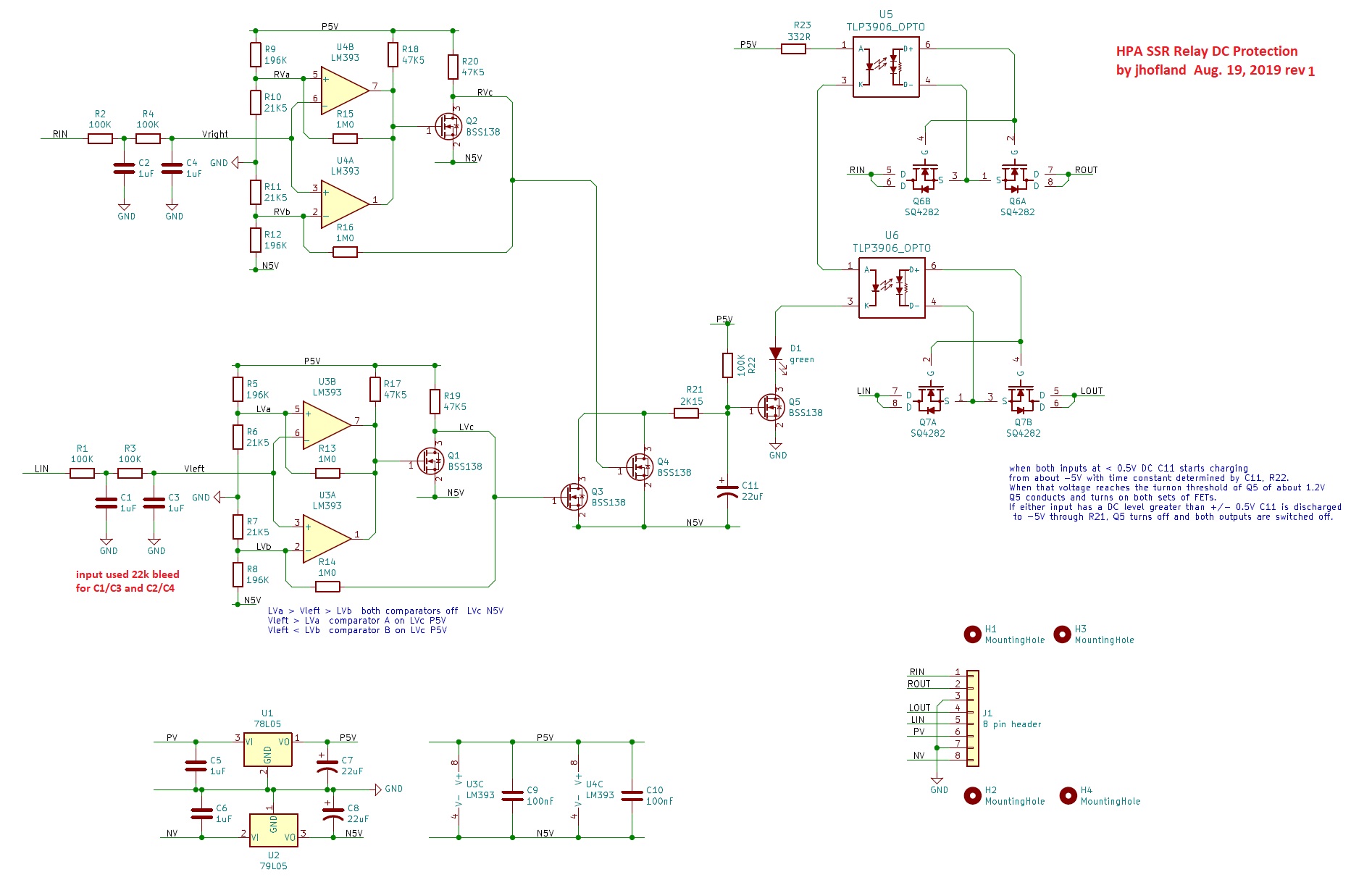

Jhofland has designed a very slick solid state relay (SSR) headphone DC protection module that has no mechanical relay to wear out and uses ultra low Rdson MOSFETs that do not alter the signal in any way (as previously shown via measurements on the RTR SSR DC protection board for speakers). This unit however uses comparators to check for the DC offset, which is set at +/-500mV. A CRC filter is used prevent audio transients from inadvertantly triggering the relay. The comparators then trigger an optoisolator which then activates the gates of a pair of back-to-back MOSFETs as the SSR. The module is also stereo, so only a single board is needed for a headphone amplifier. It needs a +/- voltage power supply from the amp's rails with at least +/-8vdc and less than +/-30vdc. This is regulated down to +/-5vdc for the comparators to function. The MOSFETs are rated to 30v presently and are 10mOhm RDson units SQ4282EY)
Unit is very compact: 45mm x 37.5mm and uses 8-pin Molex KK connector for all connections.
Works great for DC coupled preamps as well to avoid turn on / turn-off thump. Delay for turn on is 2.5 seconds, turn off depends on how quickly PSU caps bleed off upon power off. But generally turn off thump is not as bad as turn on thump.
Schematic:
776406d1566273795-cheap-chips-opa1688-low-thd-muscle-amp-hpa-ssr-protect-schematic-jpg

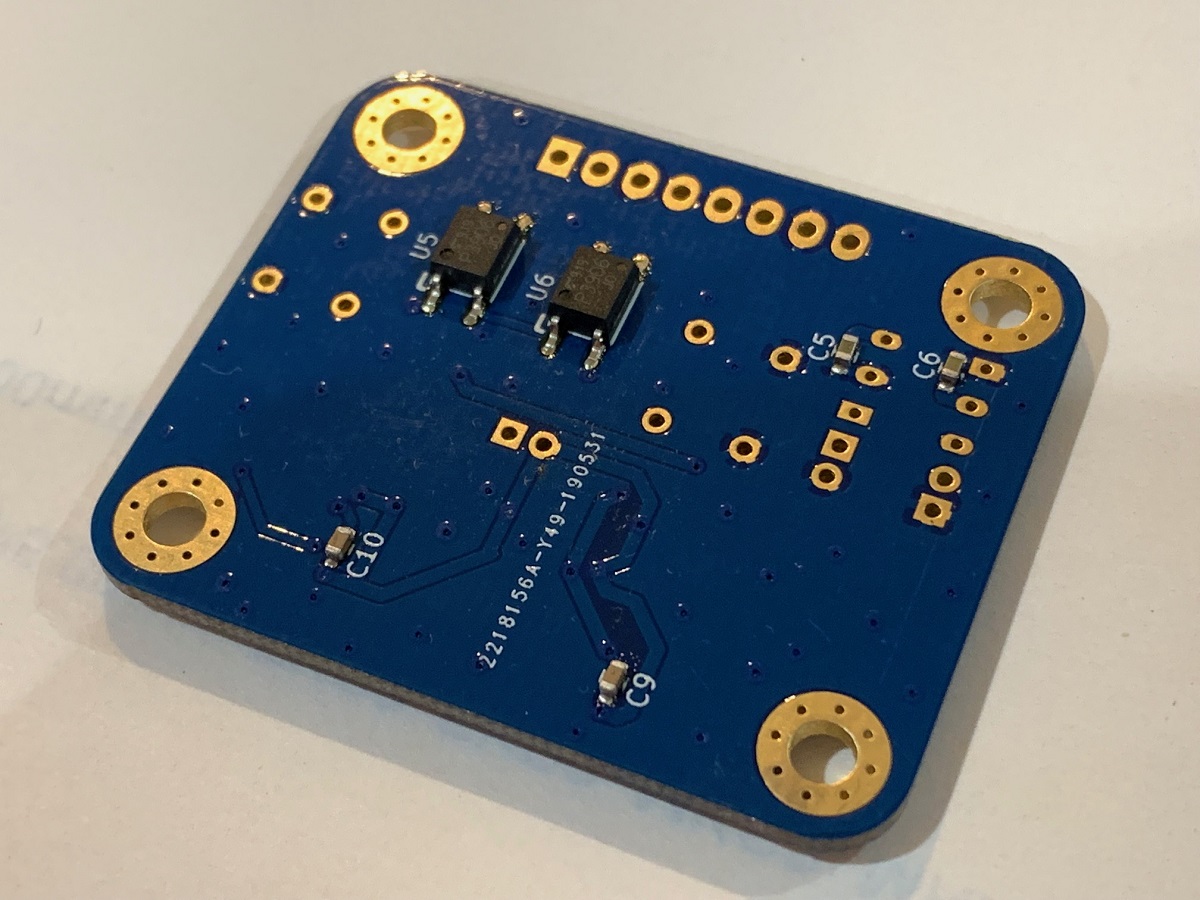

Build bottom side:
776416d1566279869-cheap-chips-opa1688-low-thd-muscle-amp-hpa-ssr-protect-05-jpg

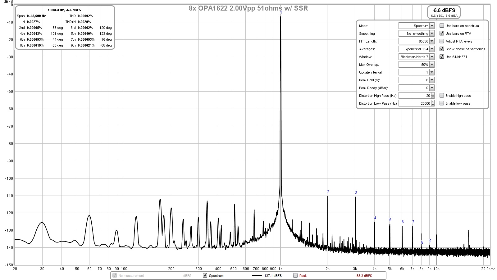

FFT showing harmionic distortion spectrum and THD without the SSR DC protection in place for 2Vpp into 51ohm load (9.2ppm THD):
776414d1566279616-cheap-chips-opa1688-low-thd-muscle-amp-8x-opa1622-2-00vpp-51ohms-ssr-jpg
FFT showing same with the SSR DC protection module in place (still 9.2ppm THD):
776415d1566279616-cheap-chips-opa1688-low-thd-muscle-amp-8x-opa1622-2-00vpp-51ohms-yes-ssr-jpg
The unit works reliably and quickly and will protect your headphones from a DC offset error that could blow them up.

Hmm....I didn't think to use this SSR HPA DC Protection board in a linestage preamp? But, I have notice some preamps have large DC offset when first powered up and shut down. Does this board have a few second delay before signal passes through and instant disconnect when powered off?
Founder of XSA-Labs
Joined 2012
Yes, it also has a startup delay of a few seconds. It’s adjustable with a resistor or capacitor value change on R22 and C11. Nominally 100k and 22uF so easier to change 100k resistor. The cap has to charge up in order to activate the gate to the MOSFET. I think the default delay is about 2.5 seconds. Since the RC delay circuit is tied across the positive and negative power rails, as soon the rails collapse, the gate to the MOSFET is turned off, shutting down the SSR instantly.

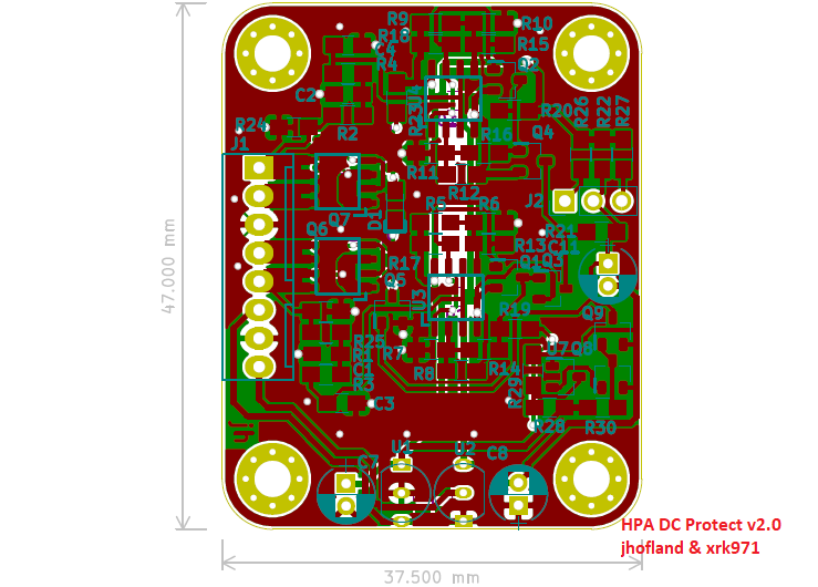

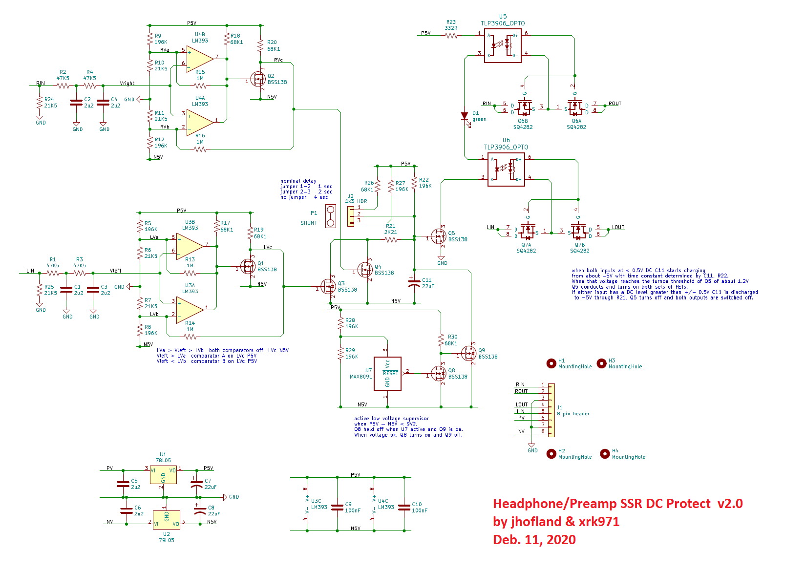

Jhofland just upgraded the circuit to have a smart voltage supervisor that monitors the +/-5v rails. If the difference in the rails falls below 9.5v, the supervisor will instantly shut down the SSR MOSFETs. This will ensure a clean and quick shutdown to further reduce the possibility of turn off thump. The layout has been revised to use 0805 SMT parts for easier DIY soldering in case we do not have enough interest to have a RTR production. Judging by the level of interest so far, I feel this will probably be the case. However, we may be able to assemble a few (less than 10) by hand for folks still interested in a RTR version. Thank you to Jhofland for a great design that only grew in size from 45mm to 47mm and incorporates the voltage supervisor and change to all 0805 parts!
:cheers:

Would this also work for the output of a line preamp?
It appears the comparators are set to work at 0.5v which, assuming a dc amplifying power amp would be disastrous.
And while many seem to be happy passing audio signal through mosfet switches, there is just no need for such a compromise at the output of a pre - a simple shunting relay is just great in that position.

Why would detection of DC at 0.5v be disastrous? There is a time constant so that a signal which persists at DC level longer than timescale of a 14Hz signal triggers the SSR relay to disconnect. The time constant is adjustable with the RC elements at the detection end.
This was only in the context of a line stage followed by a dc power amp. The speakers may see more than 10v dc before the 0.5v threshold is reached.
