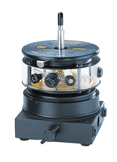

I know well the procedures to measure the power handling, I've done it many times, but the problem is that I'm developing an instruction video for building mechanical wave drivers out of old speaker parts, similar to this one by PASCO:
The idea is that people will be able build it themselves, and they don't need to find a magnet with specific dimensions, so they might be building it with different magnets and voice coil diameters, each will have its own power handling.
And all I need is a way to conservatively estimate the value for the protection fuse. Proposing a thermal test is completely overkill, the builders are not going to be experienced in this area.

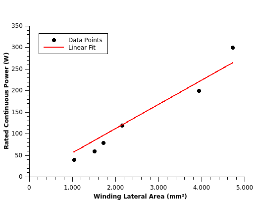

I think I found something that might be useful.
Checking some datasheets, in particular those of Visaton, which provide both voice coil diameter and winding height, I found an approximate linear correlation between continuous rated power and winding lateral area, as follows:
It looks off because I forced it to intersect at 0,0.
Obviously far from being something exact, but for a conservative estimate I think this is useful, using this and then halving the estimated power for safety, and choosing a fuse according to P=I²R

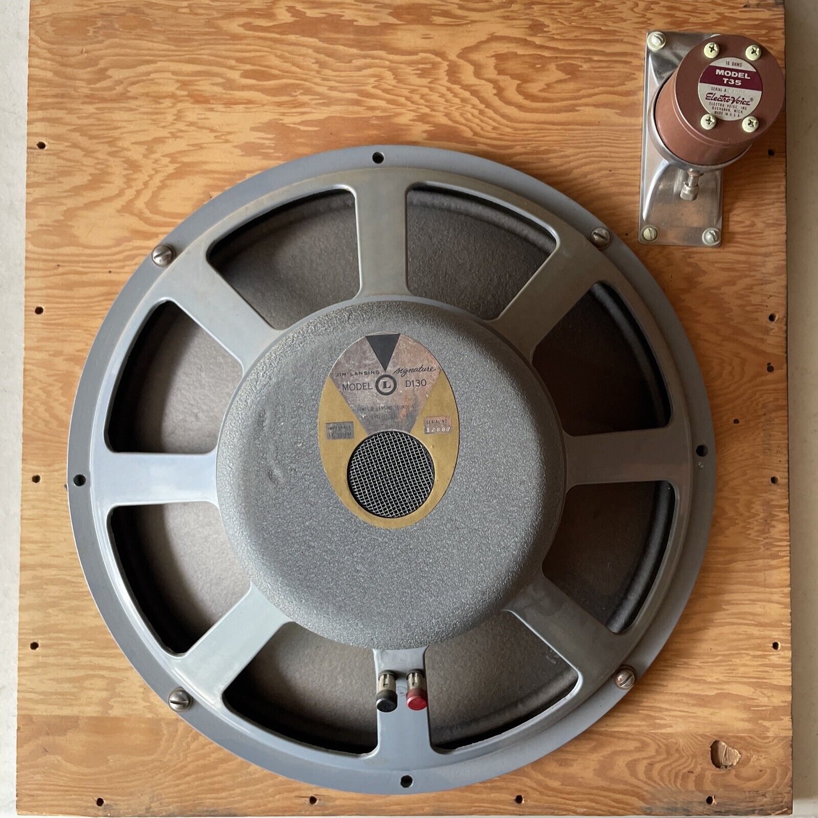

Vented pole pieces may have been new in 1948 when Jim Lansing (pre-JBL) used them on his D-130 15" speakers, but 75 years later it's not.
The way the venting is done can make a big difference in heat dissipation, improvements have been made since then..

Obviously, the fuse must be sized according to worst case, which is the high frequency one, where displacement is low and there's less convective cooling. So there needs to be a way to estimate, roughly and conservatively, the protection fuse just to prevent destroying it.
Not so obvious is a fuse conservative enough to protect the voice coil of a speaker will often burn up on transients that can easily be handled by it.
For instance, the tiny 5watt voice coil in the EV T35 in the photo above can take 50 watt peaks for 10milliseconds.
The PASCO mechanical wave driver uses a 1.0 A, 250 V fuse, about 250 watts.
A mechanical wave driver similar to the one by PASCO driven with sine waves would require a fuse with less than half the RMS rating of a typical voice coil to have a chance of protecting it.
