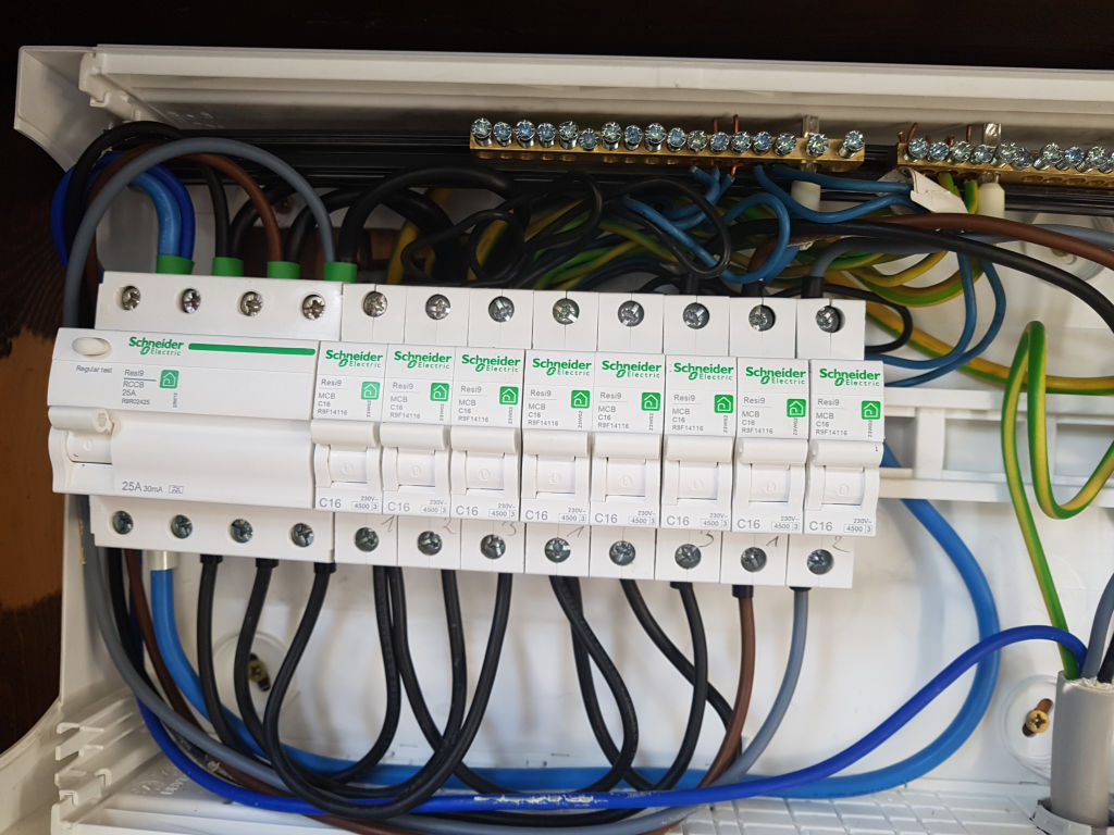

In my country mandatory to use local grounding point(s) as protecting earth.
It's 2m long stainless steel probe (one or many -connected together-, while grounding resistance doesn't reach 10R) knocked into the ground near electric cabinet.
The electric provider ensure 1-3 phase (black coloured) and one neutral (brown) line. The neutral line repeatedly grounded (every kilometre), the grounding resistance can not exceed 10R.
Obligatory connect incoming neutral to local protecting earth with thick (yellow-green coloured) wire.
In the house must apply phase, neutral and protecting earth wiring together.
Recommended to use residual-current device / ground fault circuit interrupter between the incoming phase/s/ and neutral an in-house phase/s/ and neutral.
https://en.wikipedia.org/wiki/Residual-current_device
This device unloaded, when phase/s/ and neutral current difference exceeds few ten (20-30) mA.
It's my incoming current breaker section. In the left is 30mA residual-current_device.

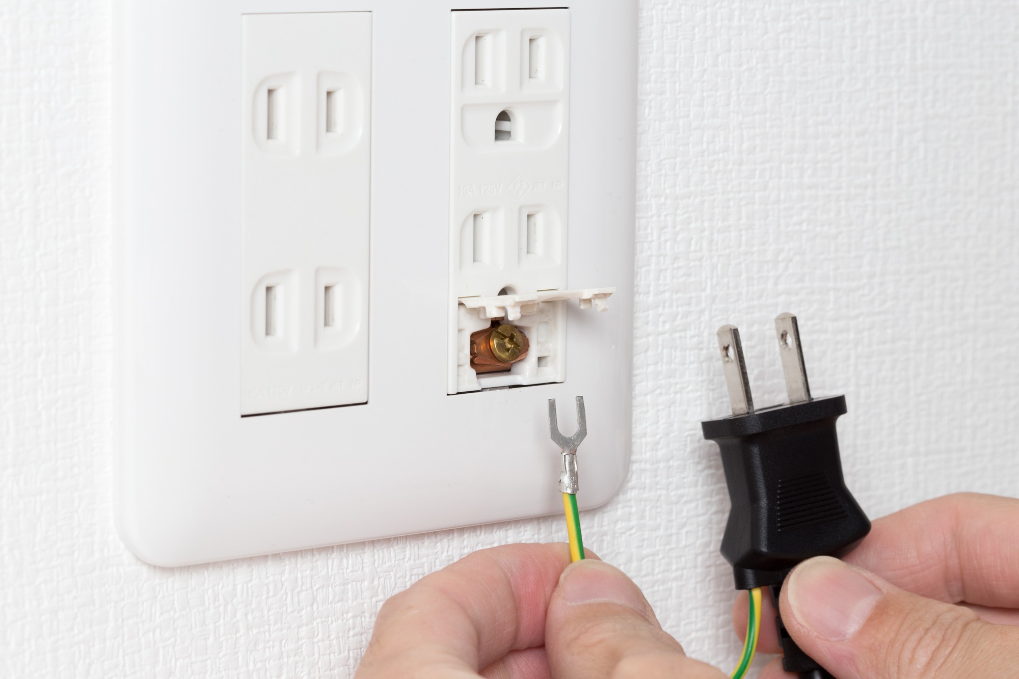

Interesting! Thanks.Not uncommon to find outlets like this one in Japan:
2 prong not earthed on the left,
3 prong with earth pin, top right,
2 prong with separate earth screw. .. no joke ...
