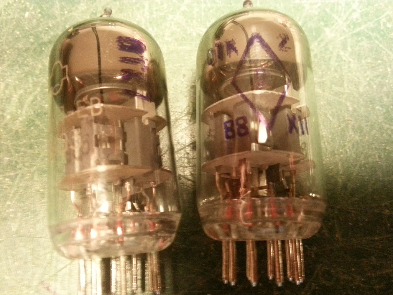

Someone knows how to recognize tubes that are military grade ?
this is what I know
EB = Long Life - 5000 Hours
ER = Long Life - 10000 Hours
K = Shock Resistant
VI = Military Equipment (but I don't know more)
I = ??? I don't Know
IR = High Durable
DR = 10000 - 20000 Hours
What means the OTK stamp ?
I'm sure there are other things to know about russian tubes
Someone has further info to share ?

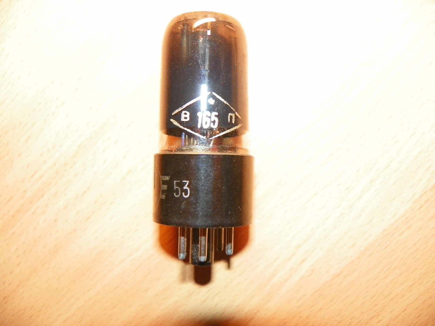

В165П ВП-military acceptance
1512 - 6П9
1515 - 6П6С, 6Ф6С, 6Ф6М1
1527 - 2Ц2С
1539 - 6Н1П
1556 - 6Н17Б
1557 - 6Х7Б
1559 - 6Н16Б
1564 - 6С3Б
1570 - 6Ж5Б
1571 - 6Ж10Б
1578 - 6Н8С
special series
OTK is a russian acronym for quality control check passed. I have read it is a good sign to see it on a tube.
RFT is not Russian. East Germany i believe.
dave
Yes. And a lot of "SIEMENS" Tubes were made by RFT and bought by Siemens...
OTK stands for Otdyel Tekhnicheskovo Kontrolya, "department of technical control" most of products in the Soviet Union carried this stamp. If an item has this stamp, it meets the minimum quality standards.
From the 1950's quality controllers where inserted in most Soviet industrial companies to test and check production, but not all companies had OTK controllers, and not every item leaving the factory was stamped.

E (russian E) - long life (5000h and more)
D (russian Д) - ultra long life (10000h and more)
V (russian B) - vibration proof, high reliability
I (russian И) - for impuls mode (high emission of catode)
K (russian K) - vibration proof
R (russian P) - vibration and radiation (nuclear reliability) proof
so 'EV' (rus EB) is 'long life' + 'vibration proof, high reliability' etc
also stamps:
ОТК - standard quality
ВП - military
ОС - ultra stable parameters
